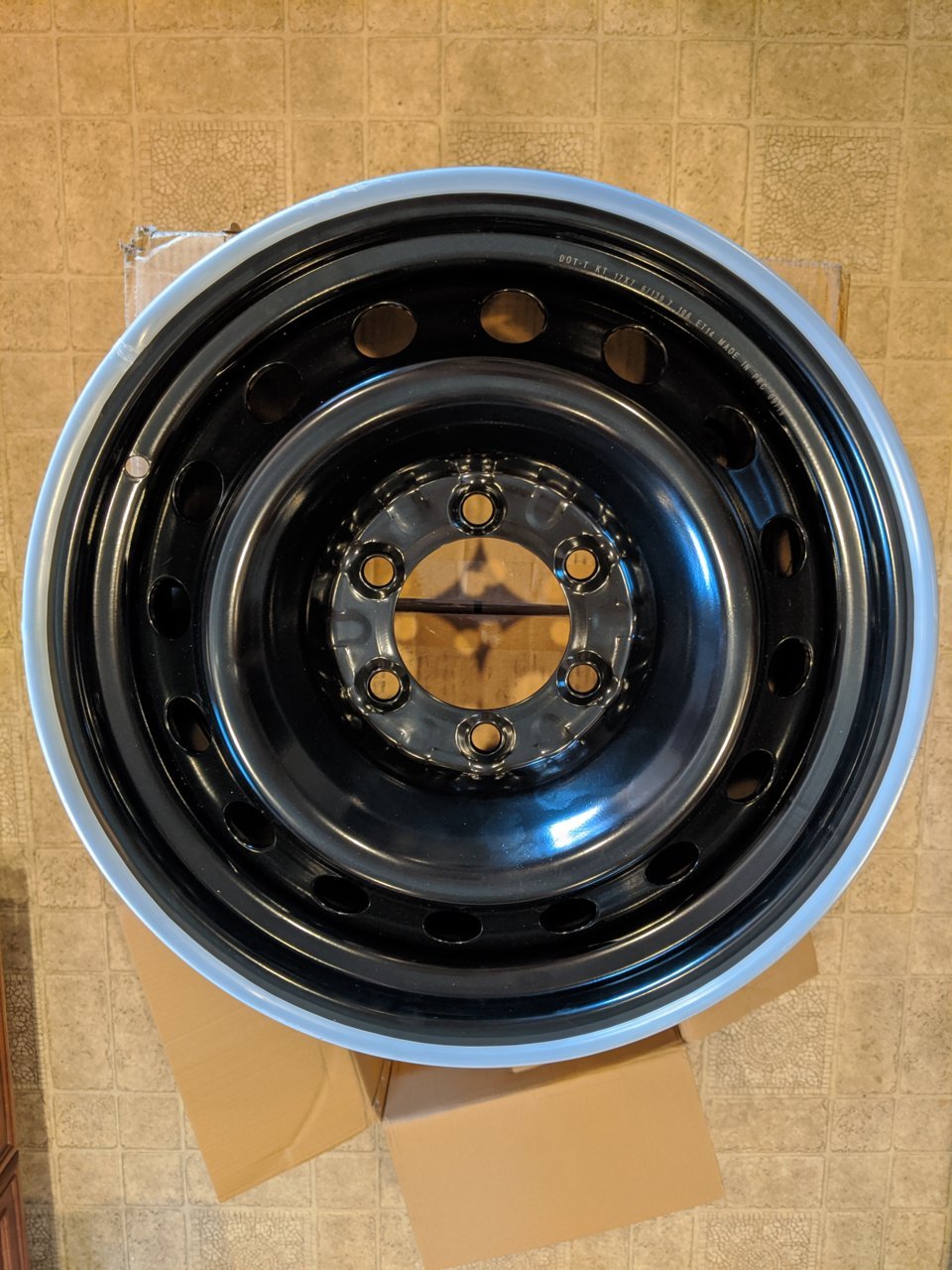

    Starting this project. It's not specifically camper related (but the camper makes it necessary) so i posted it in my general truck thread and decided to cross post it here.
    Camper, gear, armor...stock taco brakes are not cutting it on long/winding descents. The braking power is fine enough but I need more thermal capacity. So, 5th gen 4runner front brakes. Which means 17" rims. So, 5th gen 4 runner spare rims. I'm not happy about this as there are no 17" rims that match the width and offset of the factory 16's. The 17" Tacoma sport rims match the offset and are only .5" wider but they are, IMO ugly and a last resort. These 4runner rims are the right width but the offset is off by 15mm. So, I'm sure I'll have all kinds of rubbing now. If it's awful, I can get a set of 17" sport rims but I wanted to try these first since they look better to me. Going to take them to my powdercoater for some color therapy. Stay tuned!

    So, real question: do I get new TPMS sensors for the steel wheels (the 16" aluminum wheel sensors don't work on larger 17" steel wheels)? Or do I have my current TPMS sensors removed from my existing wheels and put them in a pressurized tube and store them somewhere on the truck? I've read this works and keeps your TPMS light from coming on. I include my spare tire in my rotation scheme as I like to wear them all out at the same time. I'm a nerd that way. And, the spare does not have a sensor anyway so I'm not really getting the full benefit of the sensors except once every 5 rotations. I don't like the idea of messing with the pressurized tube of sensors but I also don't want to spend money on new sensors. Thoughts?

    long time lurker, first time poster. you can transfer tpms from alloy to steel, but not vice versa (well you can, but you have to flip it, and the sensor wont sit against the middle of the rim, but will be kinda sticking out and can get damaged when putting the tire on). Also, if you go the pressurized tube route, couldnt you only pressurize it very low (~5psi) then reset the monitor?

    Thanks for chiming in! My info is old so it may be of no use. I just thought it wouldn't work. As far as the pressurized tube goes, I'm not sure how the tpms reset works...never messed with it. I imagine it has a lower limit programmed that can't be changed for safety. But a PVC tube with 20psi in it is no big deal, really...I guess. I'm heading to the tire shop shortly to get my tires on order so I'm glad I have your info to help in the conversation!
