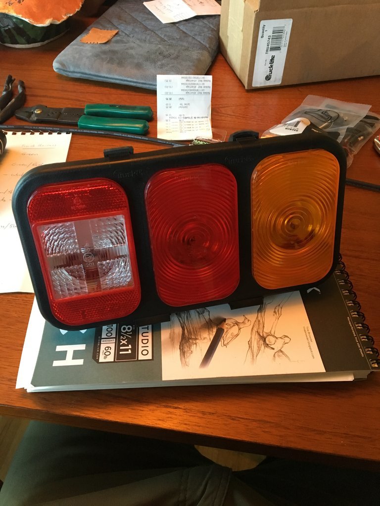

    Thanks a bunch man, that gives a decent visual how high mine will sit since I made the canopy 36" tall. I think I have a similar set of tail lights coming, going to swap it for something LED like this
    https://www.amazon.com/gp/product/B06ZY74BYR/ref=ox_sc_mini_detail?ie=UTF8&psc=1&smid=ATVPDKIKX0DER
    Super excited to see what you come up with, thats a huge amount of room to work with now vs the factory bed

    Yeah, not sure if these taillights will be the final solution but I have them so they'll work to get me rolling again.

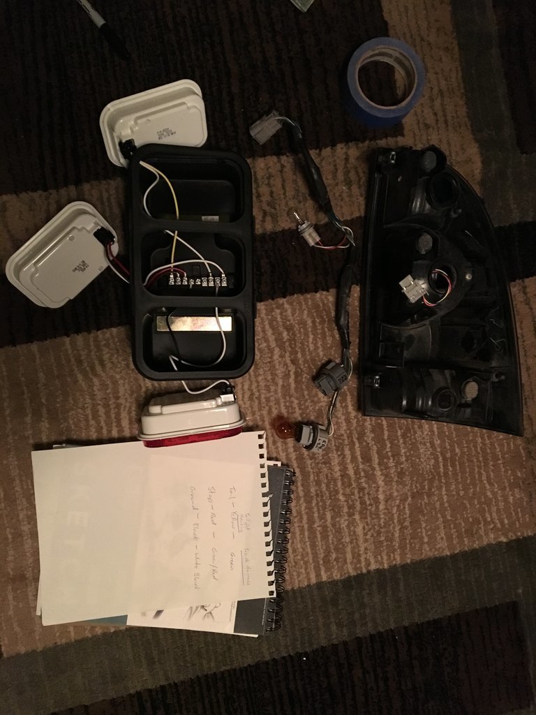

    Getting there:
    Figuring out all of the wiring for the taillights. Luckily, the LED stop/brake light in the factory housing had wire labels printed on the LED board. I pulled open the secondary connector (little pigtail sticking out of the middle hole on the factory taillight housing) and was able to track the wire color changes back to the main harness. Now I just need to strip the wires, put little tiny ring terminals on them and screw them to the right terminals in the UTE taillights (also nicely labeled).

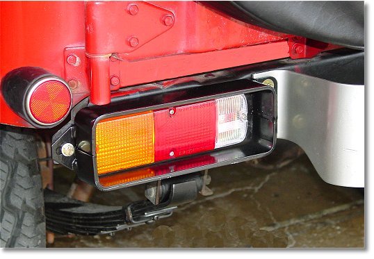

    Shoot, that's a great idea! I'll probably wire the ones I have just to get me rolling but the FJ ones may be a nice replacement. I also like that they appear to be much lower profile than the ones I have. Thanks!

    I have always liked the look of them myself. I believe you can get LED directly fit replacement ones for them too. I plan on running the mom my expo trailer when I finish it up.

    Nice! I had an FJ40 and the taillights were kinda cool on that thing. I like the round lights from the earlier FJs too but more visibility isn't a bad thing.

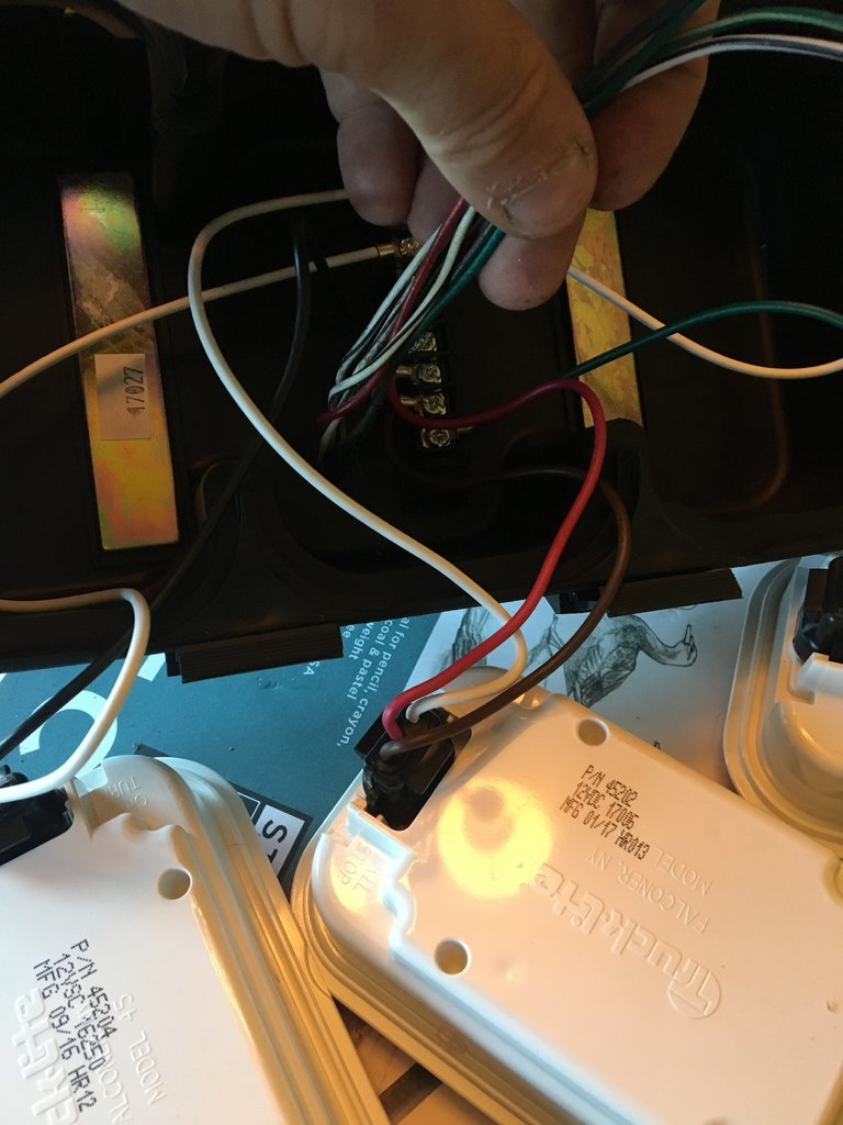

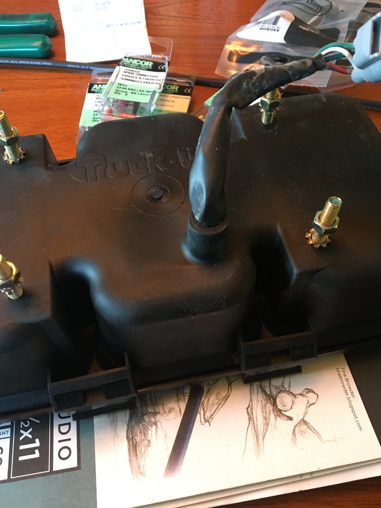

    Taillight wiring temporarily done!
    I pulled the wiring off the back of the OEM taillight. It's easy to do.
    Write down all of your wire colors and functions!
    Once you're sure you know what's going on, clip off all of the bulbs.
    Feed all 7 wires in through the back of the housing.
    Now, hook all the wires to the right, other wires...
    Yes, I know this isn't optimized and it's not supposed to be. I left all of the wiring as long as possible so I can tweak and optimize based on my bumper and how I mount everything. Also, I may switch taillights at some point. Anyway, the point is they work for now and I'll dial it when I'm more sure of all of the variables.

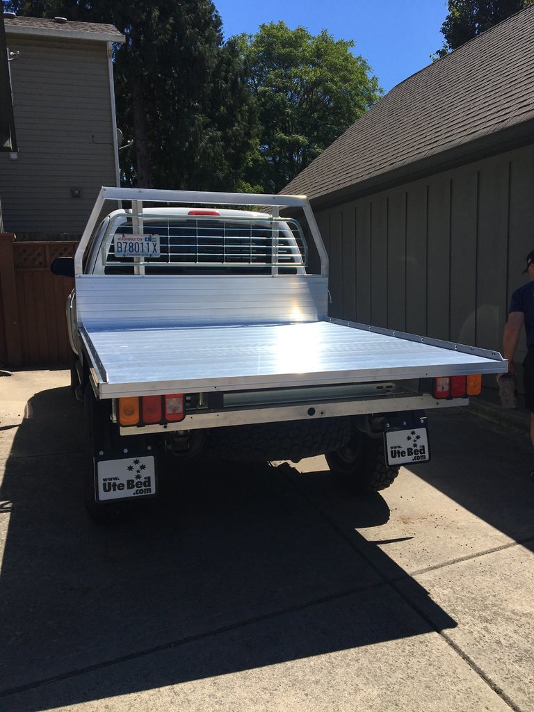

    Temporary 'bumper' and maiden voyage!
    Used a piece of 2.5" angle aluminum that I had laying around to make a quick and dirty light holder. Didn't feel like spending the time to do a license plate brakcket so I zip-tied it to the headboard. I'll get it all dialed in real nice when I get my bumper designed and built.
    Haven't decided whether or not I'm going to put the drop sides and tailgate on it. It's pretty easy so I guess I should try it out.
    Took it out for a quick drive. On the road is seemed pretty quiet. Filling up the tank is a compromise for sure. You can't leave the pump sitting in the filler like a regular tank. You have to hold it the whole time. And my 34 gallon tank doesn't help that situation. Haha. Also, it still overfills like normal. I'll keep messing with the various lines to try to reduce the issue but I think it's more to do with the design of the tank itself and how fuel flows into it more than the actual vent lines. I could be wrong...
