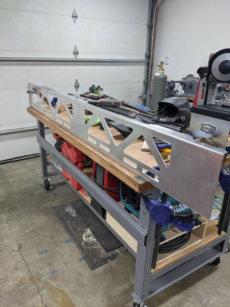

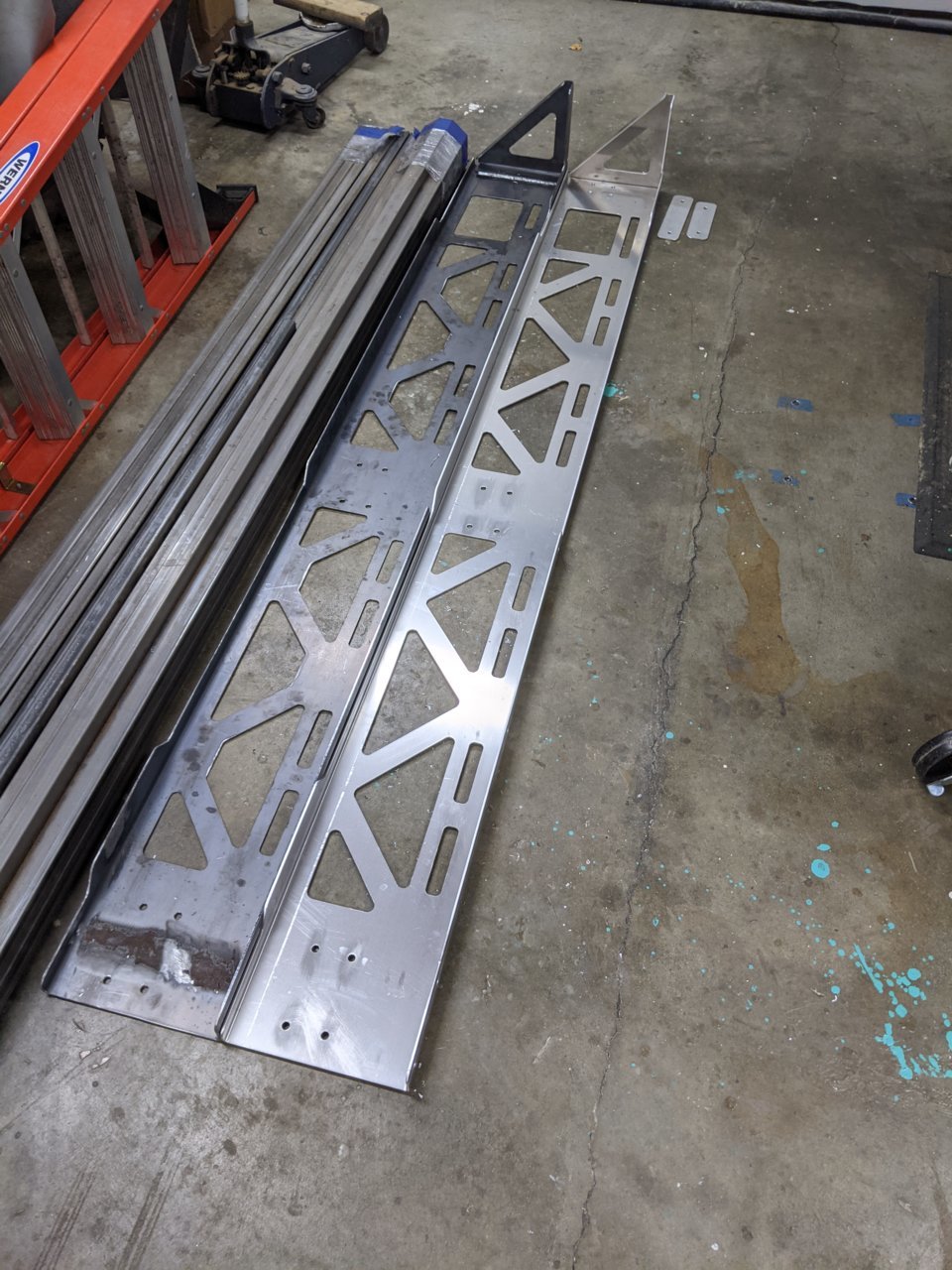

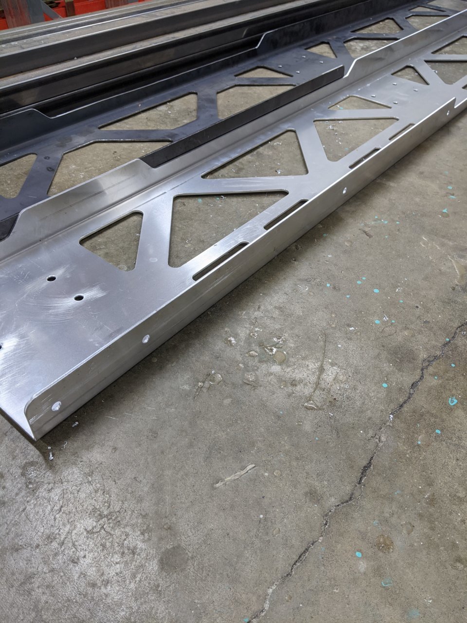

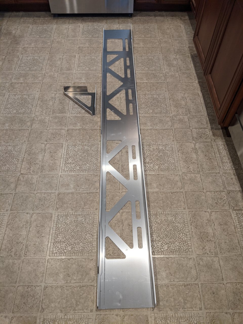

    New awning mount parts are in the house!
    As one might imagine, these weigh nothing. I probably saved 20lbs or so. Totally worth it. Made a few tweaks that cut weight and simplify assembly as well so that's a nice bonus.
    It's supposed to rain solid for the next 10 days so that's fun. I'll de burr this and get all of my holes transferred then wait for a reasonably dry spot to test fit and finish up the rack cross bars.
    Slashaar, SoCalTbird, Spintly and 7 others like this.

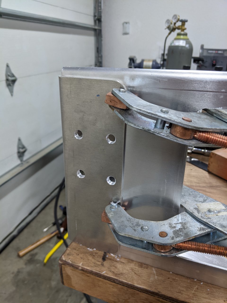

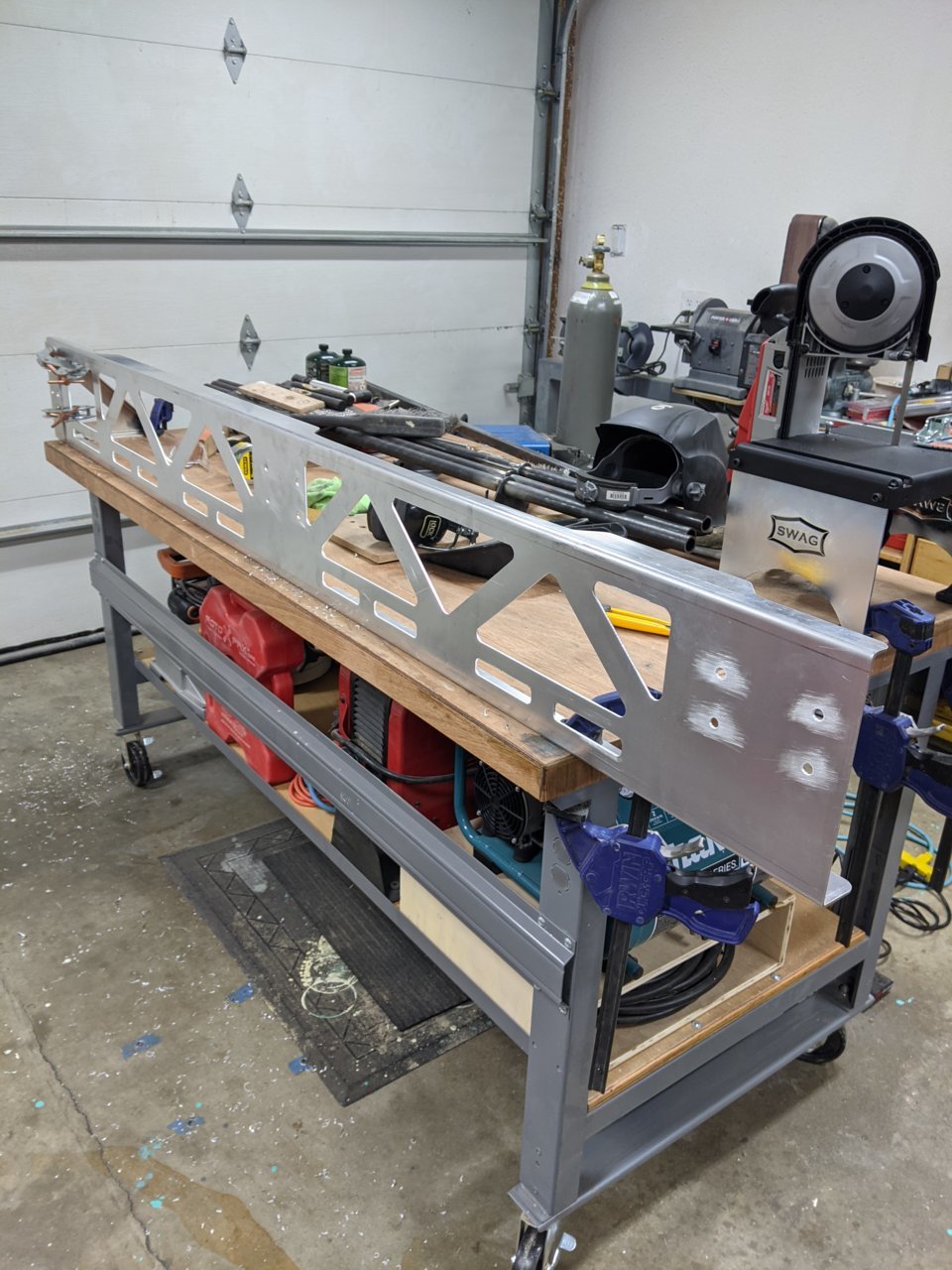

    Finally got out into the garage again after over a month off.

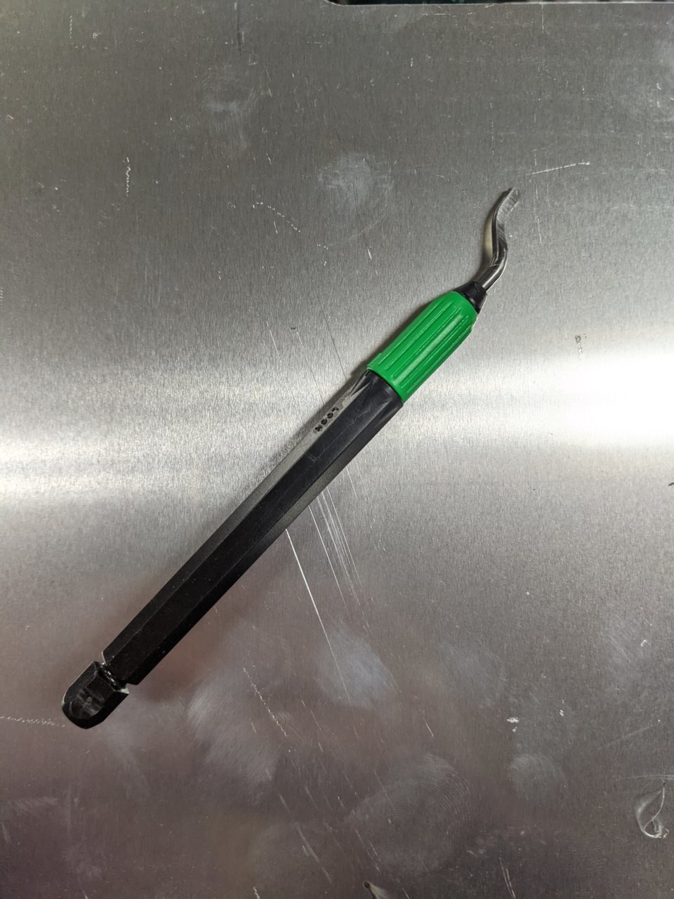

    Deburred all of the edges. They're pretty sharp after laser cutting.
    After seeing the pros in the shop at work using deburring tools like this, I decided to get a set. As with most things, when a pro makes something look easy it's because they've done it a lot. I'm getting the feel for the steel tool but I'm pretty sure I make more burrs in aluminum than I remove. Not surprised as aluminum is softer and stickier.

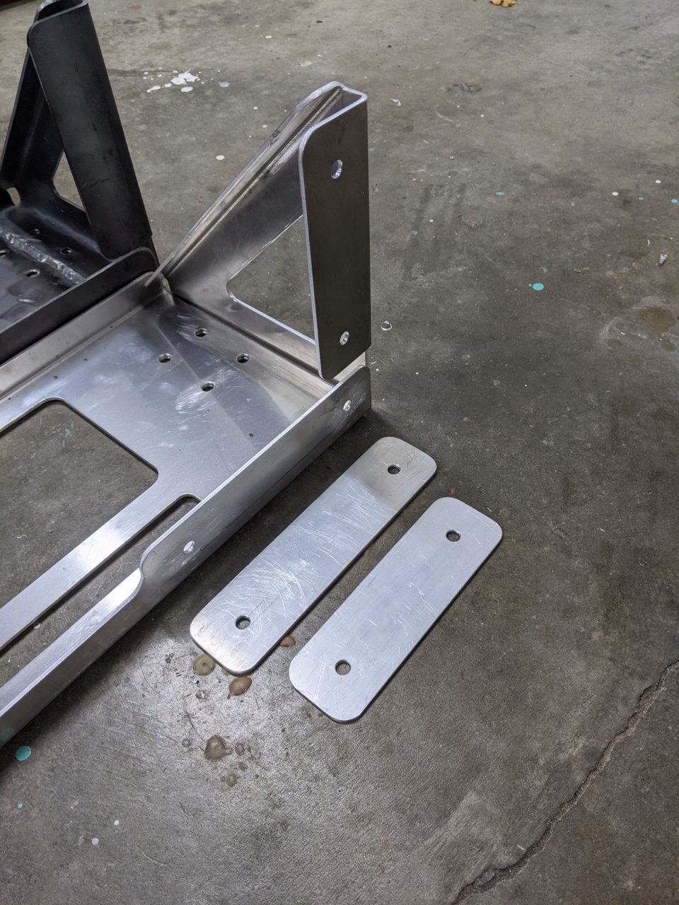

    Transferred all of the holes for the awning. Fingers crossed it all lines up. I made a quick template from the steel unit rather than wrestling with the awning.
    A little dry weather and some motivation will see this and the roof rack cross bars ready for powdercoat. Hoping to get this project wrapped up in January but final install will require a couple of days of dry weather for the sealant to properly cure. Don't want any leaks into my kitchen box or rear storage locker.

    '13 4x4 AC TRD OR
    Now I have a shiny and much lighter version of a thing I already made. :der:
    All mounting holes and spacer plates are ready to go. The only thing left is to get the roof crossbar mounts finished that interface with this awning mount. That requires fitting it all up on the truck. I may get the awning mount powder coated now so when I do get dry weather to fit it all up, I can permanently mount the awning mount when I start work on the crossbars.

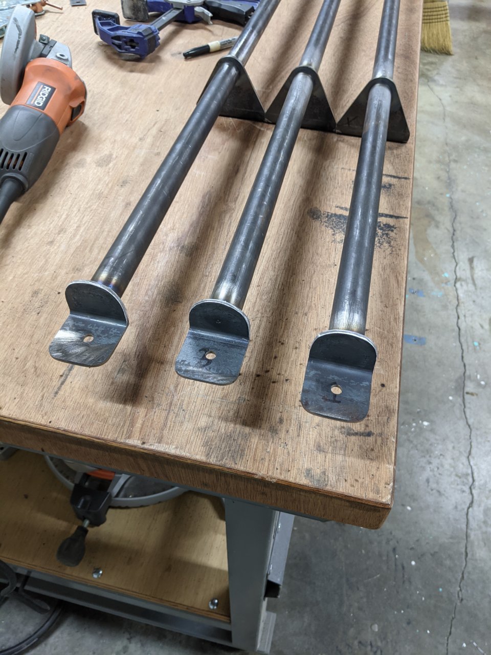

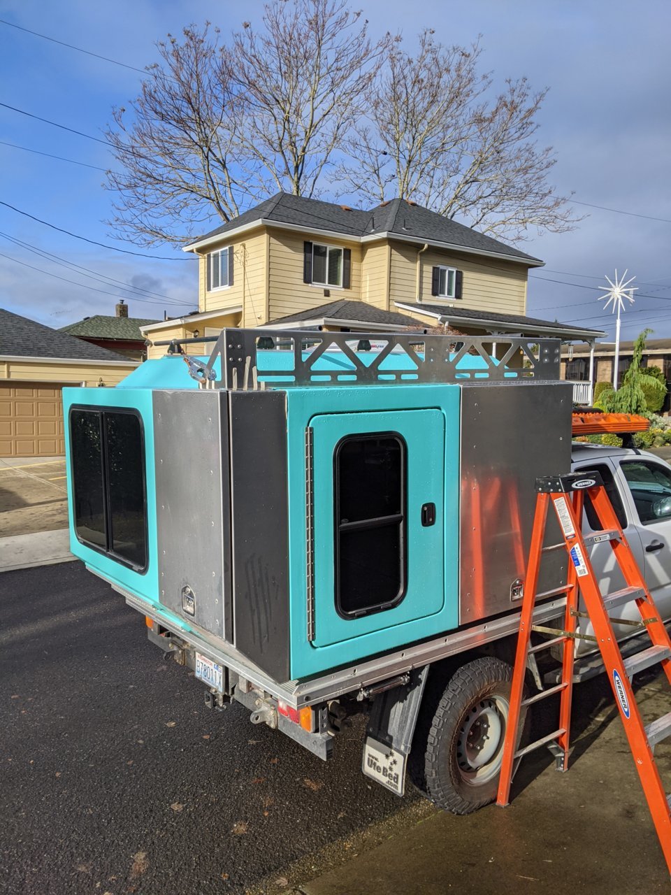

    Vancouver, WA
    '13 4x4 AC TRD OR

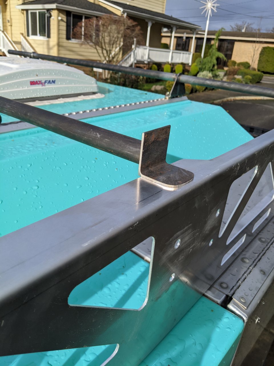

    Stroke of incredible luck! No rain today! Well, not until late this afternoon. It was supposed to rain all day up until I went to bed. Woke up to partly sunny skies and no rain. Crazy.
    Mocked everything up on the truck.
    Mocked up the end brackets for the crossbars and marked them for welding.
    Drill a hole in the center. Weld in place and grind profile down to something approximating a smooth radius. And just like that, everything is ready for powdercoat!
    Last item to think about before powdercoat. The 270 awning has a strap on the end to tie back to a bracket to keep it open and taught. I don't have a specific provision for that at this point. I may just drill a 1/4" hole in the back left upright if the roof rack cross bar so I can throw in a stainless eye bolt that I could clip a carabineer to for the awning. I'll think on that today and make a decision before the end of the day. But right now, I need to take advantage of the dryness and go for a run.
