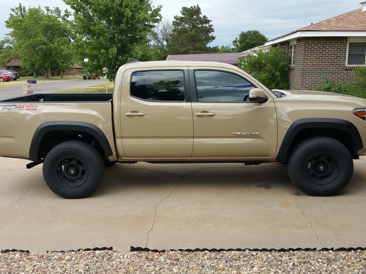

    Got my new rims installed, love it so far. Looking to level the front out, will be leaving the rear stock. As of right now the truck is stock besides the rims with are 16x8's with stock tires at 265/70/16.
    I measured the front and back this evening and got 5.5 gap from wheel top to fender in the front and 6.75 in the back. making about a 1.25 inch difference, to be leveled.
    I do not off road besides the occasional trip across a pasture during deer season. This is my daily driver.

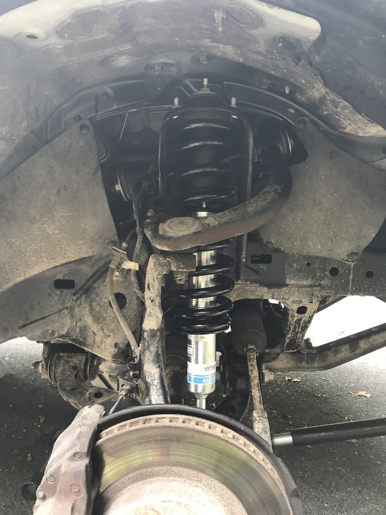

    @Truc577 you can kinda see in this pic how many threads I've got. It's like 1/2" above the nut.

    Ok thanks a bunch, I ordered a "street rays" brand and the sales person says there is enough to get the nut on but I was skeptical. The spacer is 1/2" thick looks like they provide thinner nuts. It may work if there is a 1/2" of threads above the nut. Guess I will get out the micrometer and check it out before I start. I would look at my own but its not ready for pick up from the dealer yet.
