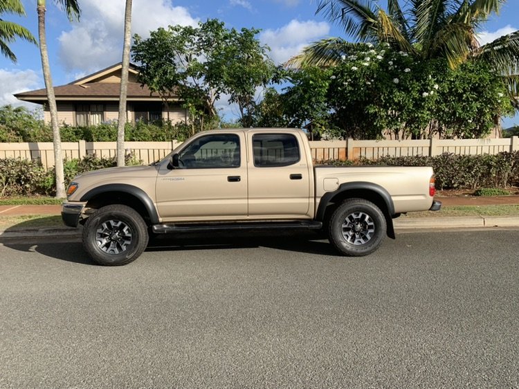

    I just did the cheap top plate spacers on my son's truck. The front now sits 1" higher than the rear. I might do shackles in the rear to even it out?
