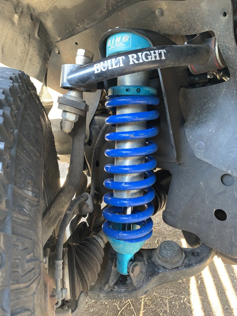

    What up with your spindle? That looks bent if you compare it to the angle on mine. Is that just from the wheel being turned?

    How does it ride for you. Is it good off-roading. Also, if I got that setup can I jump my truck a little.

    You can jump a stock truck, so I'm not really sure what you mean by that.
    But it rides fantastic. And yes, it does great off road too. $2000+ worth of off-road suspension damn well better!
    But I didn't get this setup for jumping. I'm more of a trail runner, mild rock crawler. I wanted something with more than stock travel. This fit the bill.
    As @Squeaky Penguin said, if you want to mob it in the desert and jump it, go long travel from the start, and def get resi shocks.

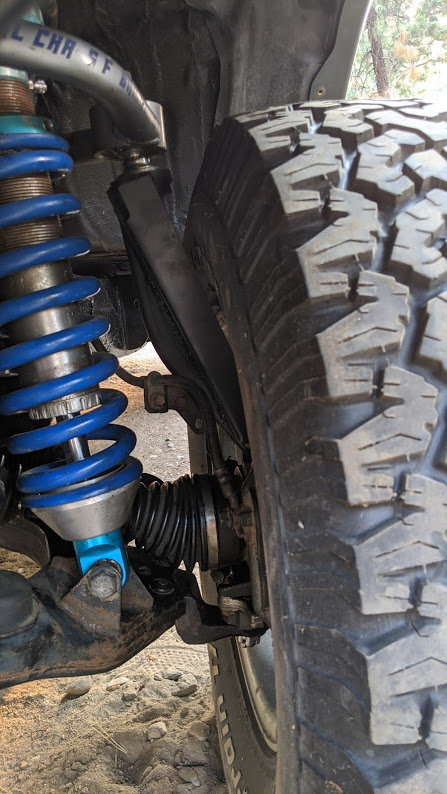

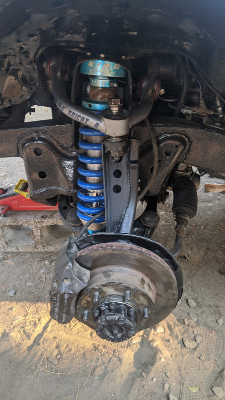

    My Kings with TC uppers and Spindle gussets.

    You have a direct replacement coilovers those ain’t extended it doesn’t look like?
  13. Feb 26, 2021 at 10:31 AM
    Kwikvette
    Feb 27, 2019
    #284735
    82,016
    Fresno County
    4 run, 2 don't
    The difference is an internal bushing/spacer; based on the picture posted, there's no way you would be able to tell the difference.
    Plus, direct replacements are available in both regular and extended as they are the same coilover sans the above stated.
