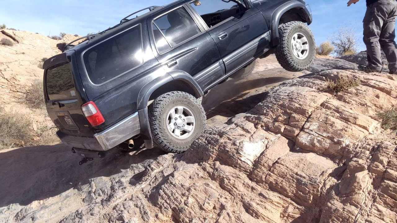

    Kings aren't all that long to cause issues with the factory upper control arm, or better yet, the ball joint -
    That's me with factory UCAs and King ext coilovers. Tons of other people have run the same setup without issue.
