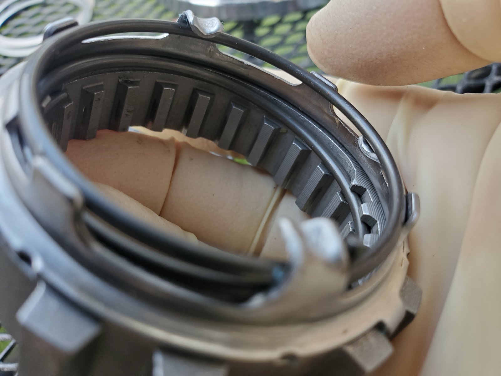

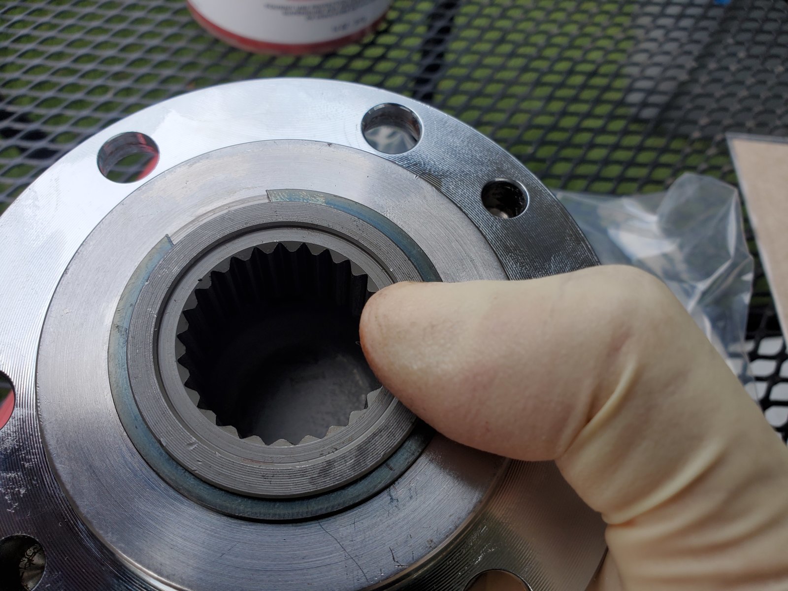

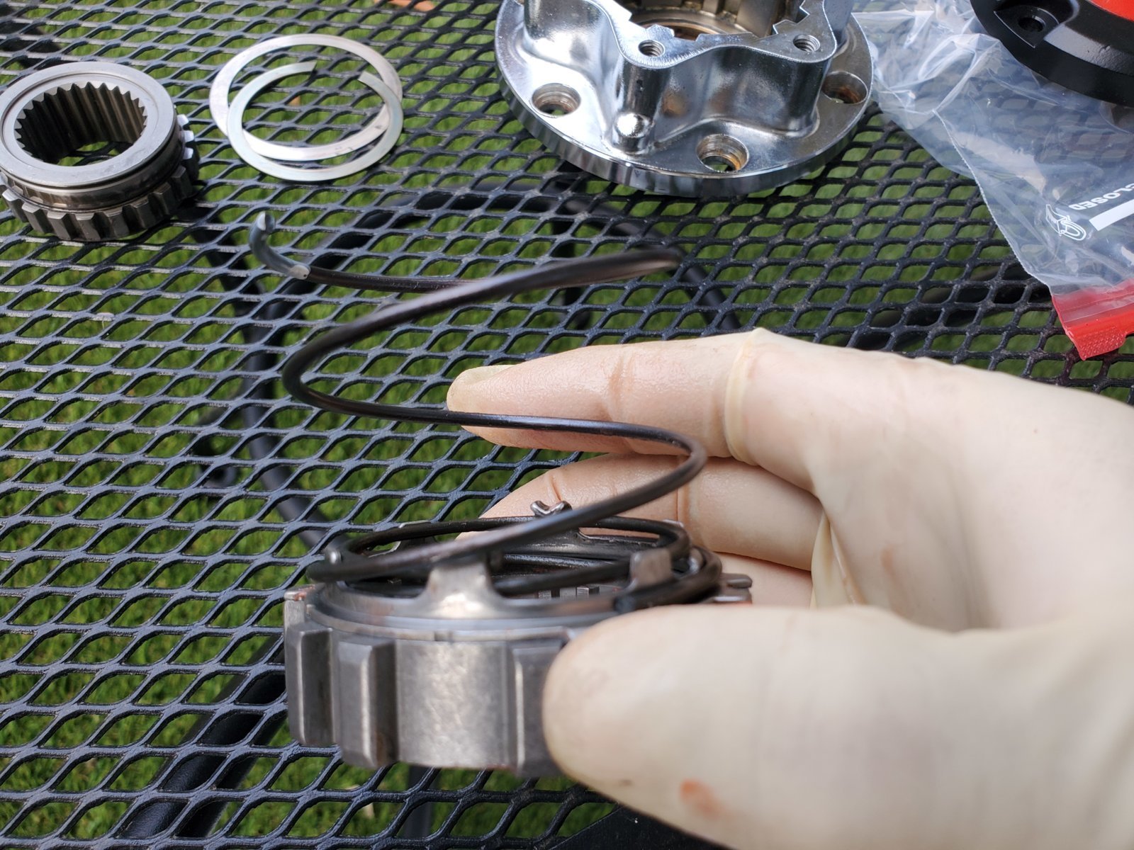

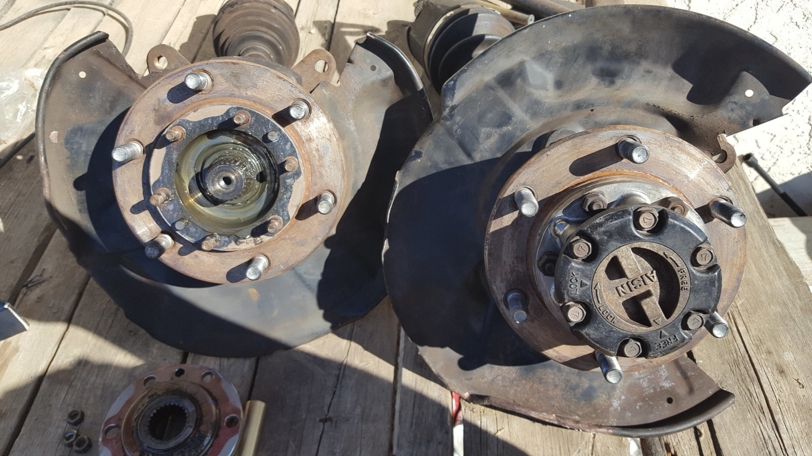

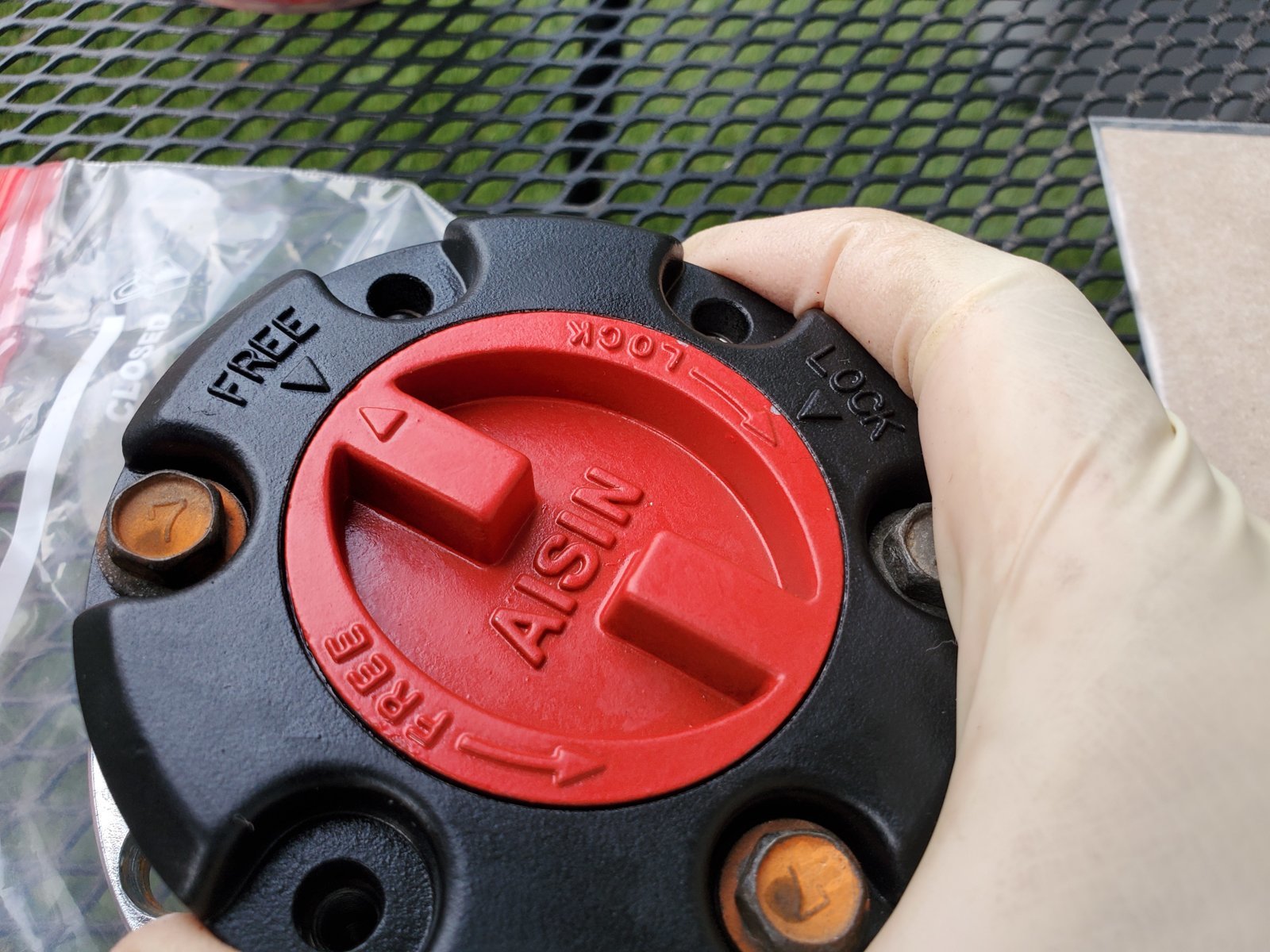

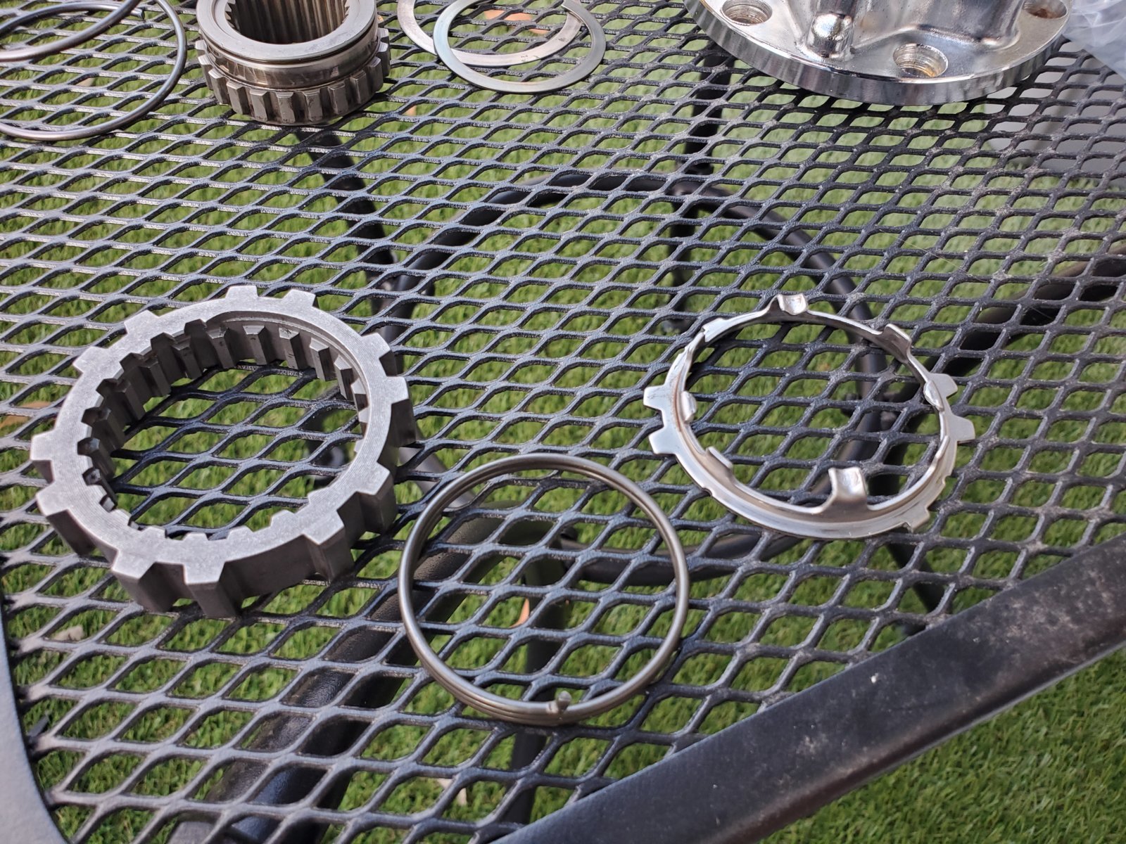

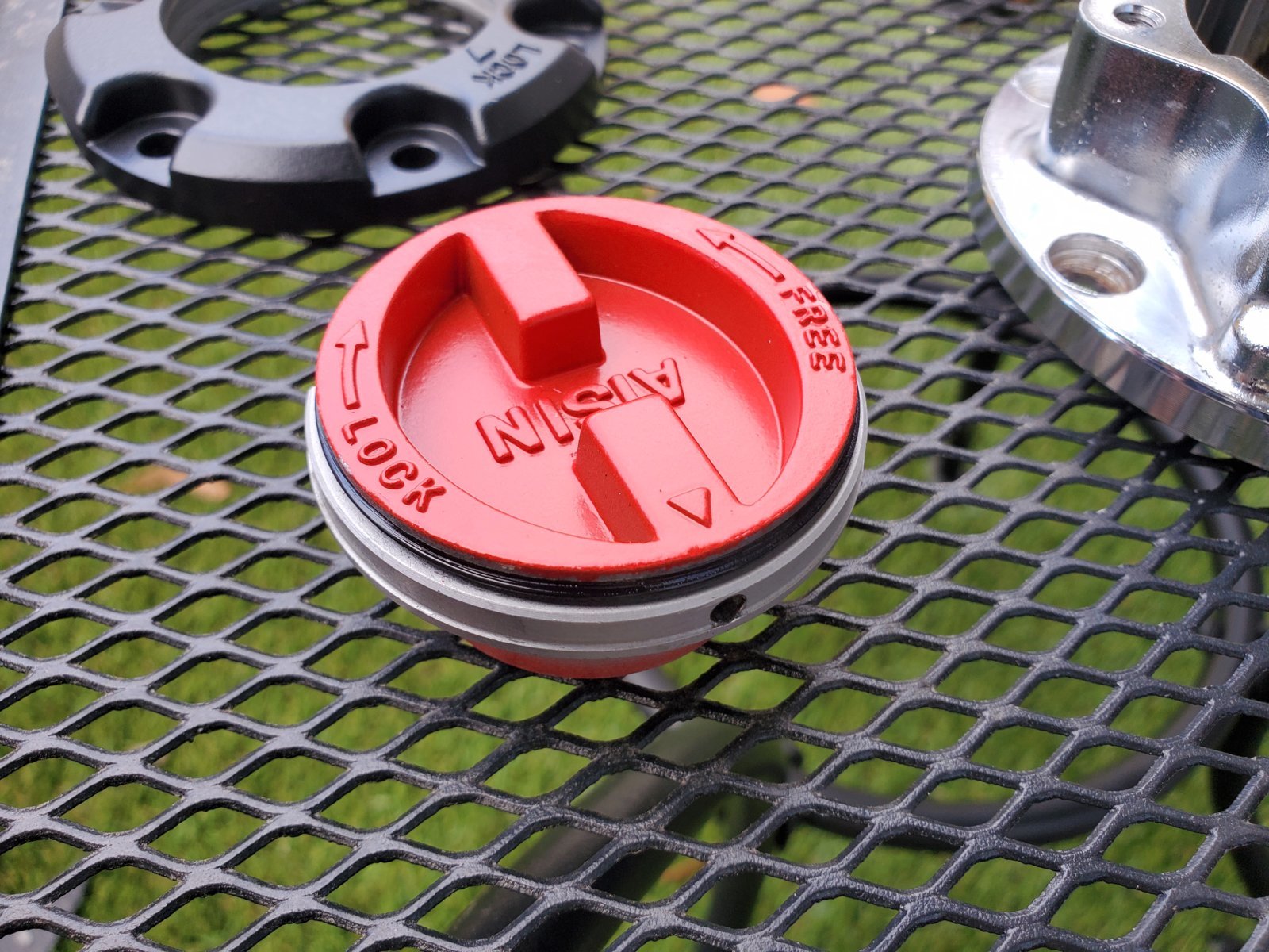

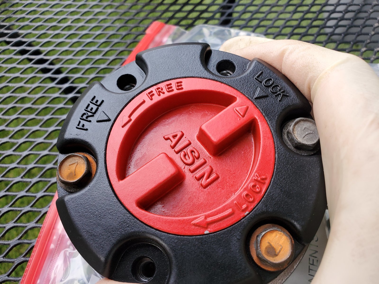

    Ignore the red color, they're Tacoma hubs that I simply painted to match the old Pick Ups

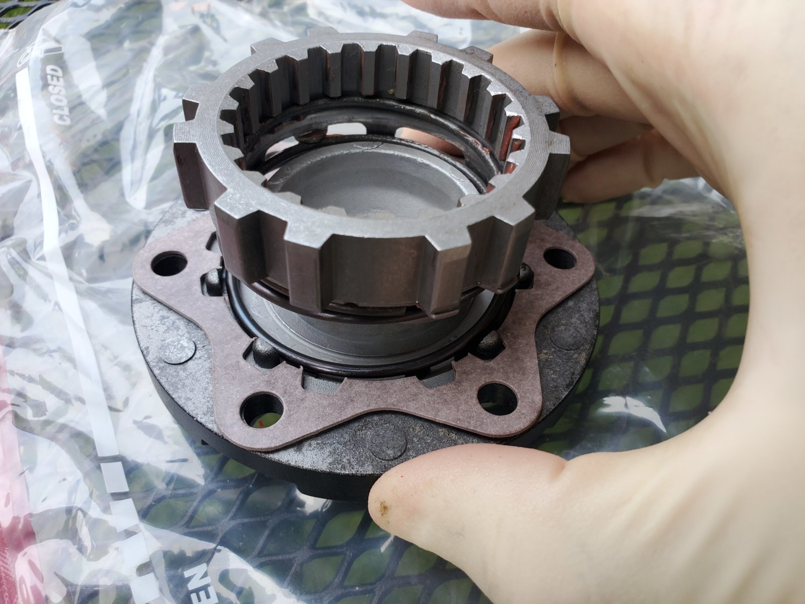

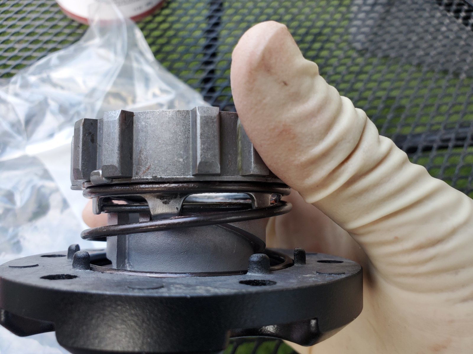

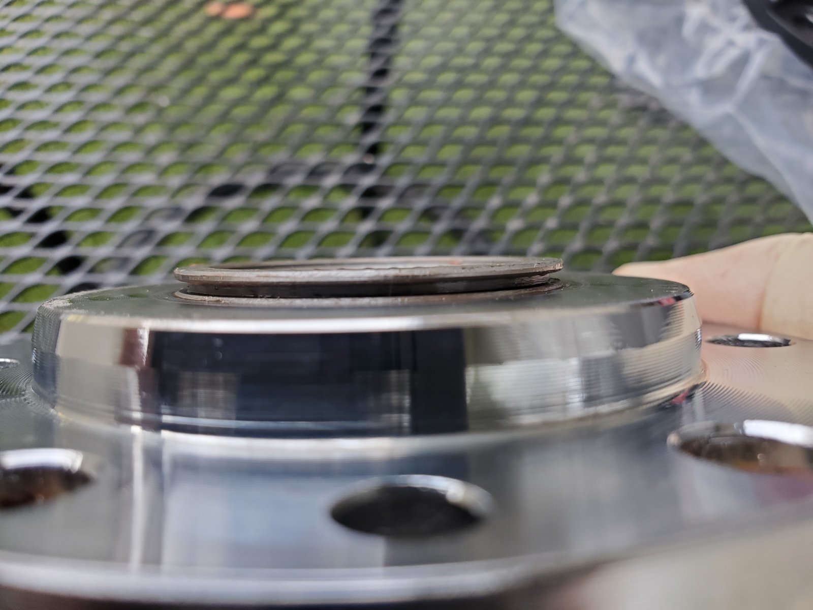

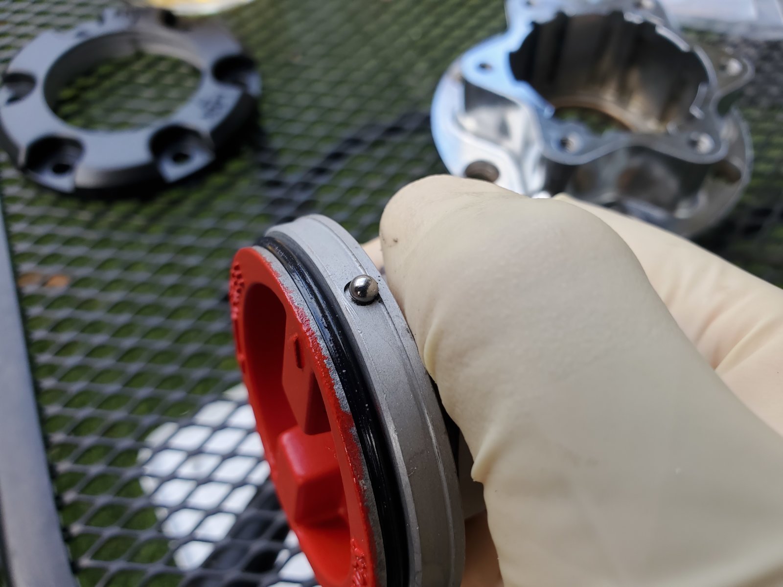

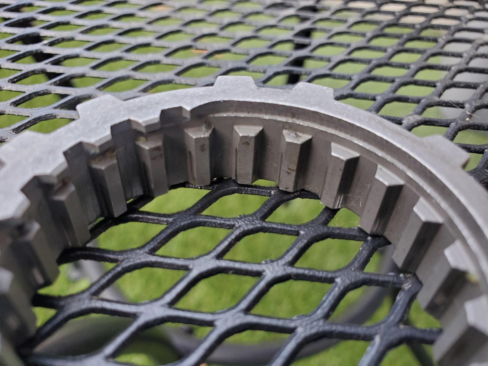

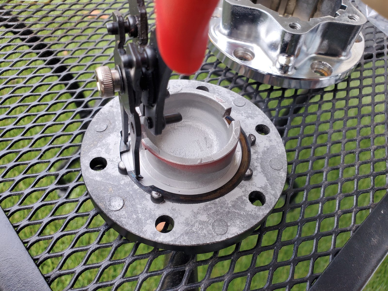

    Keep in mind that this instruction below is *not necessary* as your hub was pulled out as an assembly and not taken apart as shown.
    Doing this for educational purposes but if you do disassemble for a rebuild, you'll want a new o ring, gaskets, maybe even a new spring or two along with the ball bearing in case you lose one or two
    Start with your new o ring on the dial; sil glyde on the ring is your friend here
    Little detent spring; I had one that was broken but you can buy these little kits with replacement parts I think from Yotashop or some other vendor online
    I used redline grease on it cause metal on metal

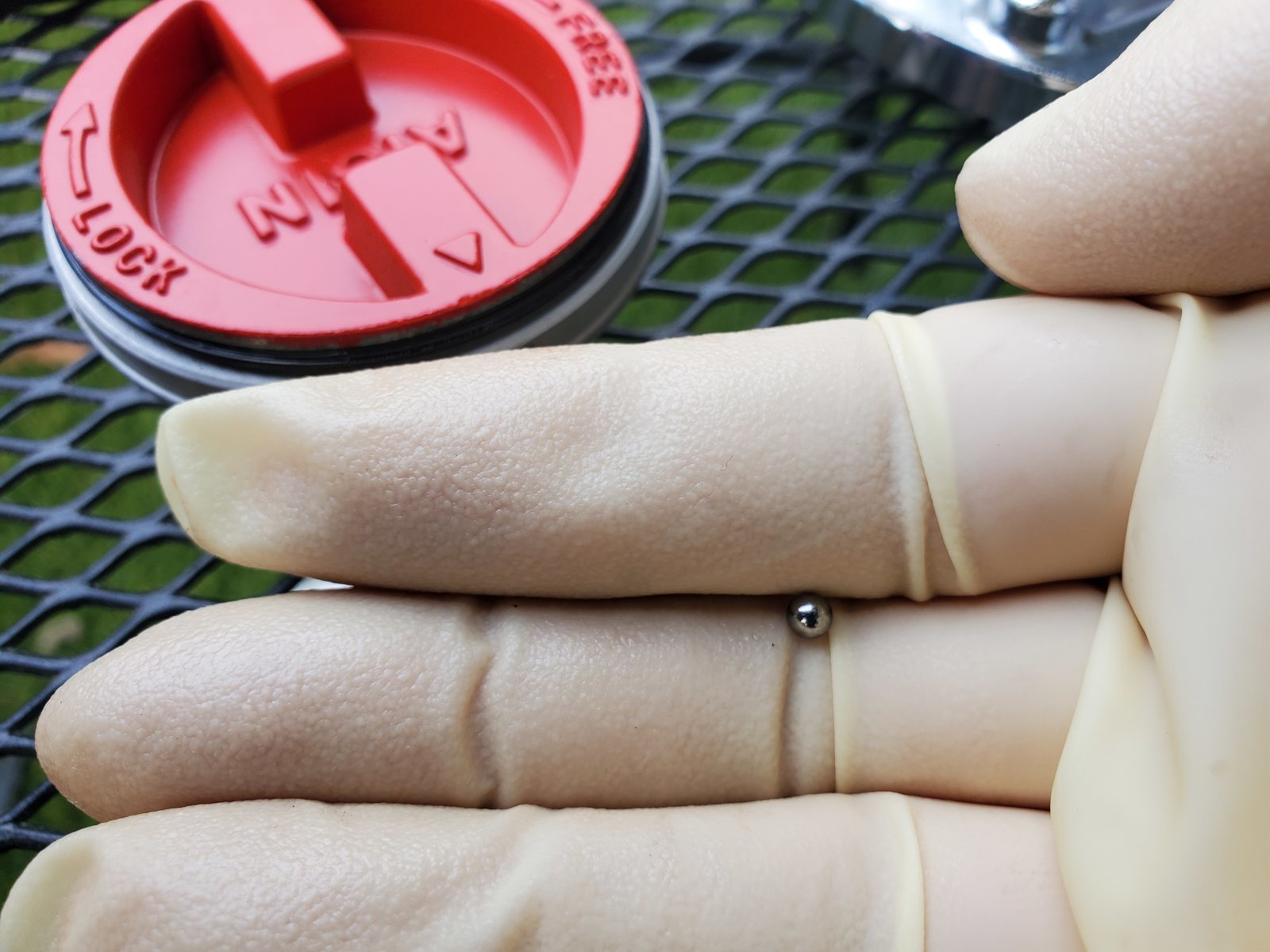

    The little ball bearing
    This is what you 'feel' when it engages/disengages on the hub dial

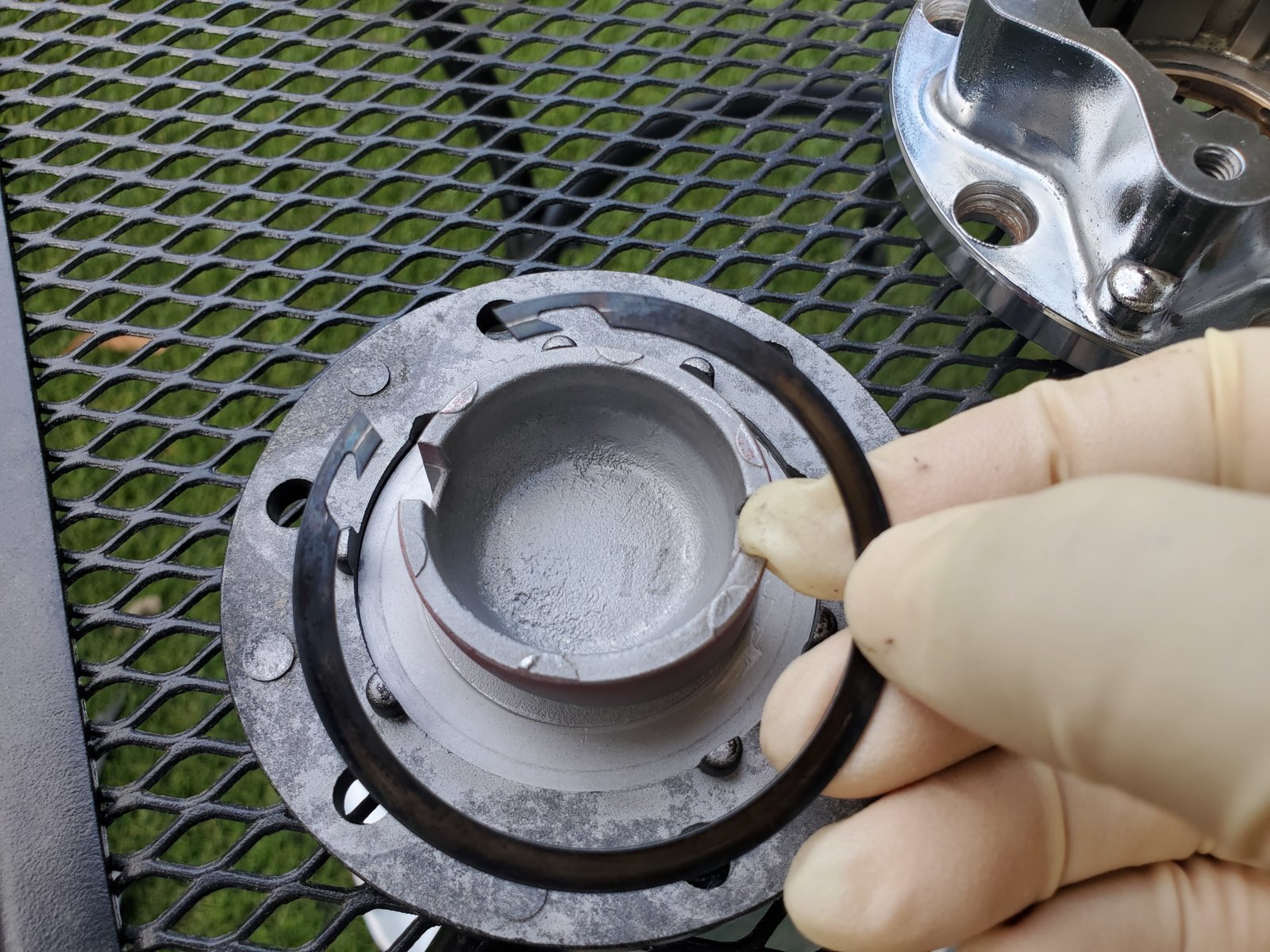

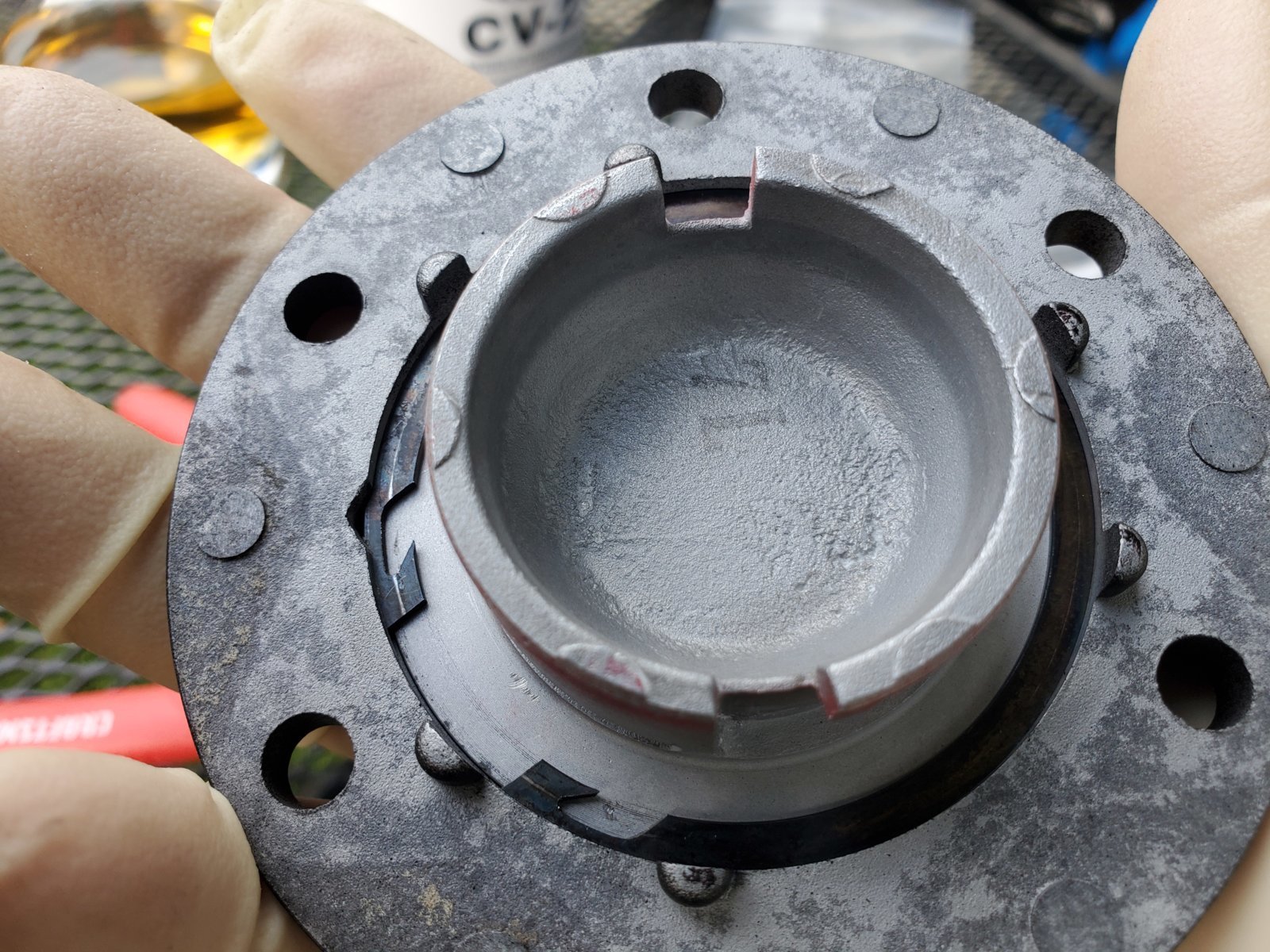

    Dial going into the ring; take note of this little notch here for the detent spring and ball to go into
    Self-explanatory

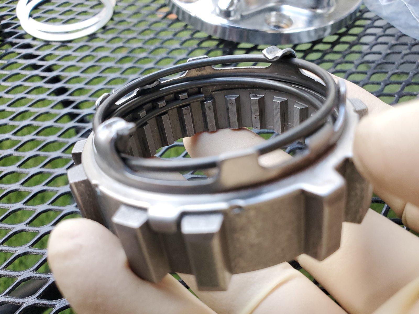

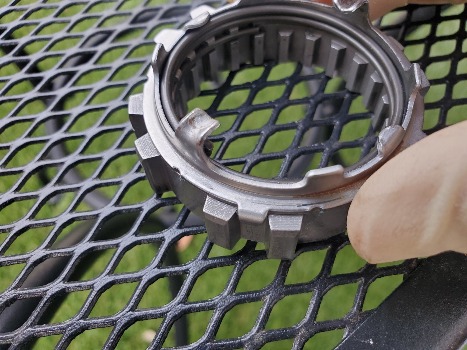

    From left to right, the clutch, the spring, and the pawl

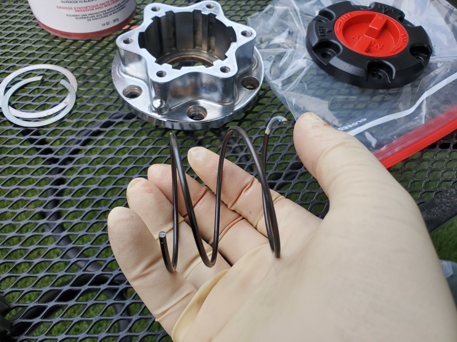

    You have two springs; this one will use the smaller set with the end bent upward
    That spring goes inside the clutch, this is your guide here; grease where applicable
    Spring installed
    And that bent portion on the spring is where the pawl catches
    More angles
    You'll take your partially assembled hub dial, along with this spring, and set it aside as you'll use it later like this

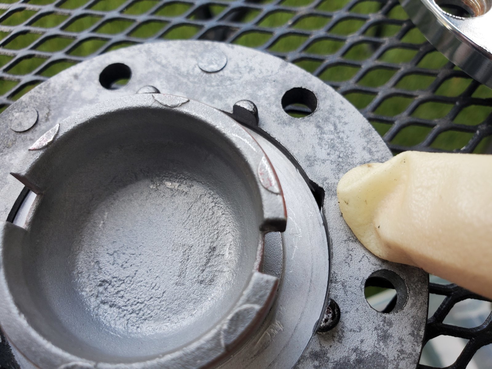

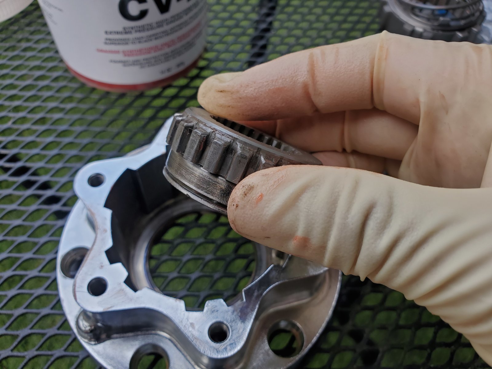

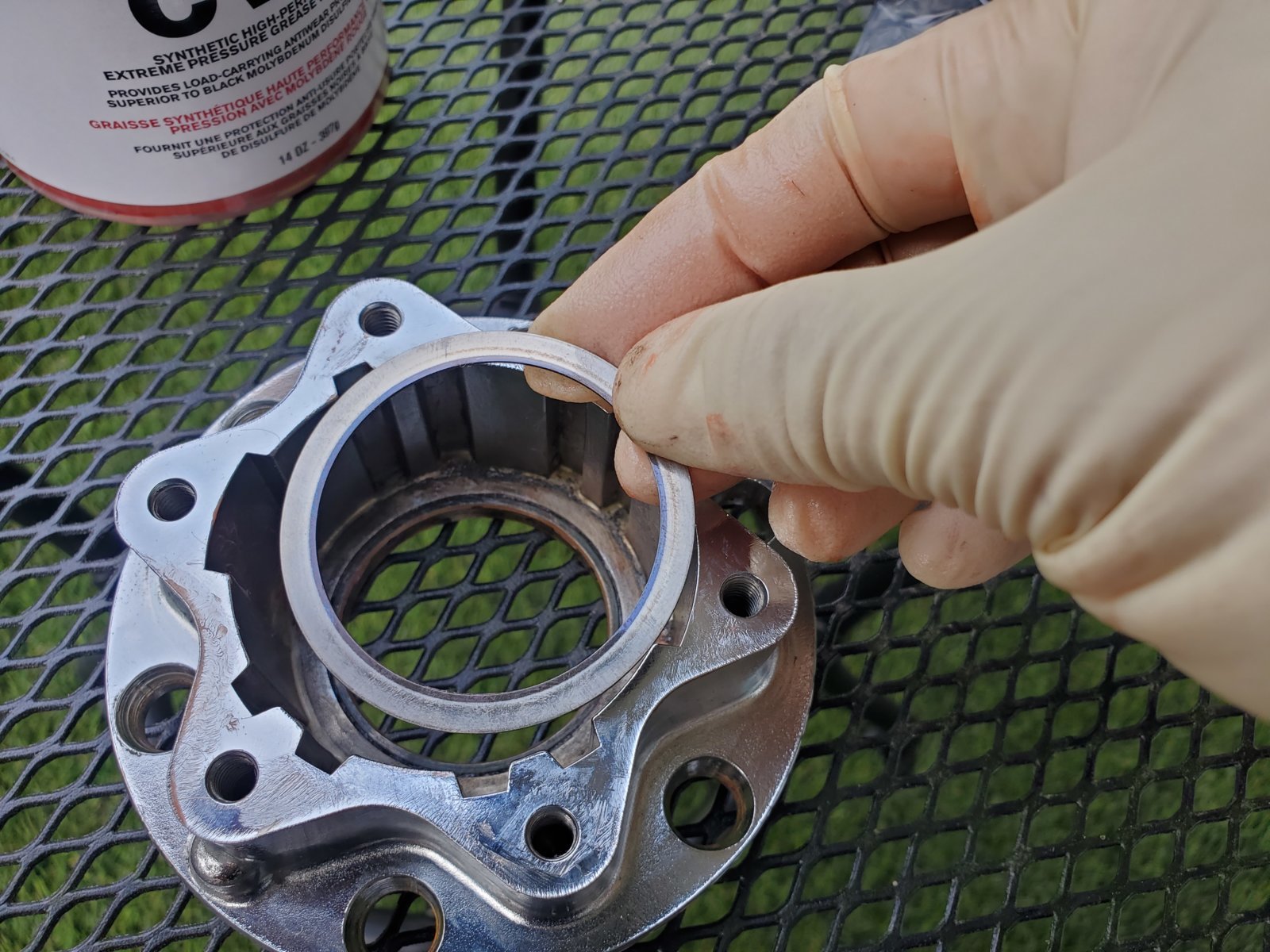

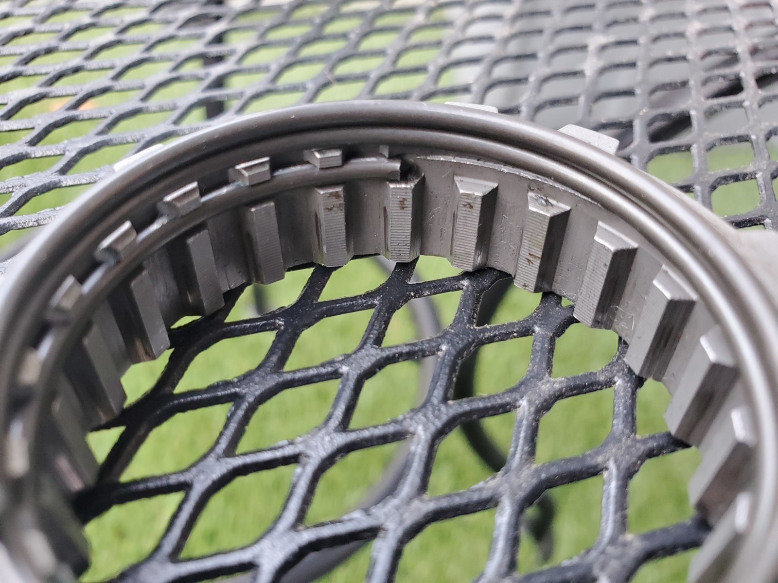

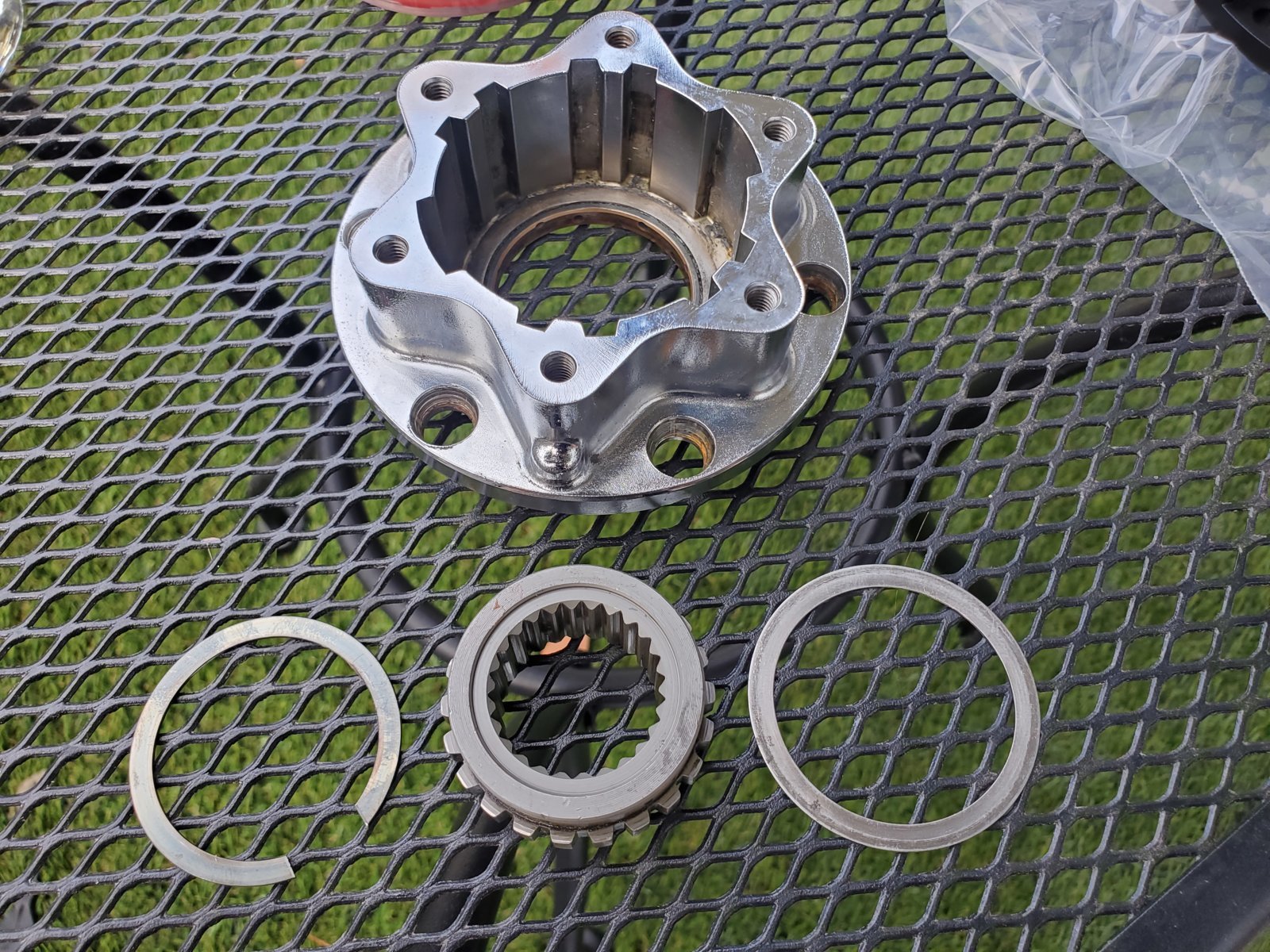

    All that's left is the hub body up top, and left to right the snap ring, inner hub, and spacer
    Spacer goes first; grease where applicable

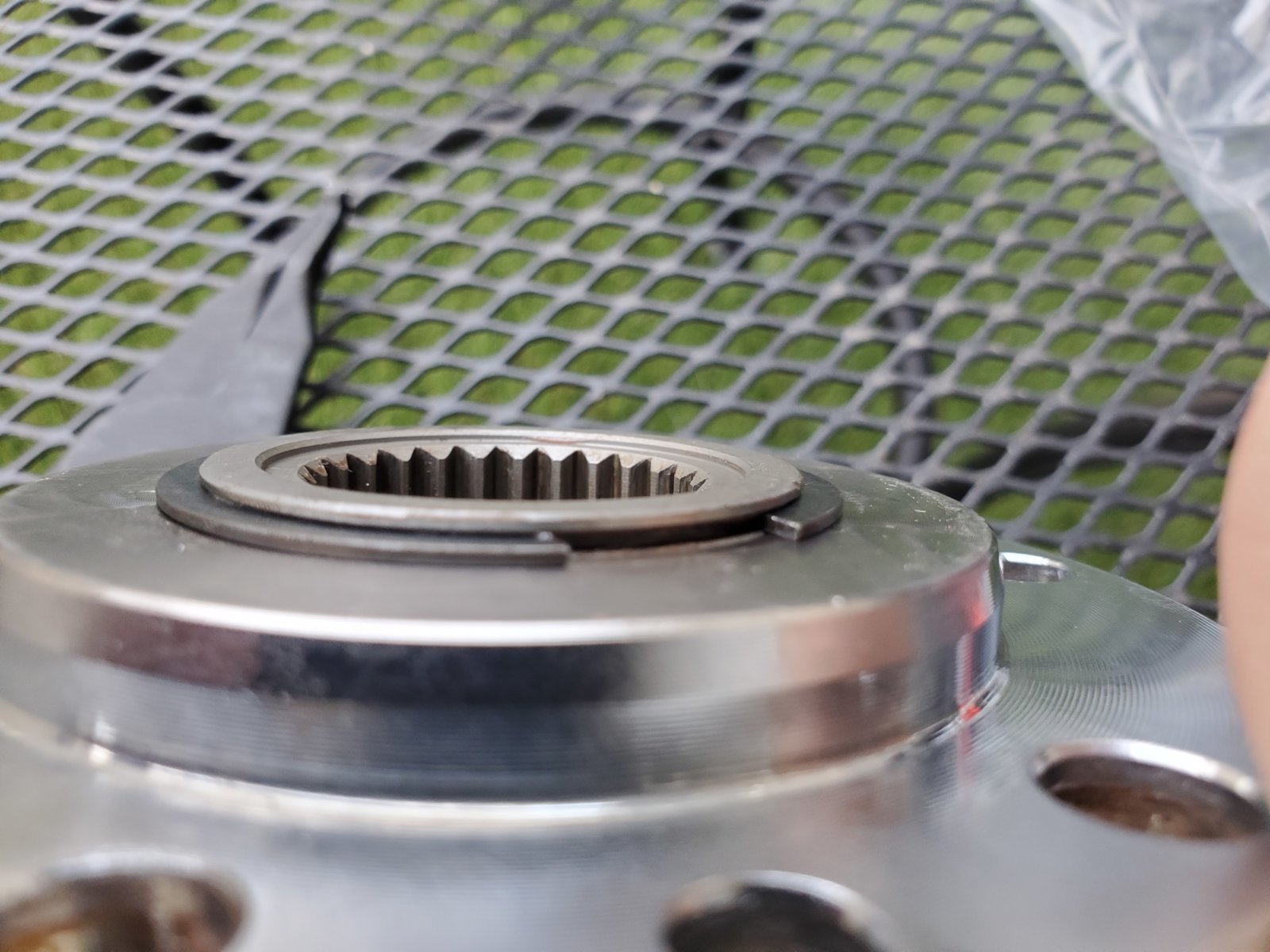

    Then flip it over to reveal this groove
    Yep, snap ring goes there
    Make sure your shit is in FREE mode

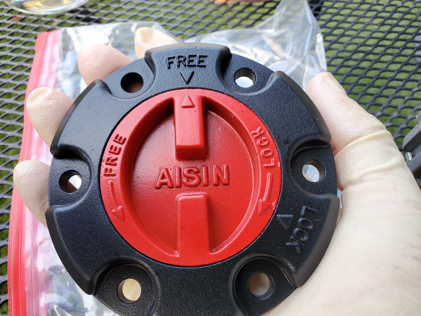

    Finalize your assembly

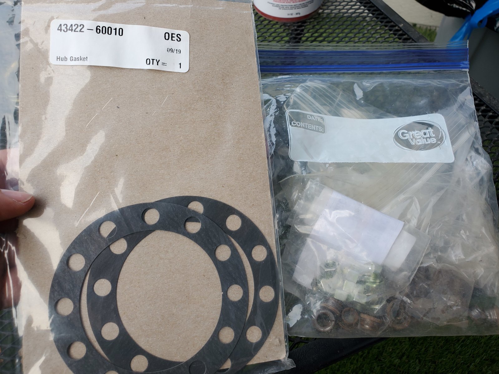

    Don't forget that new gasket you got in your rebuild kit
    Put on a few bolts, and do a function check by ensuring the inner hub (spinning it on the backside) only spins when in free mode
    And remains stationary when in LOCK mode
    You'll use these gaskets when attaching the assembly to your axle hub on your spindle
    ControlCar, turbodb, zippsub9 and 3 others like this.
