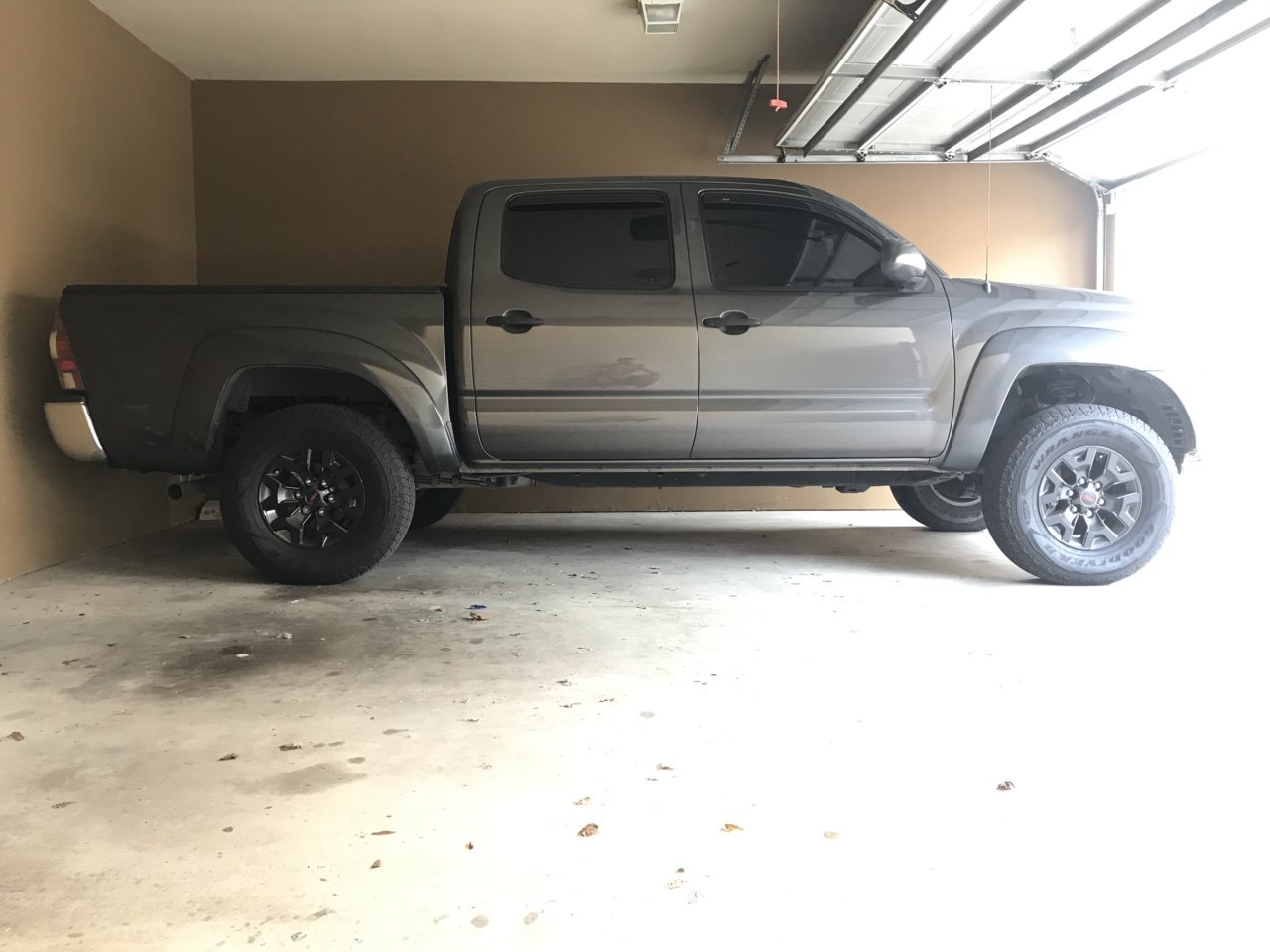

    48B720AB-B06F-46FD-B76D-2EB7DE6063F3.jpg As promised, a picture of my girl cooped up in the garage.
    69 Jim likes this.

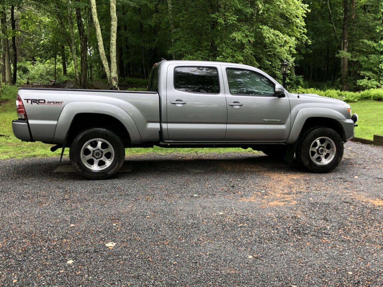

    31
    James
    2015dclb
    839CDBDA-8F8E-4C6B-B211-196D46739B6D.jpg You’ll be fine.I have a 2015 DCLB sitting on 265/70/17 that I put the 1”heavy metal ones in about 4 months ago an about 6k mi. with no issues. I have the 5100 all around fronts set on third clip 1.85 lift. No more bro lean, as far as the blocks go there tapered an come with new hardware which I thought was quality no slop in the threads and I’ve checked torque twice an were spot on.
    I don’t off road just occasional dirt roads an job sites.
    jackn7 and TheDirtyMike[OP] like this.

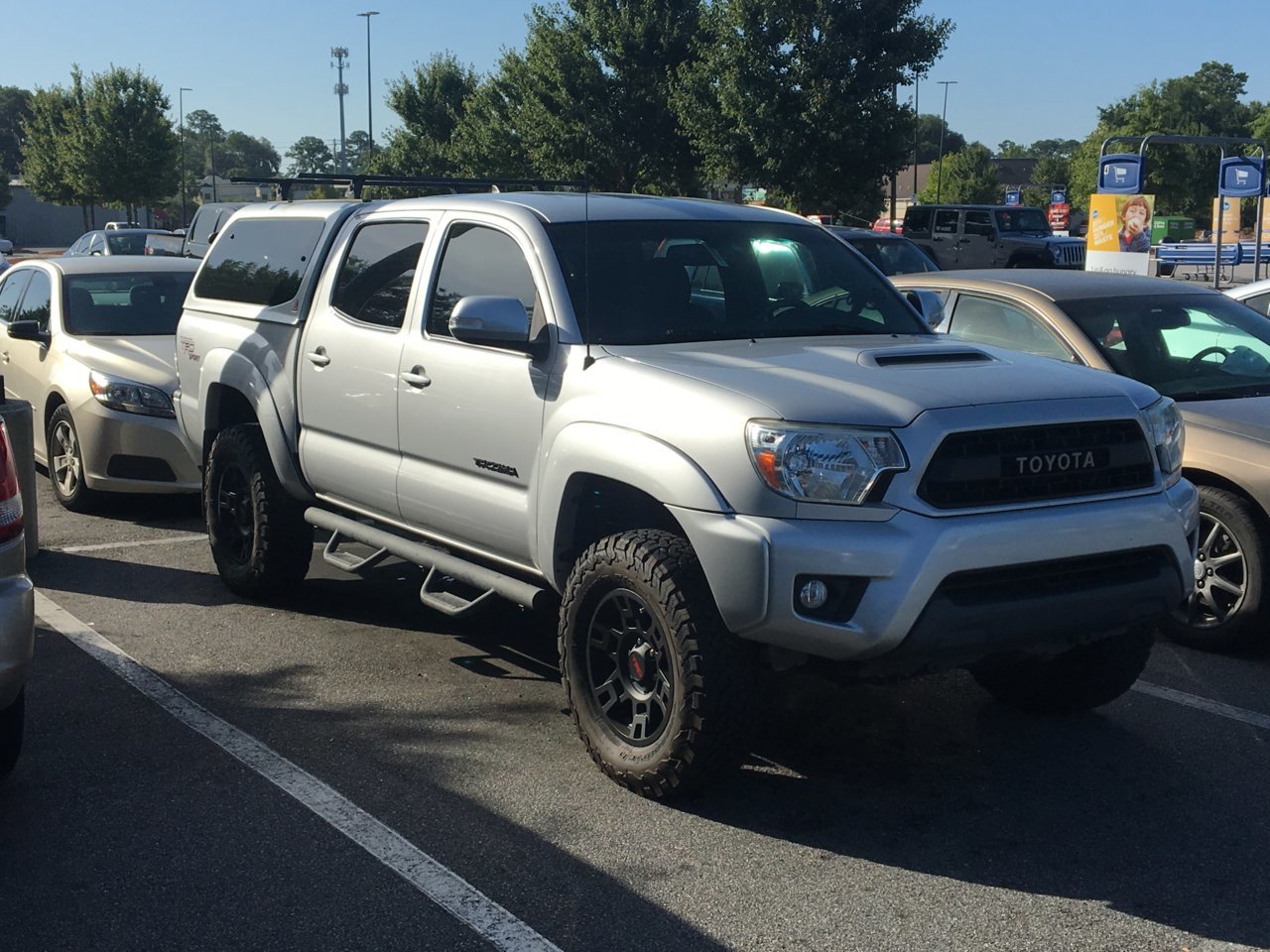

    Phil
    Savannah
    2012 Tacoma TRD Sport
    2012 DCSB. I have 5100s in front at 1.75. I put 1 inch blocks in the rear. It sits pretty level with my shell on the back. No noticeable wrap.
    I have progressive AALs to put in because I know it will provide be better for hauling and ride quality.
    One inch blocks you can do standard u bolts and stock bilstein or standard length 5100s.
    Sorry no that great of a pic. When I put the AALs on I’ll be looking to sell the blocks if your interested.
    TheDirtyMike[OP] likes this.
