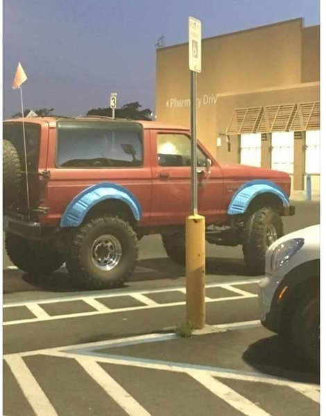

    2021 TRD Poser Pro Manual.
    Needs Fender Flares as well.

    @Unchained 5150 Kiddie pools as fender flares. Nice.
    Tell me they're duct taped on? :D

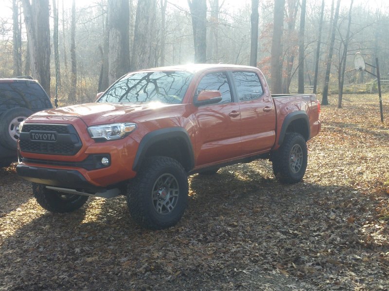

    You're thinking exactly what I was thinking... The key is that it's not all body lift... I've done a 2.5" suspension lift plus 2" body lift on my first gen Tacoma and it was the perfect combo for the mud and sand back in Hawaii and what I used it for.
    For my new 3rd gen, I'm thinking about a 1.5" suspension with 6112's, AALs in the rear, and a 1" body lift. That way I should get the clearance I need and not worry too much on alignment and CV angles. I won't be doing any of that rock crawling (though wish I had somewhere) like a lot of other folks, so this is perfect for my fire roads in South Carolina.

    What did ya use for fender flares on that thing???
