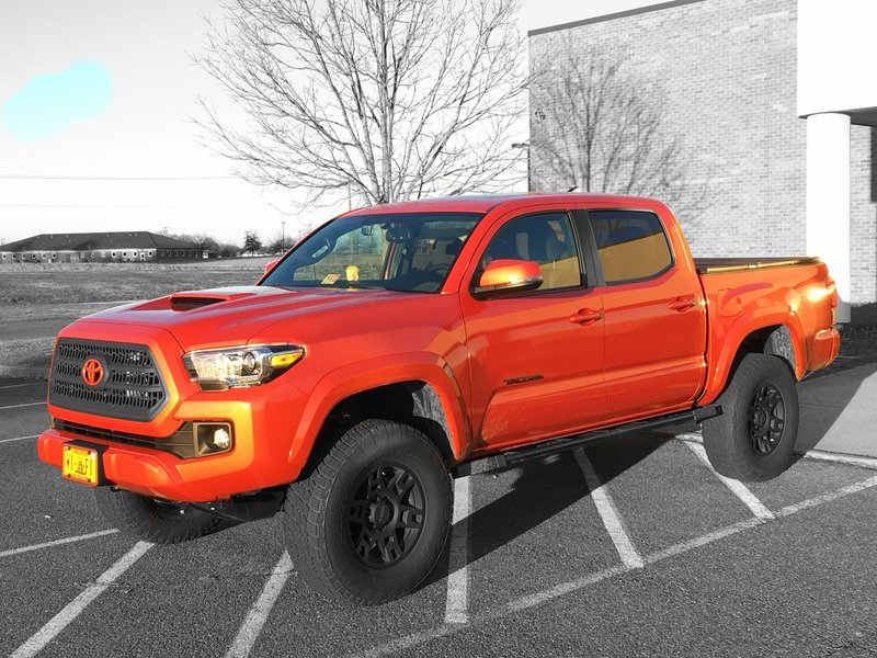

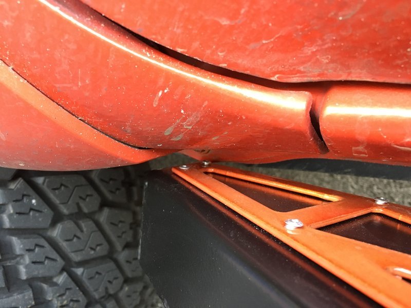

    The rubbing isn't really bad at all. I am more concerned about how close the body is to the slider.

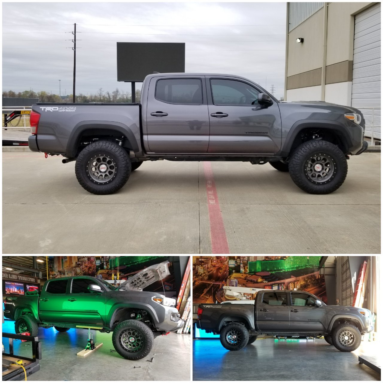

    Tomorrow I'm installing a 1" BL on my 17 O/R
    My lift is listed in my profile, I just want back the lift that I lost when my suspension settled..

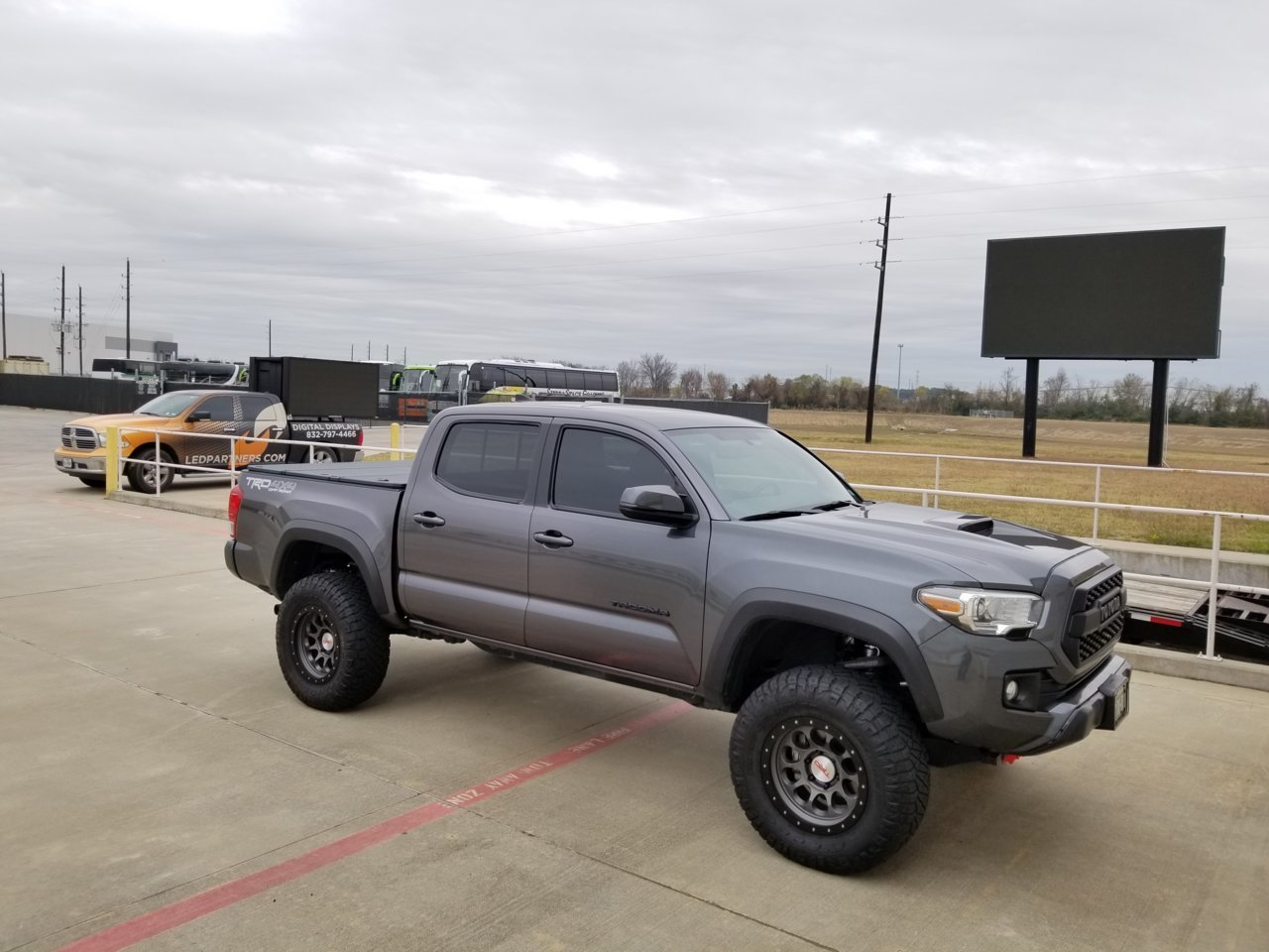

    Body lift is installed, everything went smooth other than I didnt need the drop brackets for the radiator. I installed them and it caused the fan to make contact with the shroud. So I removed them, reinstalled the radiator then checked clearance and everything seemed ok. I'm probably gonna call toytec and pick their brain about this. The kit is listed up to a 15 and I know the 3rd gen is 1" taller so... yea . The radiator brackets did not line up neither unless you pull up a couple small tabs or hangers on the stock radiator bolt retainer

    Thanks I do appreciate it! To be honest it dodnt seem to move that much at all. I checked clearance and let it run for bit before I drove it. Seems to be all good. Just get familiar with where the body mounts are and give yourself a little extra time like anything else. It really isnt that bad of an install

    ...and it's not easy to see but I didnt install the rear pucks. Once I installed the front I really liked how it leveled out. It only works because my bed cover makes it look taller and the window line/curve on the back of the cab doesnt show and looks even. Also if you look at the front of the bedside it kinda gives a little more "flare out" like the tundra beds look

    I noticed there isn't a gap in your rear bumper, and was wondering why not? now i know why.. it looks good man!! :thumbsup:
