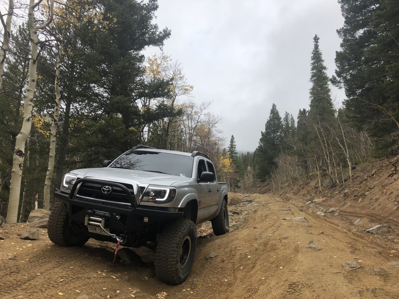

    4FBC2142-9356-4D0E-BA83-A14BFBB5D5EA.jpg Put a 1” on to make sure I cleared the 35’s. Put the 35’s on and realized I didn’t need it and I hated the bumper gap. Then realized the factory bolts got tossed apparently during the install and am currently looking for factory ones.

    um, move the bumper up 1". problem solved lol

    That would require way more work than it’s worth.

    for my front bumper it was just drilling 6 holes lol

    Does yours mount to the sides and bottom of the frame rails? If so, I’d like to see pictures. I like the height with the BL, it’s just the bumper gap that gets me.

    we modified a brute force fab bumper just the same, cut those tabs off on the bottom and re-weld new ones on, slot out the holes a bit and remount. Took about 2 hours
