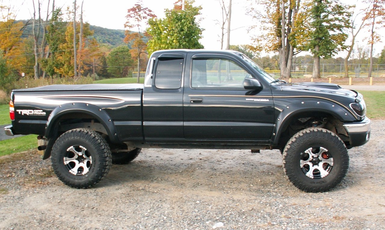

    PA had a 2", discontinued when Daystar took over. 4Crawler (Roger Brown) will make custom, if you want 1.5" (like we had) he will make it!
    We had the 4crawler 1.5" in a 2003

    No, the 2" didn't require the fuel line extension either, just a bracket to extend it higher.

    In the video we showed the steering shaft is extended to the maximum with the 1" ToyTec. The 4crawler with a 1.5" requires a steering shaft extension, the 2" PA kit had a steering shaft extension and looked a lot safer.
