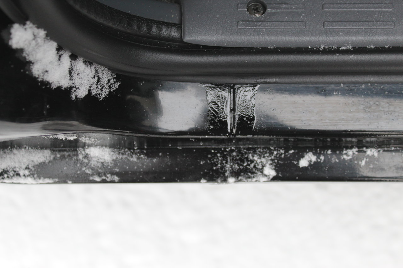

    the FF smell was not that bad to me, i have smelt much worse in the past working many weeks in sewage treatment plants during the summer and the worst was probably at a plant where they make dog and cat food :puke:good grief how can my poor dog eat that nasty smelling stuff they call food
    anyways, i was sorta stoked to find out this imported Canadian gel CF 3000 had no smell, no drip and no odd color like FF, which just looked funky yellow out of the rattle can
    here is what CF 3000 looks like misted on a body panel passenger side seam to prevent any roadspray seeping through the paint like had happened at some point in the past on the driver side in this area. it adheres and creeps like a magnet
    i will keep tabs on how durable it is this winter with routine spot-free rinsing and door jam wipedowns which would probably just wipe it right off, i don't know yet!

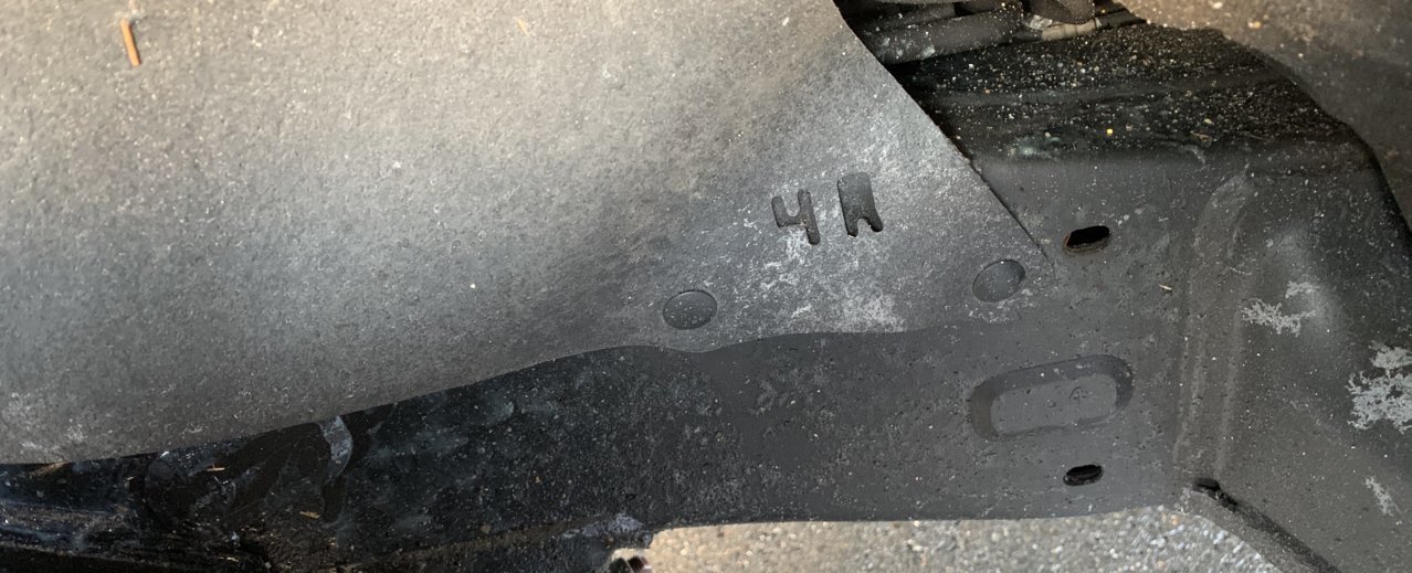

    Unfortunately my pic proves me wrong on the salt. Salt did adhere to woolwax as you can see in the right of the pic. Either the road spray has eviscerated the woolwax there or I just looked at the frame on a day when unsalted road spray washed the salt off. Regardless, I’ll be touching up that spot soon enough. Ahh the power of owning:)

    the sand and stuff might be able to be hosed off fairly easily, while leaving the WW coating behind?
    i am now trying to figure how much psi the FF and WW can withstand before blowoff
    and how much psi on average most car washes with the hand wands use

    If crystal salt is on the top of WW why would you bother washing it off. I hope WW is the same as FF - whatever is on the top of FF in my truck does not go through, meaning stays away from the frame. No worries, WW or FF will not rust because the salt is sitting on it :rofl:
