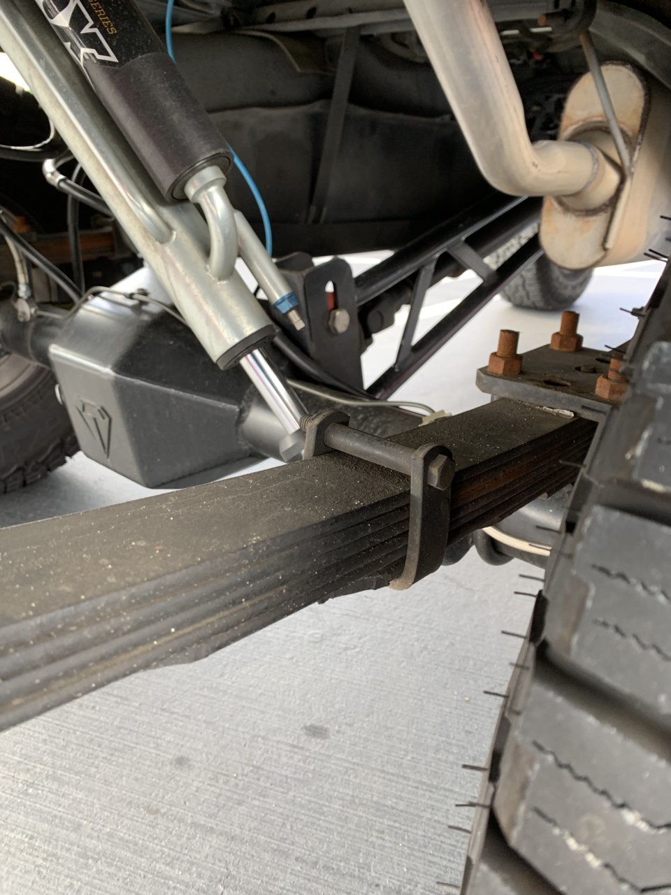

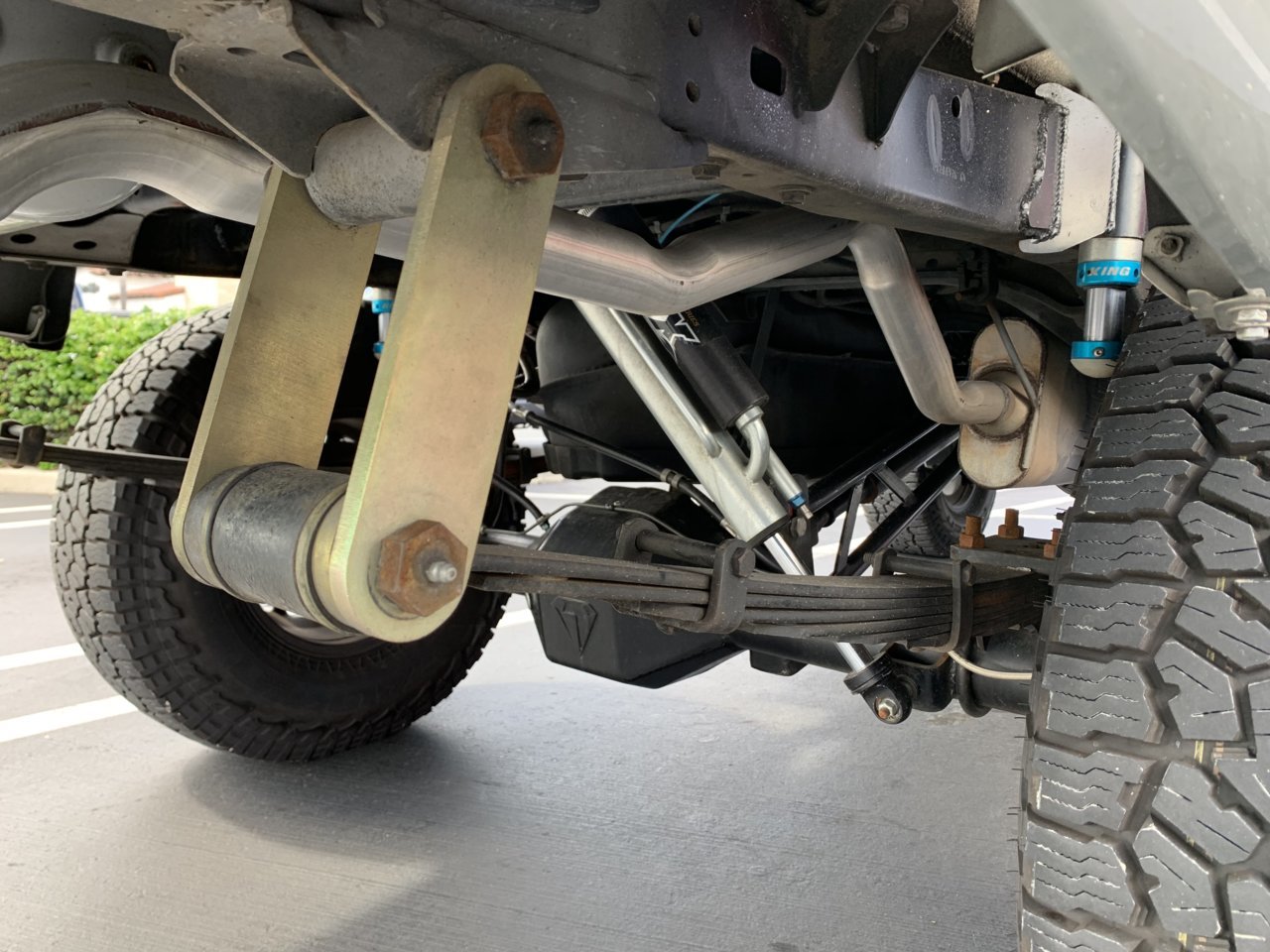

  8. May 20, 2019 at 4:40 PM
    #28
    Ritchie
    Ritchie Well-Known Member
    Dec 24, 2012
    #93649
    1,931
    San Diego (North County)
    RC Step side Pre-runner
    2.7 w/auto, 4WU 3 link, F & R Diamonds, ARB's F/R w/ Yukon 5.29's, Inchworm 4.7 Lefty, Deavers, ARB OBA, Schrockworks up front.
    Here are a couple of specific shots...

  10. May 20, 2019 at 5:10 PM
    #30
    Ritchie
    Dec 24, 2012
    #93649
    1,931
    When I had my rear Diamond built, I went with OEM specs and width. The combo of Deavers, shackles and 12" FOX's work extremely well and no shims required. I say this as I have a regular cab. Guys with extra cabs or 4 door may have issues but, this is where the lowering of the carrier bearing comes into play... along with the extended brake line and LSPV bracket.
    Here is a pic of what I'm currently running:
    Brice likes this.
