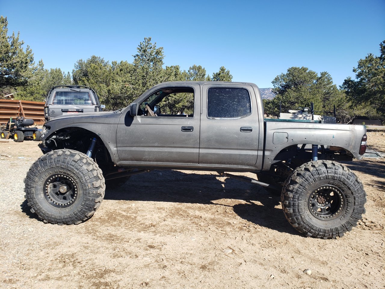

    Look like a rock assualt front housing.

    Close but not mine. super clean
