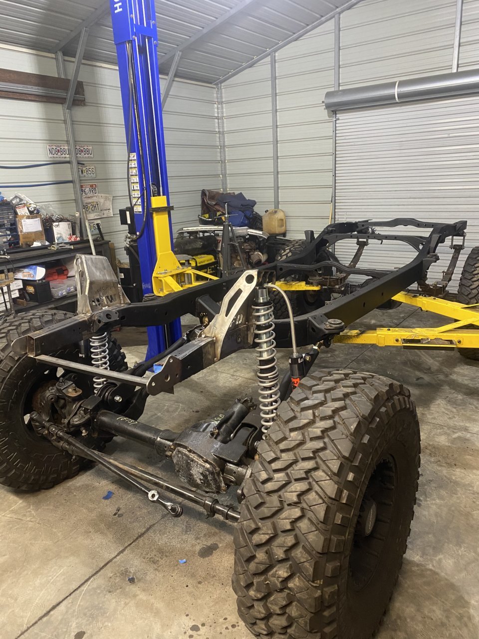

  5. Feb 2, 2021 at 10:04 AM
    #265
    02 Goldie_1tons
    02 Goldie_1tons Well-Known Member
    Jan 18, 2021
    #353243
    59
    2002 4dr gold 3.4 (530k miles)
    Non yet, but everything ordered to do 1tons.
    Potter, what is your frame height, with the 12inch coilovers if you don’t mind me asking?
    And what’s your shackle length on this stock rear springs. I dig how it sits. And mines looking tall....(with no weight)6C52D457-BB75-4EA3-BBB5-C5CBFD152F5A.jpg

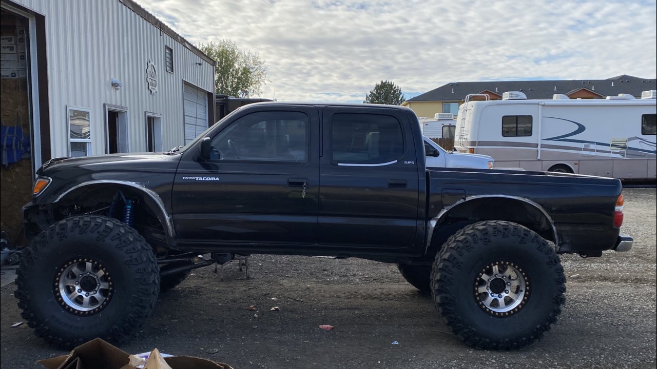

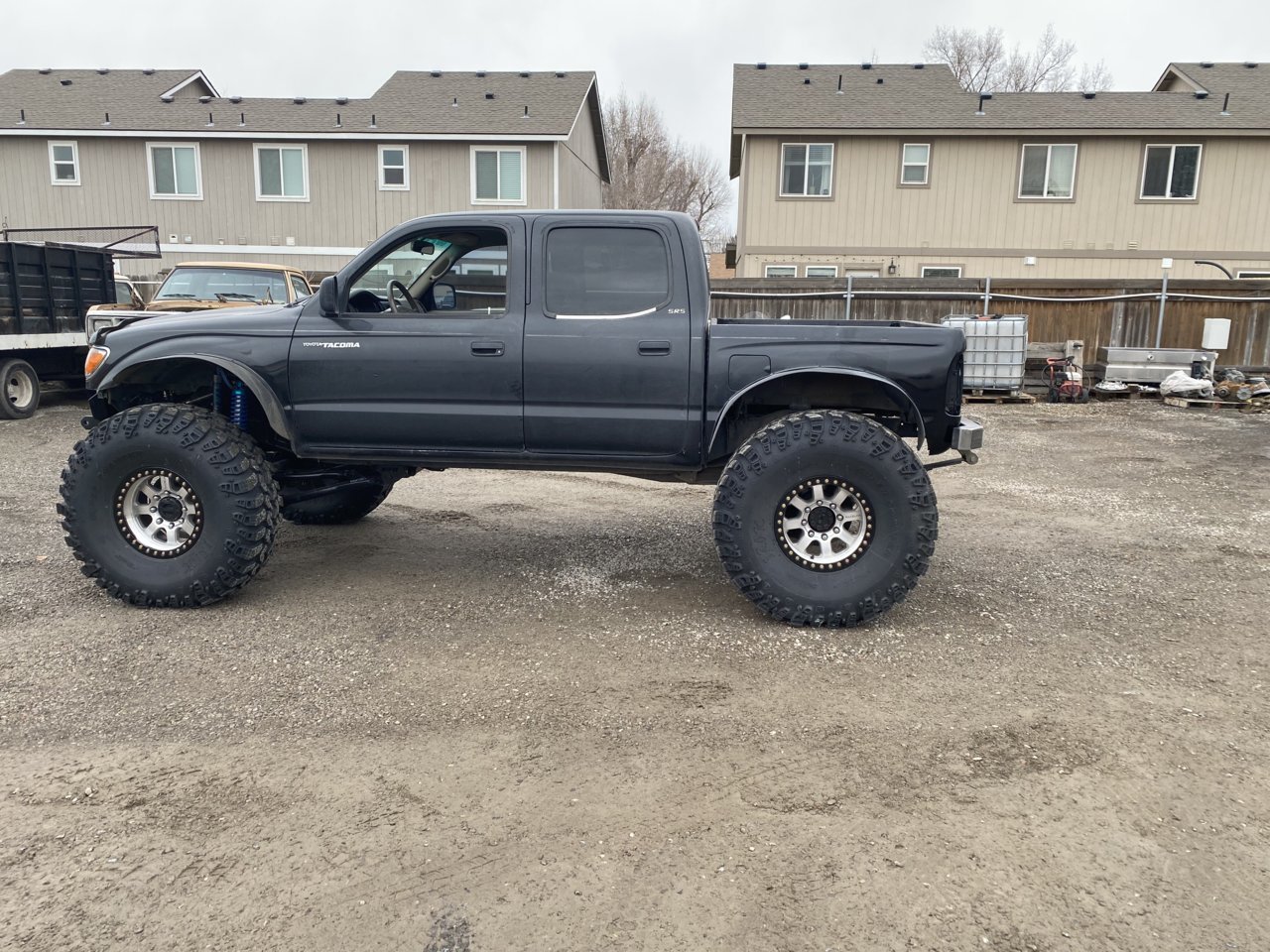

    Do you have a side shot of yours by chance?
  10. Feb 2, 2021 at 11:15 AM
    #270
    Potter1ton coma
    Potter1ton coma [OP] Well-Known Member
    Sep 7, 2020
    #340098
    345
    Jason
    1 ton double cab
    Side shot of my truck?
  11. Feb 2, 2021 at 11:16 AM
    #271
    Potter1ton coma
    Sep 7, 2020
    #340098
    345
    Jason
    1 ton double cab
    There’s the side
    Bigdaddy4760 and Fernando like this.

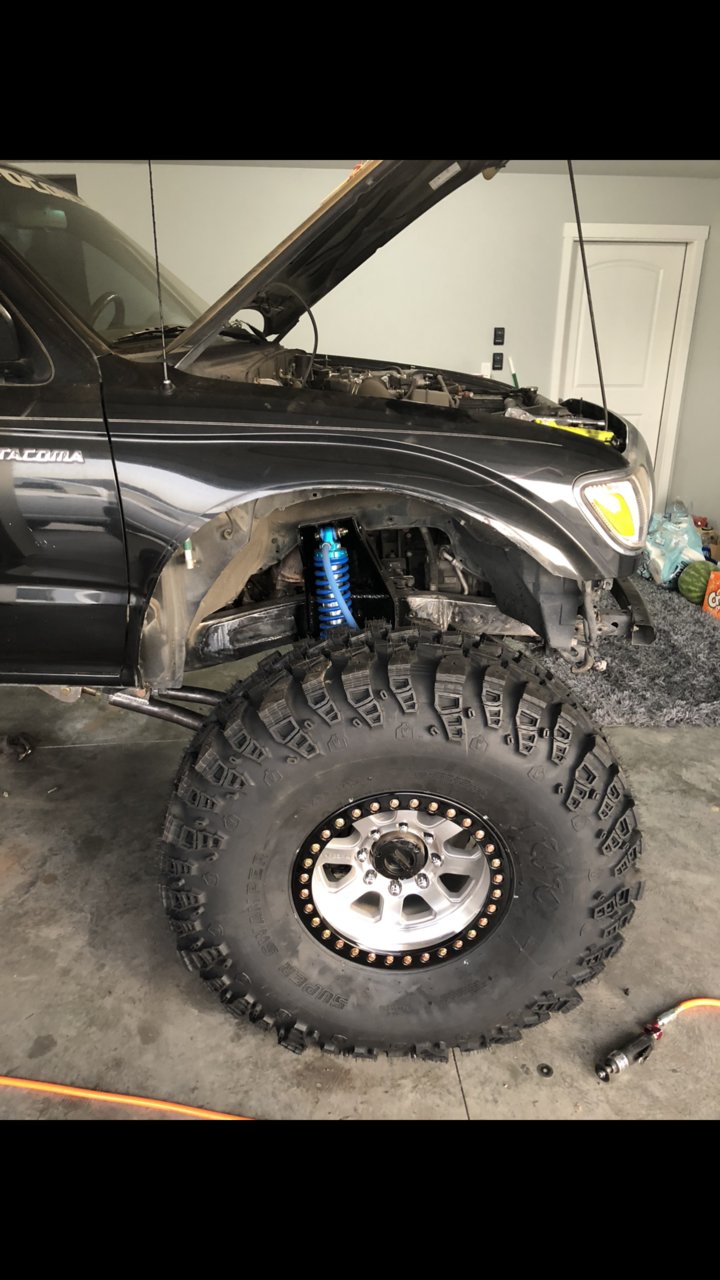

  12. Feb 2, 2021 at 11:18 AM
    #272
    Potter1ton coma
    Sep 7, 2020
    #340098
    345
    Jason
    1 ton double cab
    That was before the bob job

    There was a side view of the hot rod before it went under the knife haha

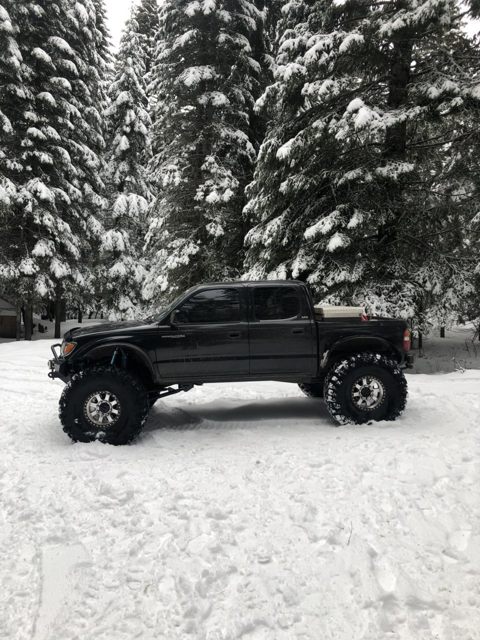

  16. Feb 7, 2021 at 1:50 PM
    #276
    Potter1ton coma
    Sep 7, 2020
    #340098
    345
    Jason
    1 ton double cab

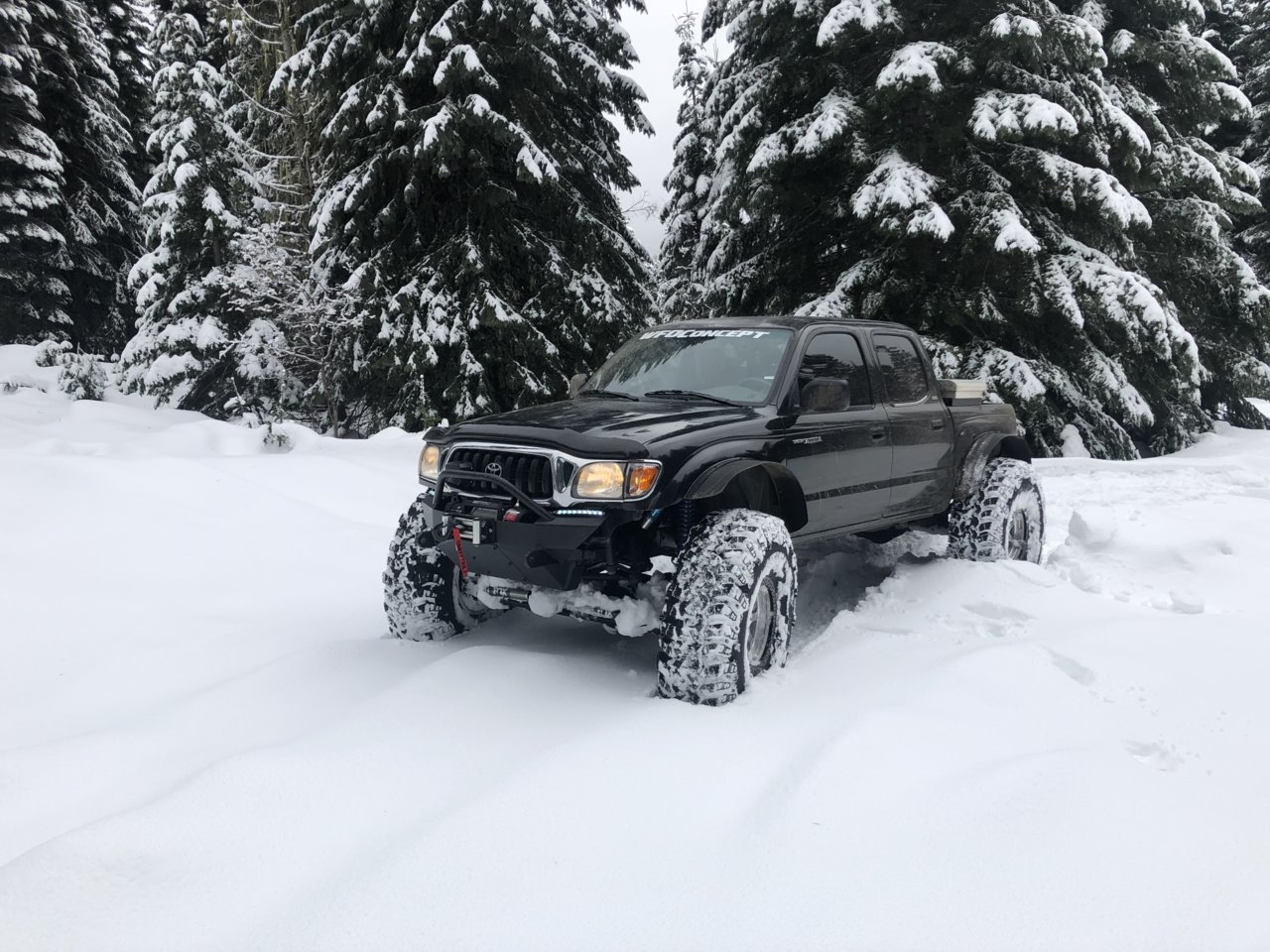

    Good day in the blues and finally got to enjoy it some more
    la0d0g, Glueman, ColoradoTJ and 6 others like this.

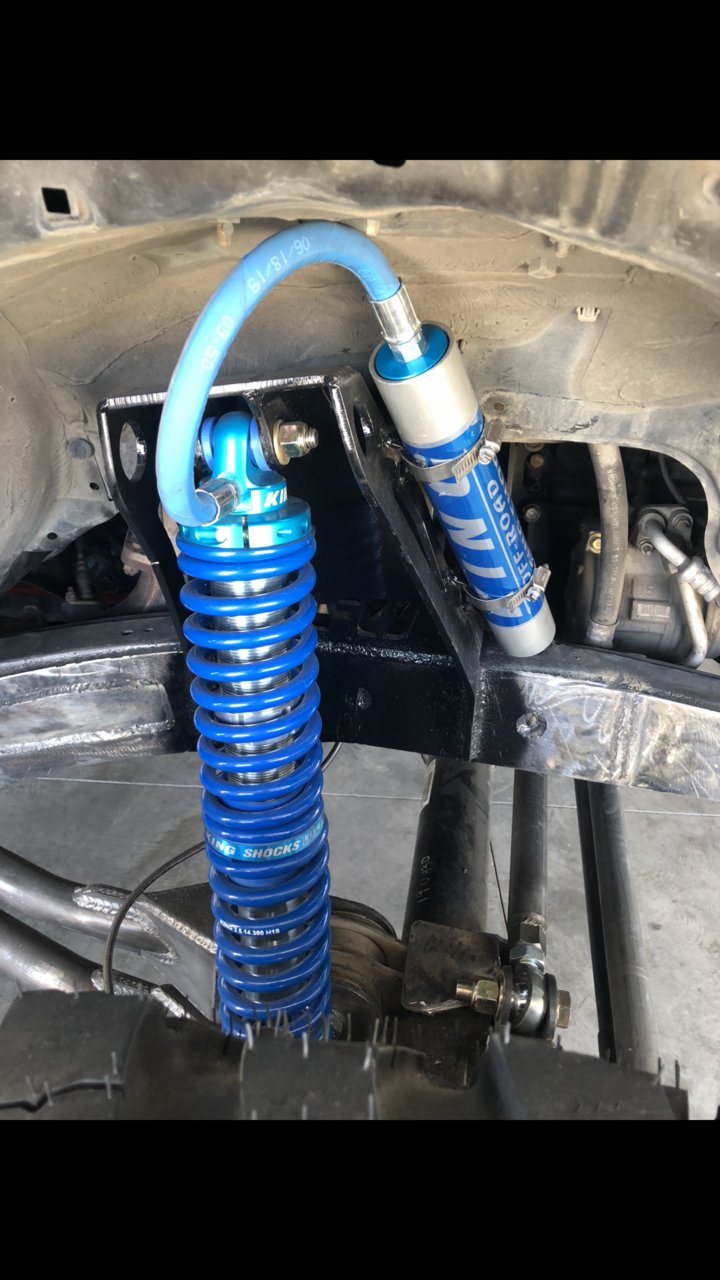

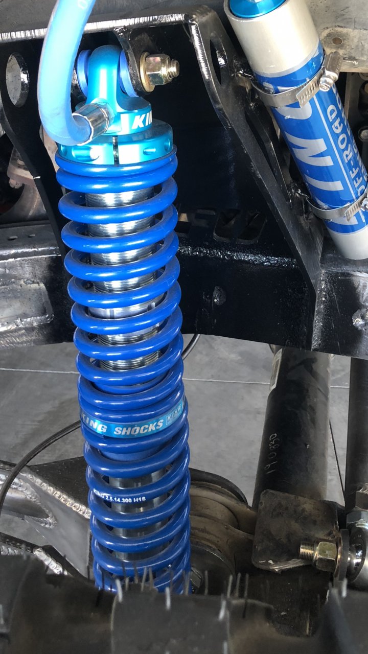

    Out of the blue here, and curious if you’d give me some insight? What does your shock look like in your shock tower at ride height? (Angle)
    And possibly pictures of that, and location your towers ended up being? Trying to compare to mine considering I don’t have my cab to sit on it yet.
    Appreciate it man!
  19. Feb 8, 2021 at 6:38 PM
    #279
    Potter1ton coma
    Sep 7, 2020
    #340098
    345
    Jason
    1 ton double cab
    Hope that helps man that’s all I have that I can find
    Fernando and Bigdaddy4760 like this.
  20. Feb 8, 2021 at 7:22 PM
    #280
    02 Goldie_1tons
    Jan 18, 2021
    #353243
    59
    Man it sure does, what I’m battling is that my upper shock tab is barely hitting “shock tab body”. With no weight on it. So just kinda comparing. If you have any of drivers side also I’d owe ya a steak dinner. But yeah man. Appreciate it more than you know.
