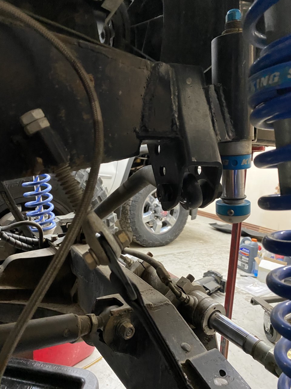

    Mine sat flush on my frame I curved mine with a grinder a tiny bit never had that size of gap at all but it will all work out in end cause my fender wells inside of engine compartment would never of cleared if it sat like yours my touched the sides flat I didn’t want to move anything inside of the tight engine compartment that’s why I went with 12s

    That’s crazy, I’m running 12inch foxs and if I tilt them any other way, my shocks are at too extreme of angles in the eyelets. I wonder if the foxs and kings are different in that aspect? Odd...

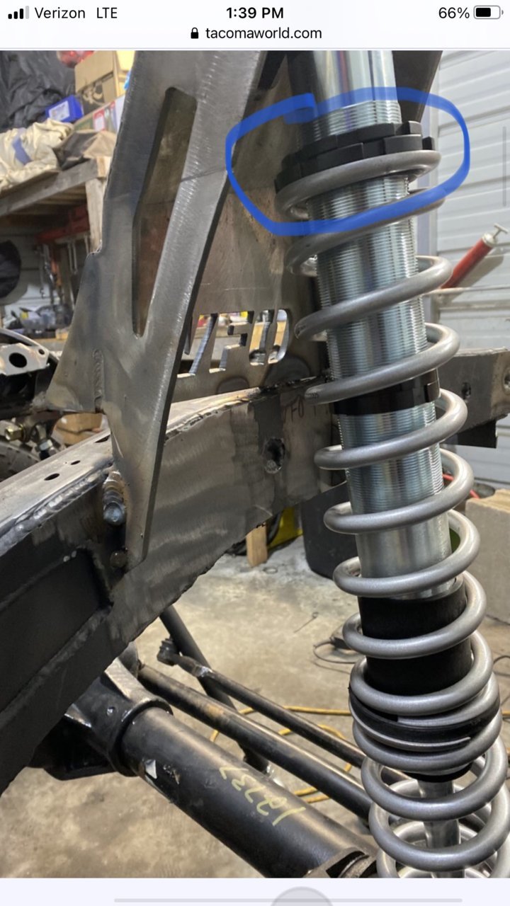

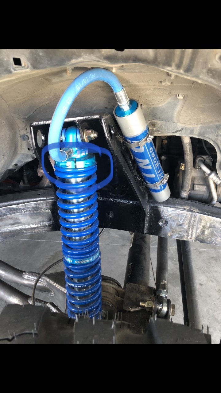

    Ya idk mine are almost straight just a little angle but I had my top adjustment all the way up yours are cranked down about an inch and half that raised your truck up also

    Compresses your springs more also with the top adjustment down

    I’m half convinced they welded my shock eyelet tabs crooked or something at this point... and I’m not following on the shock compression?....

    Those 2 black nuts are adjustable my coil nut is all the way up top yours are down with it on truck it raises it and compresses the shock down

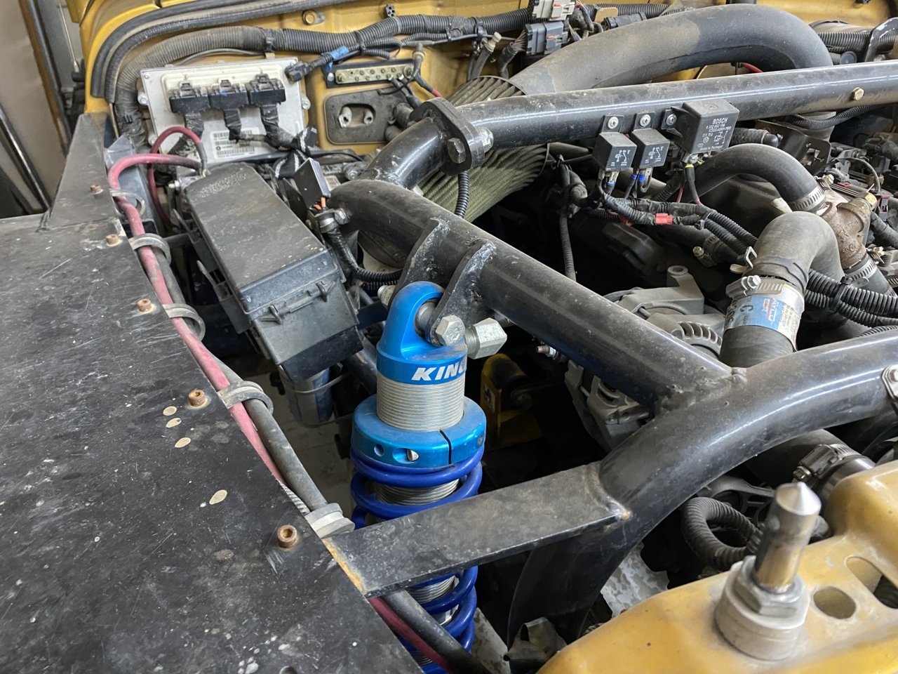

    Ever consider making your own shock hoops? During my build I tried shock towers and it just didn’t work for what I wanted.

    Oh right, I get what you mean. Yeah I only did that to keep the springs “tight” but apparently it makes more of a difference than I thought it would. I’ll see what it does now that they are on and with a little weight. Also gonna add motor and trans to see if angles change.

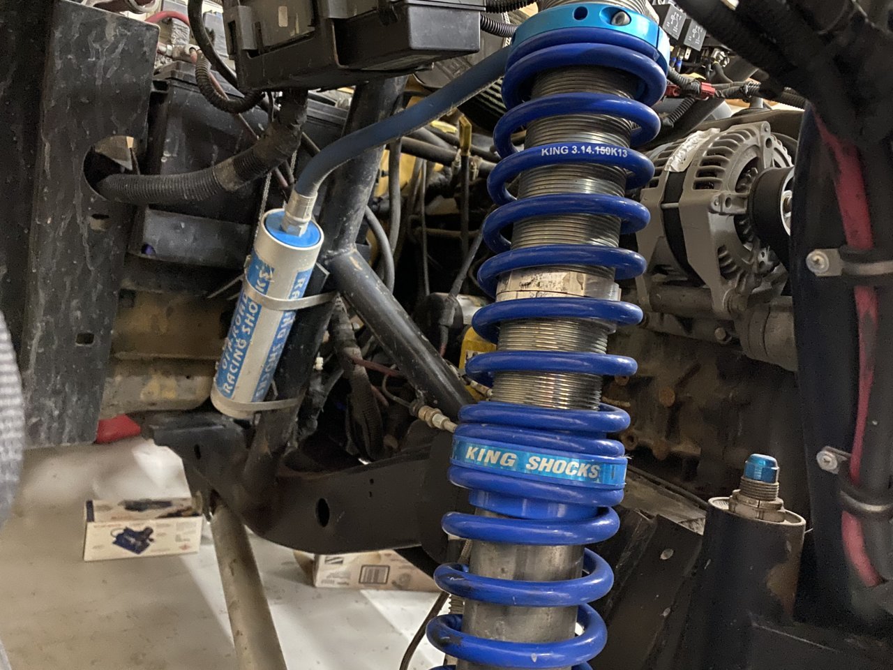

    You did a nice job with a Jeep you got a little more room though these trucks with the 3.4 are tight as hell everything is so congested but that’s always a possibility

    Man I’m about to that point. I can’t help but be frustrated with Wfo concepts kit due to spending a lot on it, to be able to, “plug and play”. So I’m trying to make them work, but what a nightmare. I’m also learning that me doing this setup without total body and drivetrain weight on it, is severely hindering how everything sits. I guess what I’m trying to say, is I expected a couple thousand dollar kit to come together better.

    Hoops will be no different than the towers. The crossmember is a different story like you stated. Might have to get unconventional with the tie in and make it closer to the firewall.
    Snow running is a different animal all together. Not running fender-well skirts probably isn’t a good idea for you all.

    what did you set your preload to?

    Says to set my preload to atleast 1 inch I only cranked my down a half inch but I’m not jumping it every minute

    Should have been more specific. How did you set your preload?
