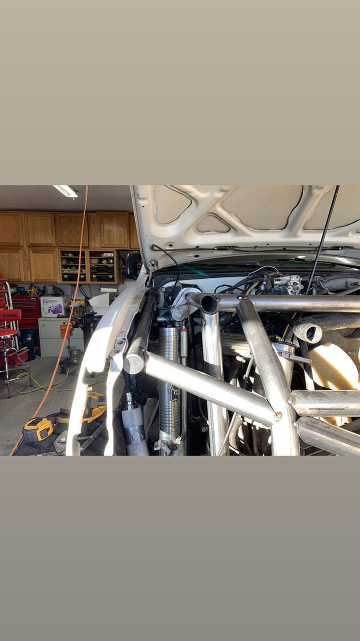

    Just curious, I may have missed it, why did you guys go with radius arms vs a standard 3 link?
    and I couldn’t fit a shock tower either. Ended up with shock “hoops” essentially

    For me it’s only because Wfo said they would work, out of the box, as a complete kit. Mines a dedicated daily long before crazy crawler. So it seemed like a nice kit to buy that had mounts and geometry figured out. Finding more and more, that isn’t quite as I was hoping. But on the flip side everyone seems to like the road manners and capabilities of the kit once done.

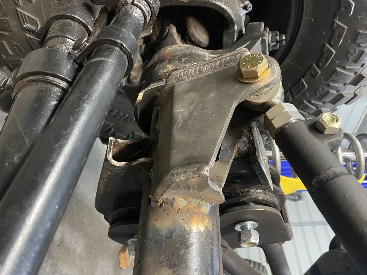

    I talked to Tyler at Wfo, and they said the towers are designed for d44 kits and that they will work if you make them essentially. And guys like potter have definitely made them work fine.

    I went with them due to being a kit that is designed for the application and after seeing lildooskis truck perform I don’t see why not I don’t go to flex competitions or care about crazy flex I’m simple just do snow wheeling and use it for hunting season everything I have used it for has more than satisfied me if I was going on rubicon trail or king of hammers and such I would of 3 linked front for flex but the design with the radius arms mounting direct to the axle and how this thing drives it’s amazing I drive it 60 miles from my house to the blue mountains to wheel it’s like driving my brand new truck
