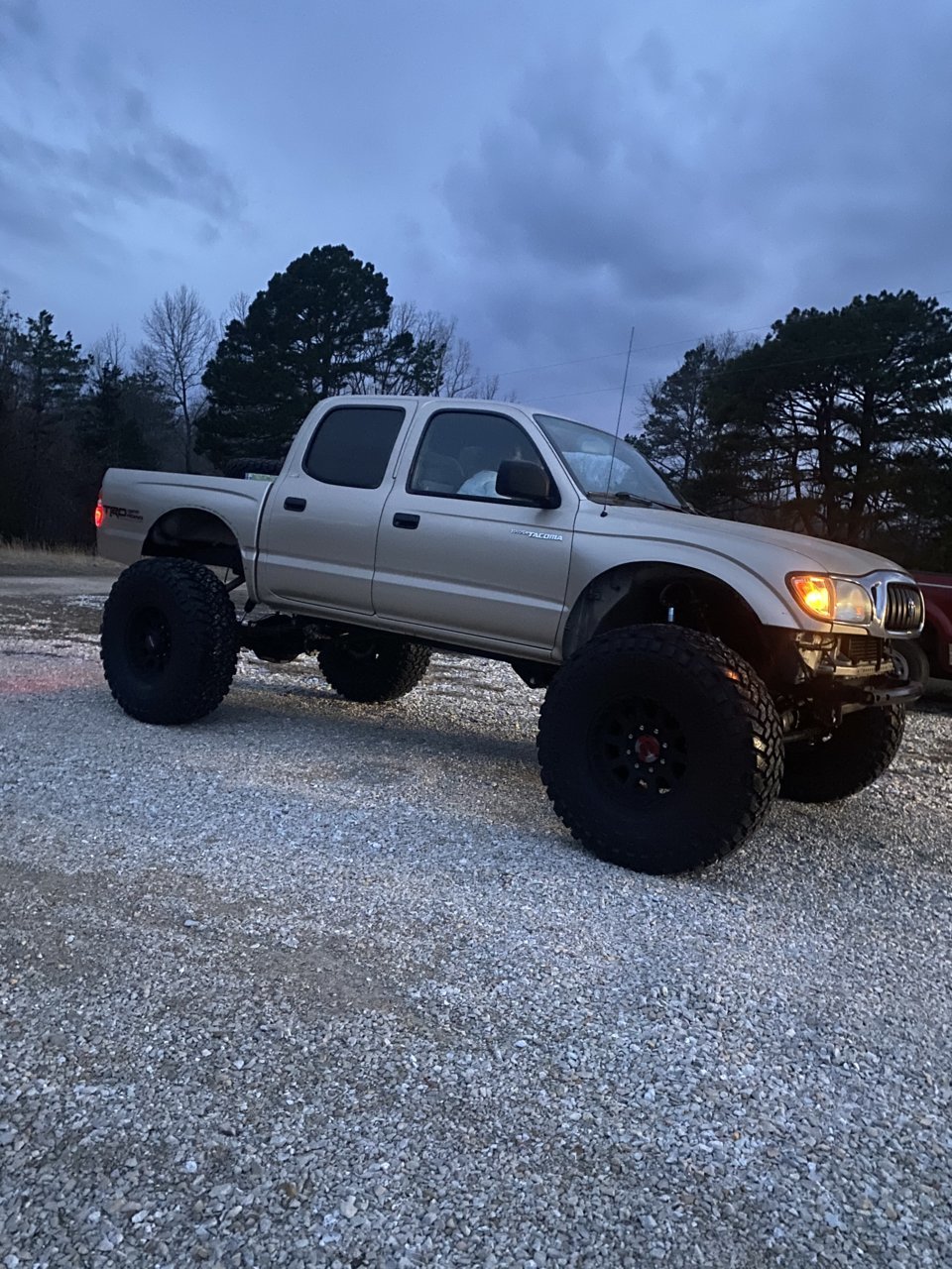

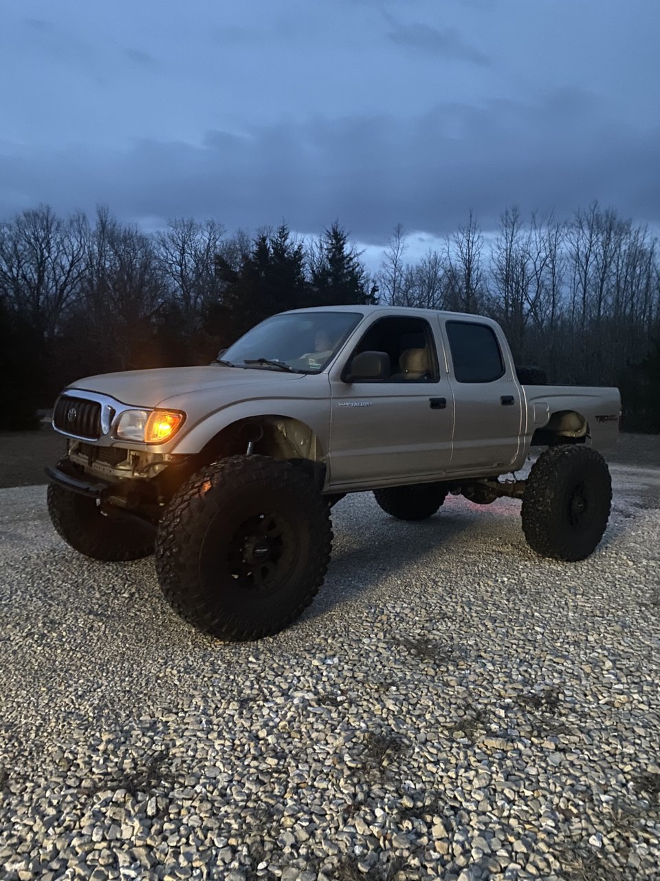

    I like the color of your truck different everyone and their dog has a black or green double cab you did awesome on it what’s your frame height?

    Man I appreciate it greatly! It ended up at about 27inches up front another inch in back prolly

    I may have asked you already, and I may just be over looking it. But what’s your frame height? I’m just kinda comparing mine to your very first picture right now. And curious.

    Mine was right at 23 1/2 inches but I have stock prerunner springs also in rear too
