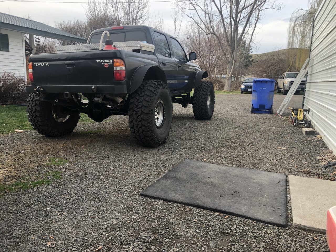

    Nice ya you don’t need room just for dogs but boxes as well so a flat bed would work good

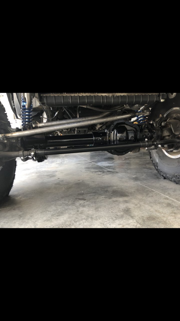

    Those driveline pics help you buddy it was expensive to have them built but wanted to not use adapters

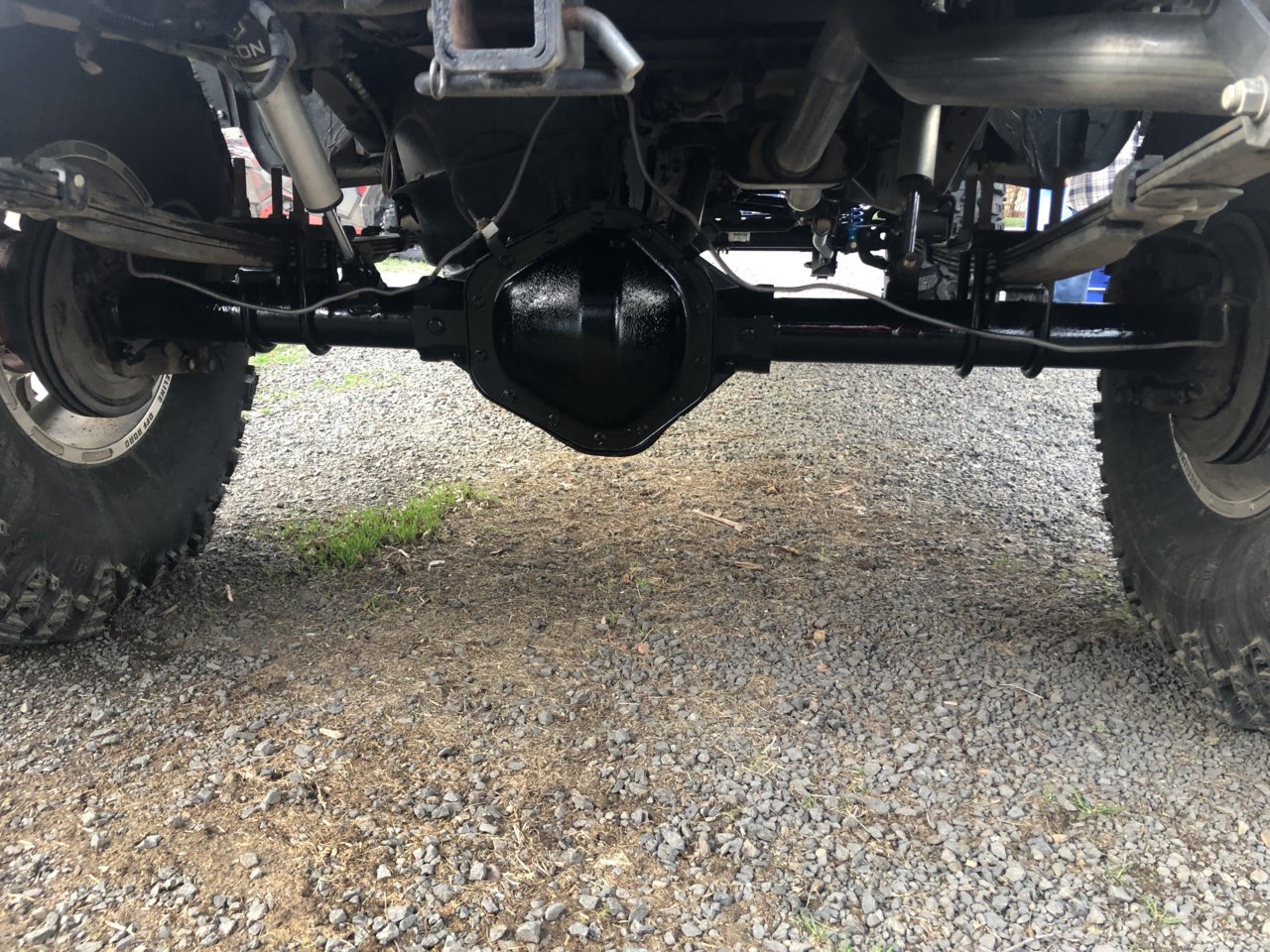

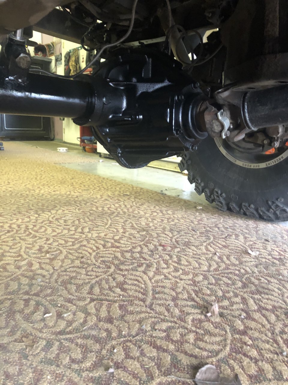

    Finally got rear end all grinded and front all painted looks better

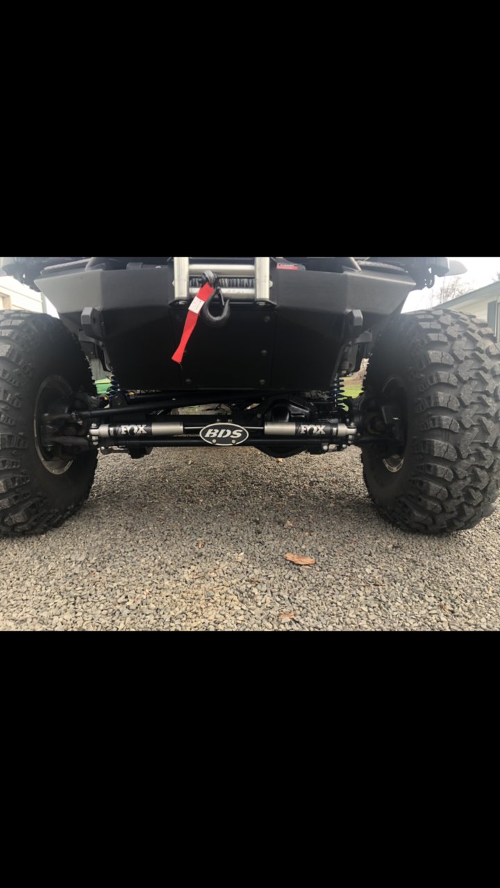

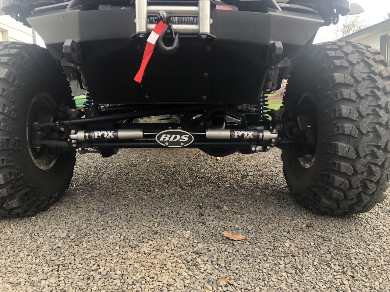

    What bar your steering trac bar I bought a moog adjustable one about 3 inches thick it doesn’t hit at all and your ride without my dual stabilizers my truck wanted to shake me out of the truck

    That bds dual stabilizer is the fucking cats meow no shit my tires aren’t even balanced on these beadlocks and it’s drives like brand new no shimmy nothing and the kings without the preload even hardly set down it’s like riding on a pillow it’s nuts man kings are expensive but I believe in them
