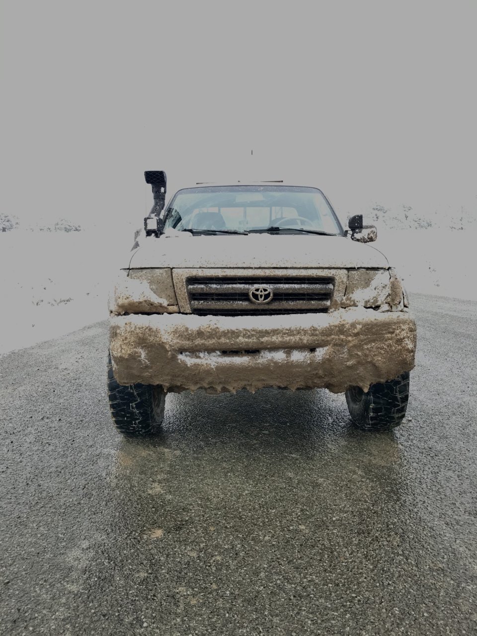

    Same
    Today, doesn’t take much with 33’s though
