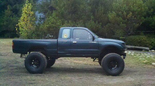

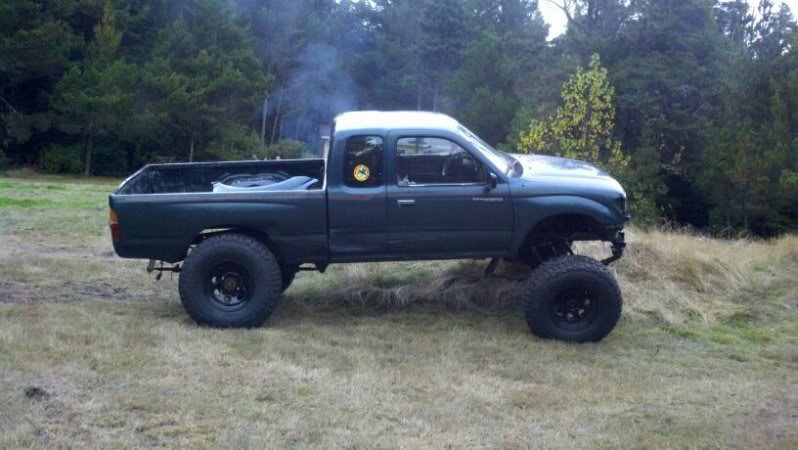

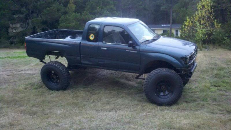

    So i decided to put some newer pictures up. I still havnt made a front driveline been way to busy with work but now i got some time and some money to finish everything
    299307_291798760848117_100000539864206_1_4e7cf962fa2088f674d612026b0e55e64481bb78.jpg
    299962_291838914177435_100000539864206_1_c533a9f130c277da62e8acf03e2f36fb0c7b3202.jpg
    313489_292413720786621_100000539864206_1_916d1f7c5f8479c4b49de809afd8154418cf77f6.jpg
    319900_291838240844169_100000539864206_1_c7816e51508d14460ca10d79b57f3361ba543bb0.jpg
    Now im wishing i had gone with bigger tires but that will be after i wear out my mtrs.
    Next on the list
    front driveline
    dana 60 warn hubs
    front bumper
    twin sticks
    :confused:

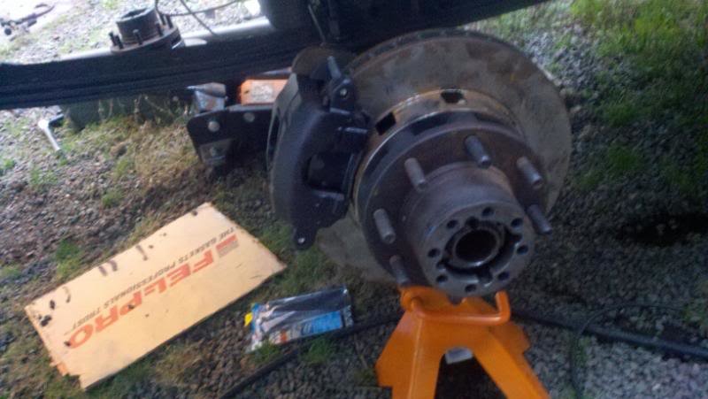

    So i got stuff to do rear disc brakes today. Started on that tonight and ran into some problems with the brackets i got so i decided to cut them and make them work. Ill throw up some pictures of it tomorrow.
    If i got time ill throw in my new t case/ crossmember and get some pictures of that.:D

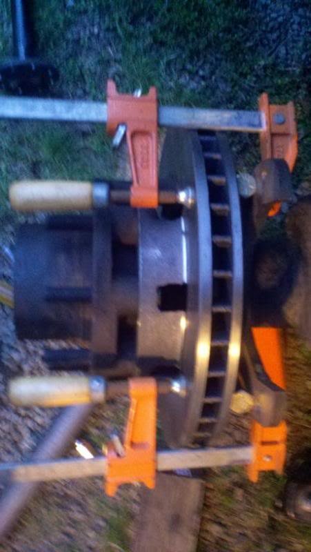

    Some pics from my rear disc 14 bolt hd swap :confused:
    I use brackets from http://www.jkwoffroad.com
    Pretty basic kit but i ran into problems. I had to cut the brackets to fit since i have an axle thats an odd 14 bolt. I ended up putting my brackets behind the flange instead of bolting them to it. I talk to Trevor at WFO concepts and got his input. He told me to match a 3/4 inch gap between the rotor and bracket in order to have clearance for the pads. Then you have to adjust the height so the pins that hold the caliber dont hit the rotor. I used a penny to keep my height right. After i figured out all of this it went really fast.
    Sorry i dont have more pictures of doing the swap but i wanted to get it done...

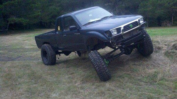

    Another flex picture nothing special but found that my steering shaft was hanging up. So i have to build another one with 2 u joint instead of one at the box... more pictures to come and hopefully some wheeling ones:D
