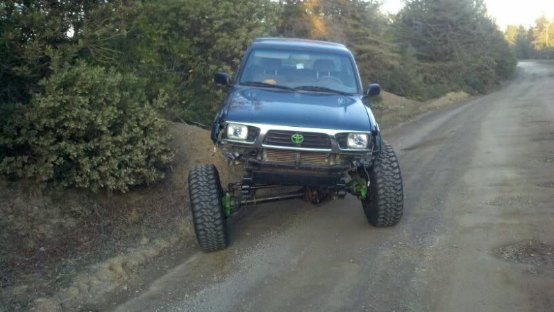

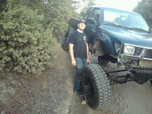

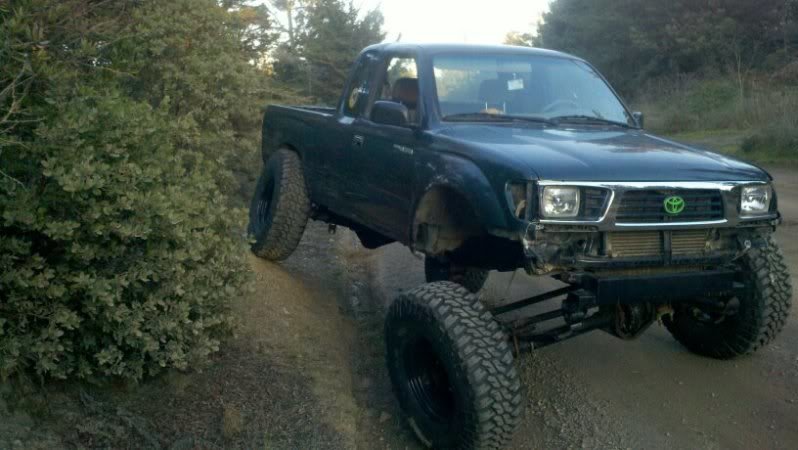

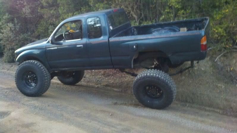

    Well ive been looking at the marlin taco box. I might have found a deal on one but im waiting to hear back on if the guy wants to sell it. So for half the price my truck end up with a taco box.
    As far as my truck goes. I got new u-joints for the steering shaft. I'll put them into tomorrow and work out my steering issues. I found running one joint tends to bind up at full droop.
    here some pictures
    37's tuckin nicely with stock fender cut.
    little bit of drop since i'm 6'3
