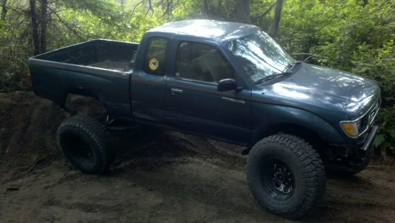

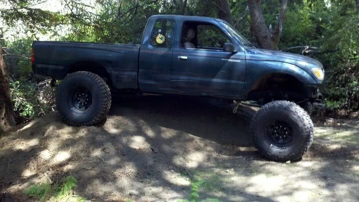

  5. Jun 20, 2012 at 7:17 PM
    #65
    erisman33
    erisman33 [OP] Crawlin Over 1 Rock At A Time
    Jun 27, 2011
    #58965
    55
    Pismo/Mendocino
    1995 Ton'd Taco
    1 Tons with 4 Wheel Disc
    Well progress...............
    I redid the whole rear end. I changed shackles and mounts and axle. I kept the 63's but i think i took to many leafs out LOL. I put a 67 inch wms to wms axle in. I also did disc brakes and 5.38 gears and also a limited slip. The rear is done until it becomes a trailer queen. Then ill lock it up with full time lockers. Also mounted shocks up and did trail gear rear frame kit
    As far as the front goes im redoing the shocks. I just picked up some fox smooth body 14's for it. They might be a tad long but ill make them work. I NEED to put in the front gears so i can get this turd in to 4x4.
    T-Cases...........
    I spent the cash and picked up a Taco Box. Im waiting on Davez offroad to come up with a triple stick set up for the taco box so i dont destroy my floor in my cab. Another idea that ive had is to run twin sticks and say screw it. Im tired of looking at the case sitting in my garage.
    As far as driving it. I took in on the road and took it up to 70mph and it does good. The 5.38 are a little much for 37 but on the other hand it does burn rubber :D
    Im also looking for a good set of lockout for the front axle that are 30 spline. I might end up just changing out the outter to 35 spline and make it stronger and more reliable
    Clean up and level out. NO BLOCKS or any lame square stock up on the frame.
    Little flex action not bad for 2wd. IN NEED OF 4x4 and my duals.

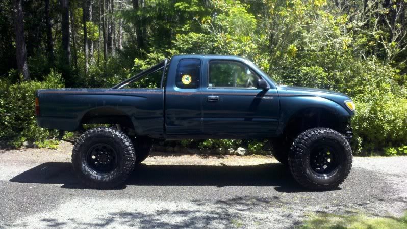

  13. Aug 31, 2012 at 10:03 AM
    #73
    erisman33
    Jun 27, 2011
    #58965
    55
    Pismo/Mendocino
    1995 Ton'd Taco
    Updated..... Pushed the front end forward and built a new hanger getting ready for bigger meats
    7A518E4A-BE35-4DF0-8253-1ABB33DF6F5B-155_c3d1005eb1092113f5fcdba83c242b01f0dc0e77.jpg
    :D
  14. Sep 3, 2012 at 3:32 PM
    #74
    Supra TT
    Supra TT Supercharged Lifter
    Jan 3, 2011
    #48645
    7,226
    Eric
    Indiana
    2000 SAS D60 F/R Supercharged
    Supercharged on One Tons
    Yeah you pushed that axle forward just a bit alright... whats your WB at now? It's sick!
