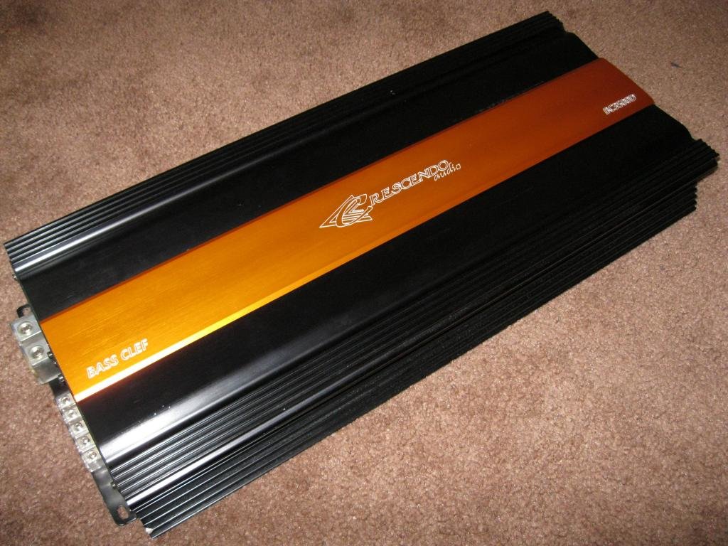

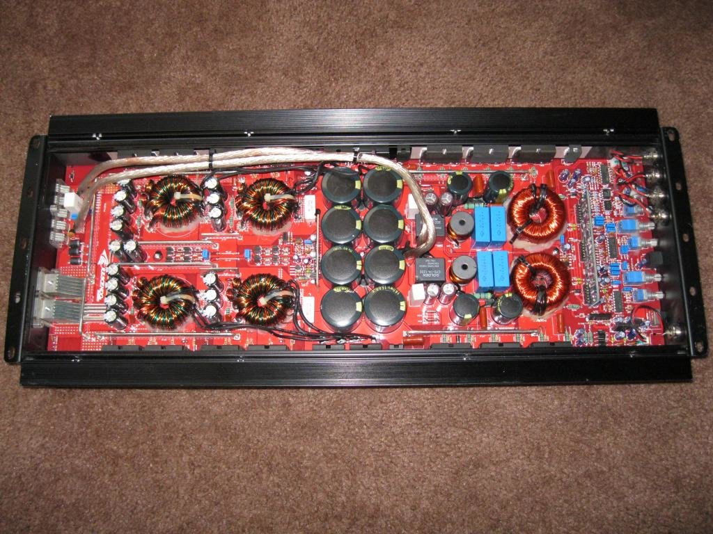

    One of the amps that I have now

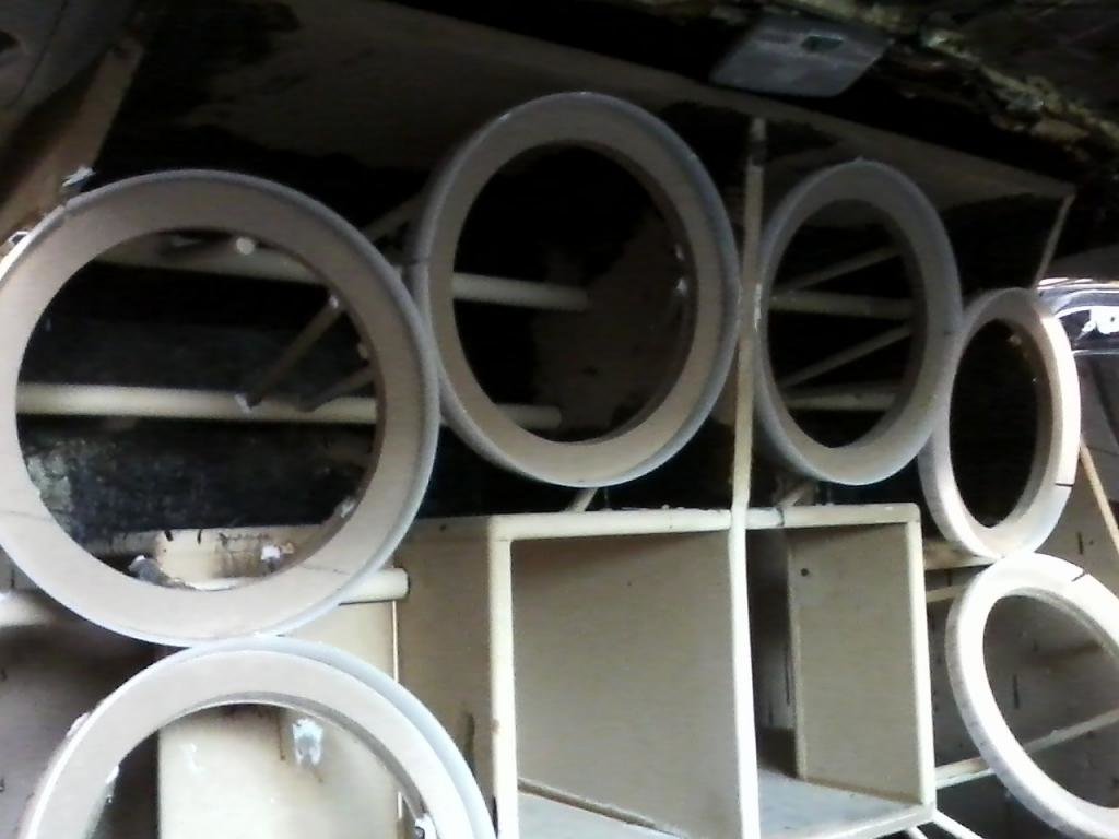

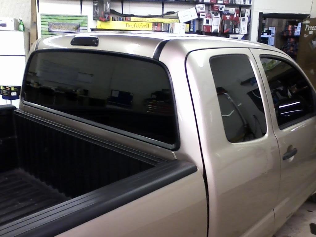

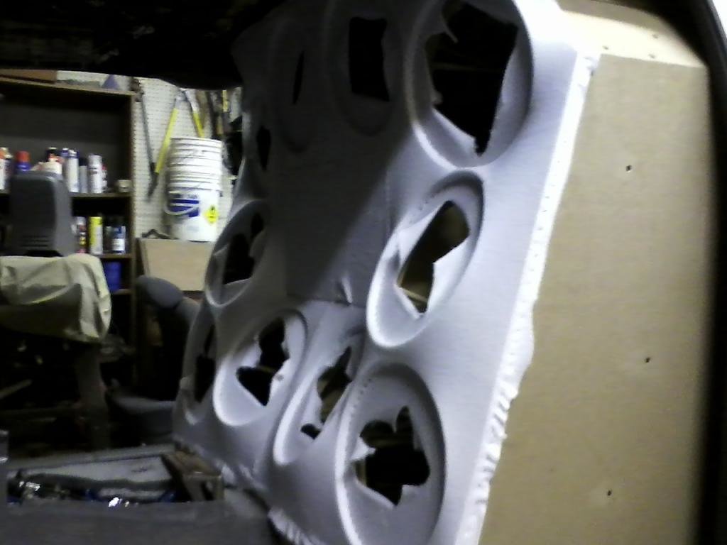

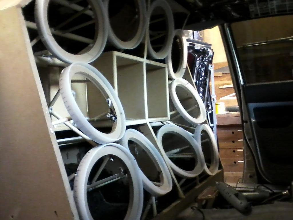

    I swapped out the slider back glass for a solid one
    Then I started on the box. I didn't take too many pictures of everything. The entire base is fiberglass and the perimeter was mdf cut out to fit the curves of the floorboard. Then I built up the sides and back piece from that to create a shell. The first picture is the base with packing peanuts to figure air space. As the build goes on it should make more sense. The box will be two chambers though and each one will be around 7.5 cubic feet after displacement. Total air space is 21.7 cubic feet before displacement. The ports will be tuned to 33hz with 99 square inches of port area or 13.2 inches/cubic foot.

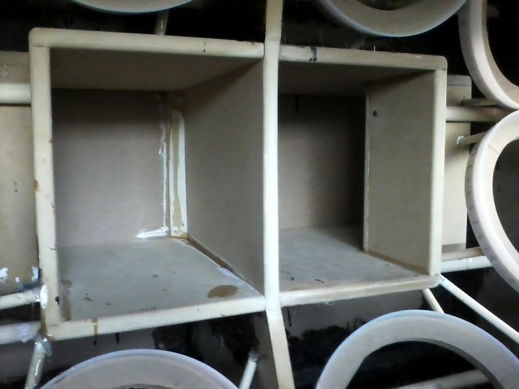

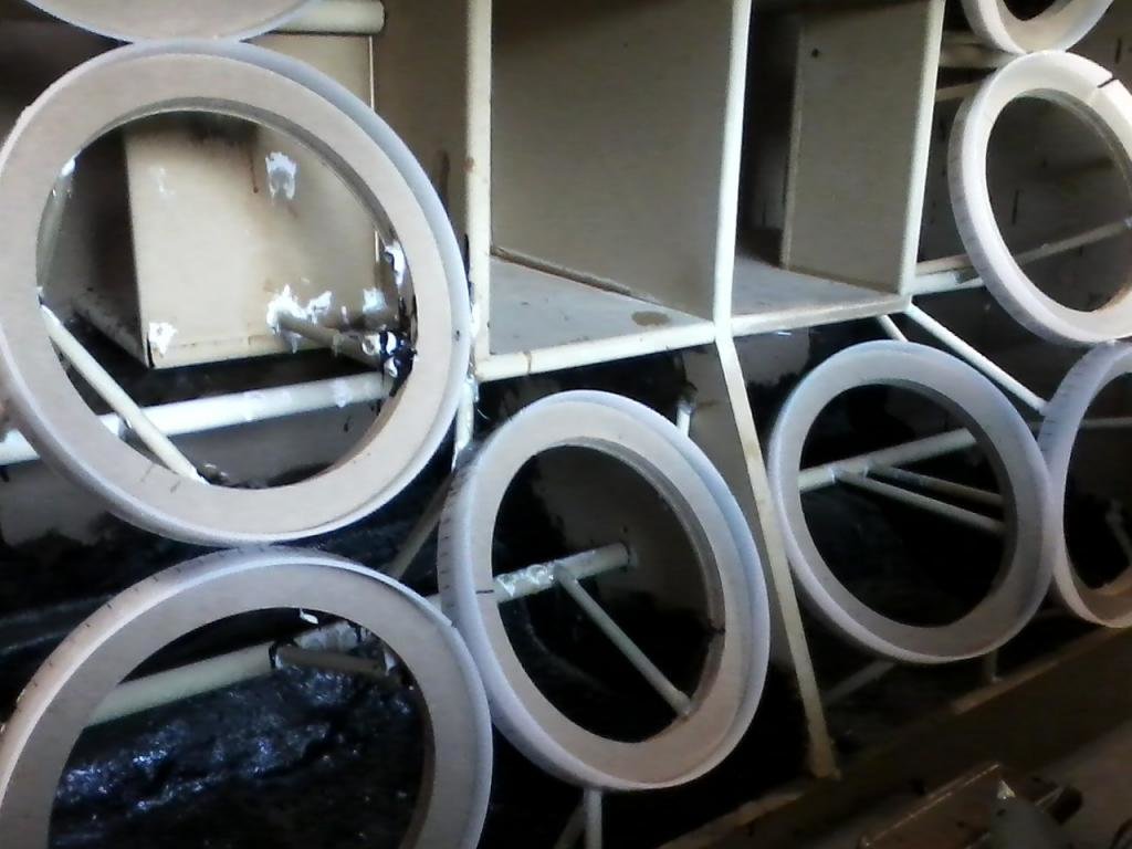

    I made the ports and got them in place. I also cut out all the rings and cut strips of ltp and wrapped it around the edges so the end result will be a flushed mount look. I also did some bracing from the sides and center piece with 1" dowels that I glued and screwed in place. I am going to figure out something else as far as the bracing from the front to back. I also spent a lot of time and got all the rings in position and then stretched formed everything with fleece and resined it. That brings everything up to speed. I don't have many pictures of the progress but I did take a few.

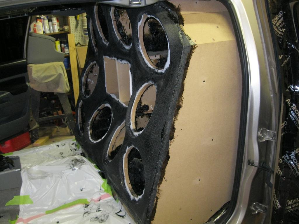

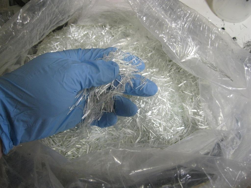

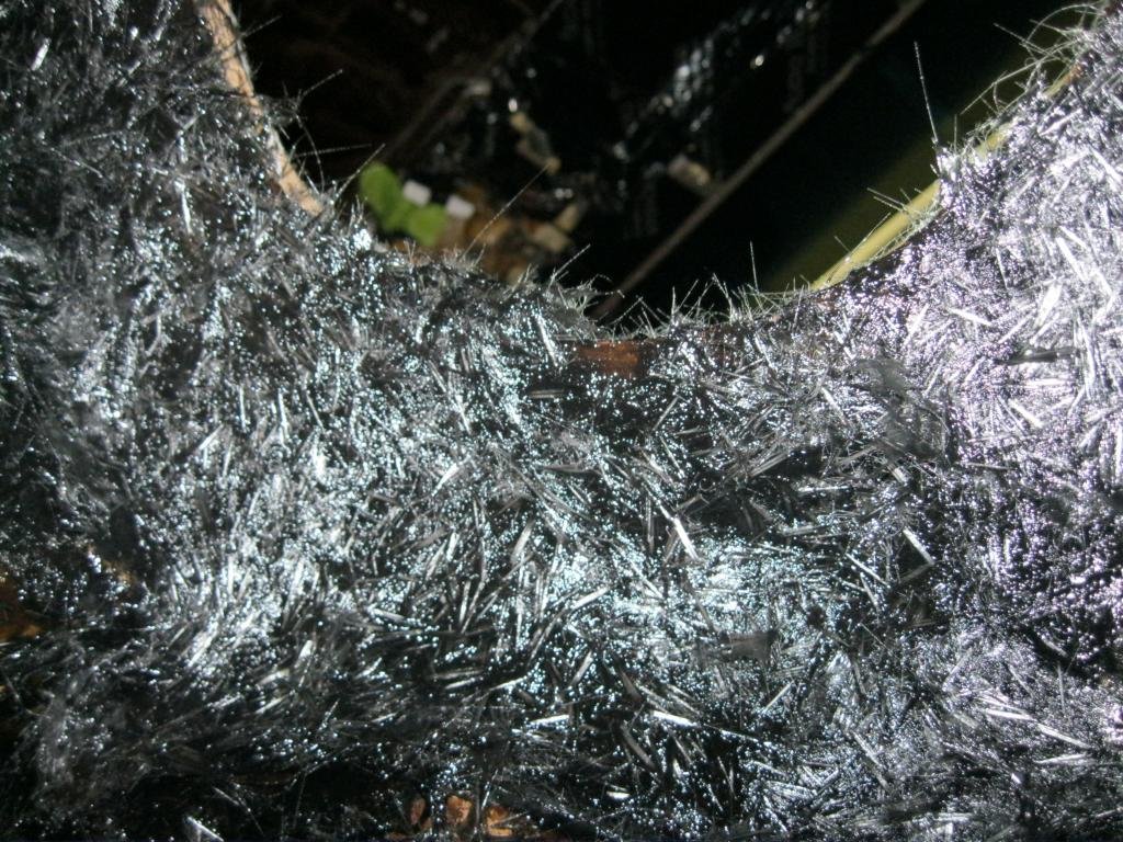

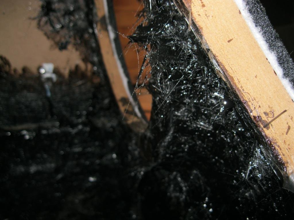

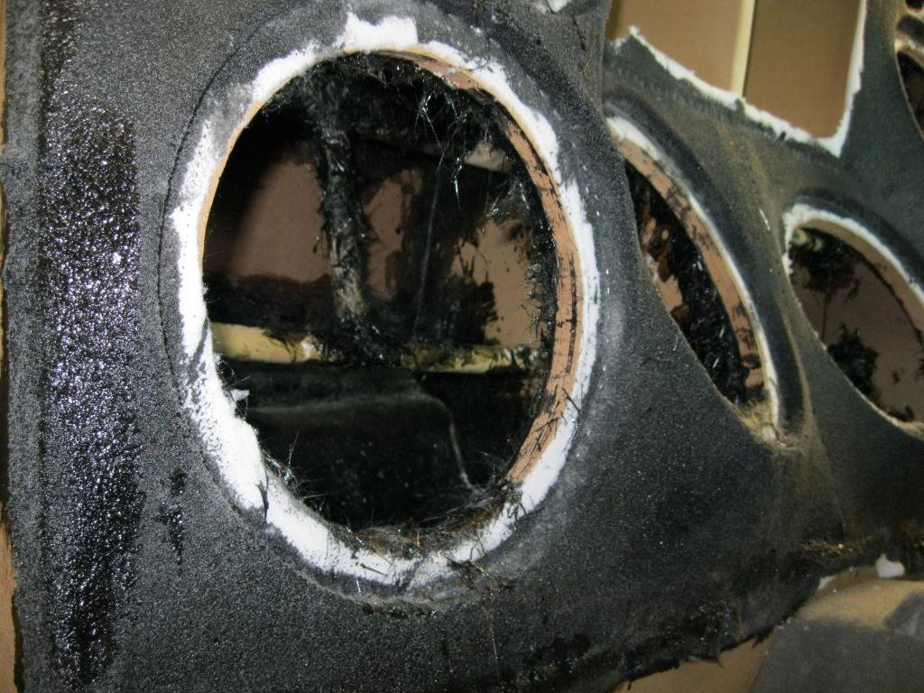

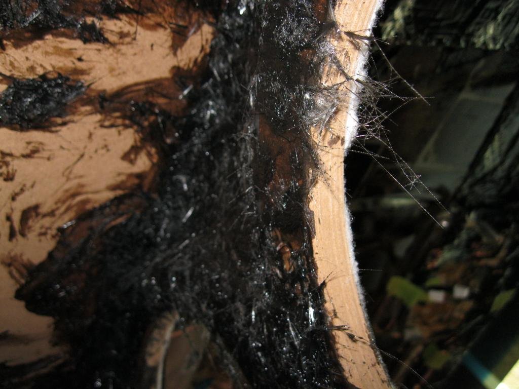

    I made some progress on this. I glassed the inside of the baffle using 1/2" chopped strand fiberglass mat from uscomposites. I had almost 11lbs of the mat and went through half of it and about 2.5 gallons of resin. I started off this build with 5 gallons of the 435 resin from uscomposites and now I am out of resin. I might get another gallon or two just to add more to the baffle and go over all the corners again. Where it is right now it is solid though. I cannot get anything to flex at all. You can see in a few of the pictures that I added braces to the bottom two braces to make them more solid. Overall this box is rock solid. Better to be safe then sorry.

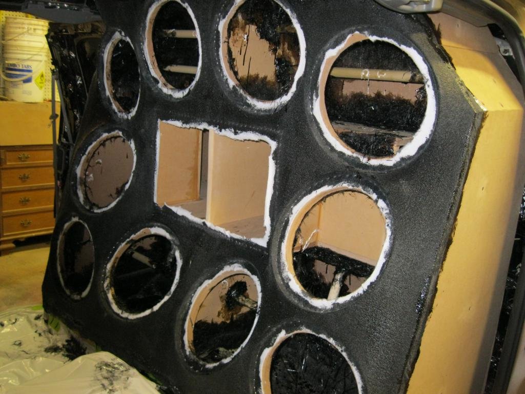

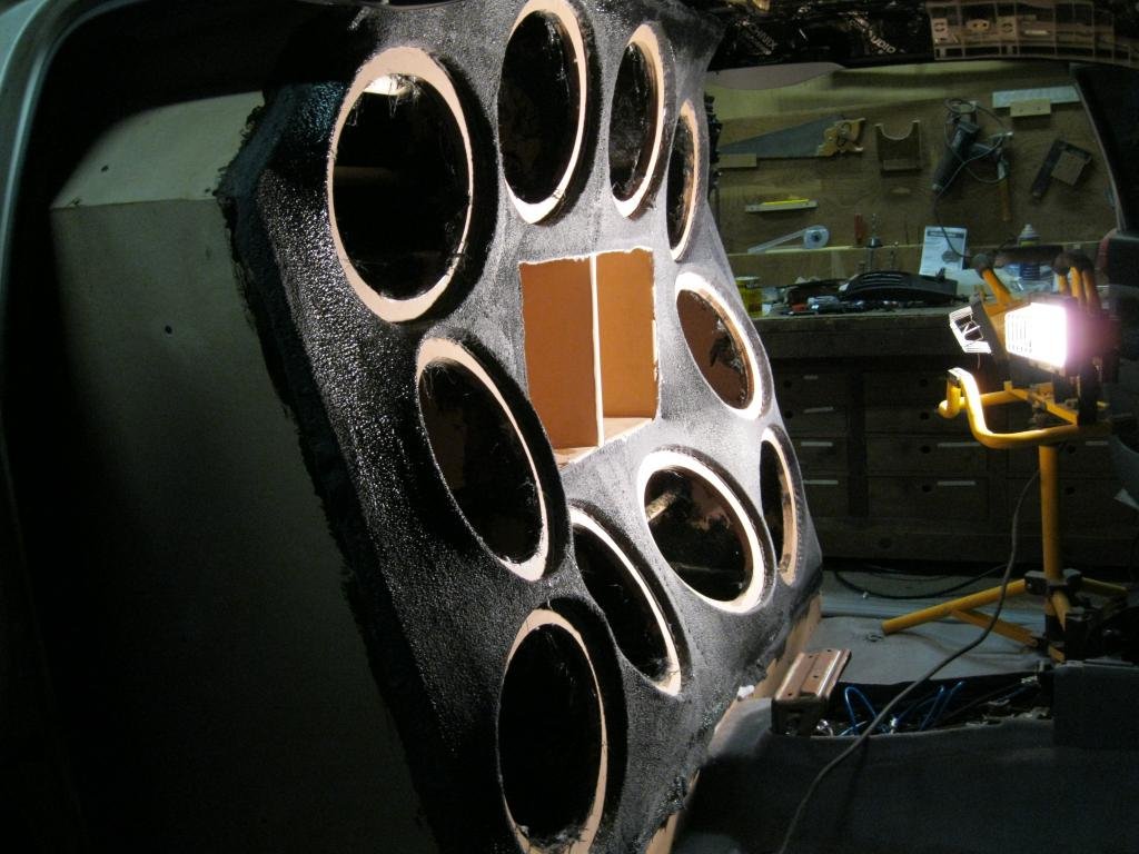

    I tried to get a few pictures from the inside so that you can see the fiberglass build up from the back.

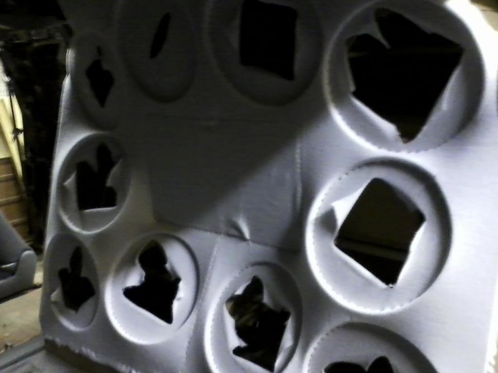

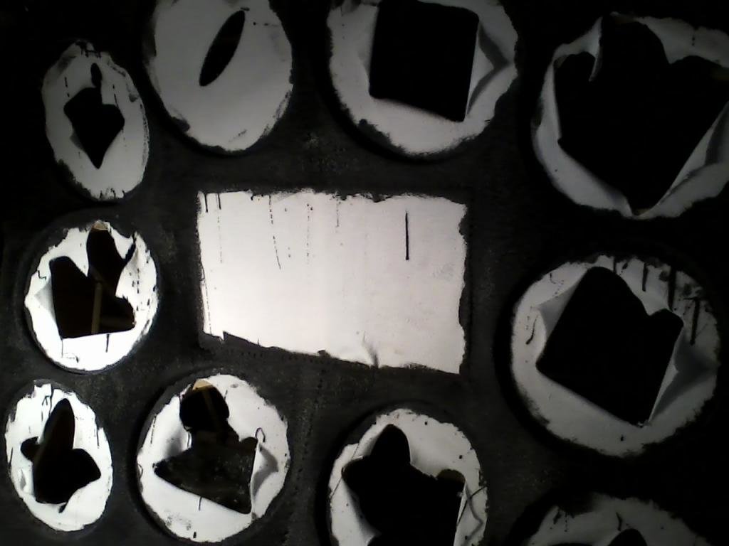

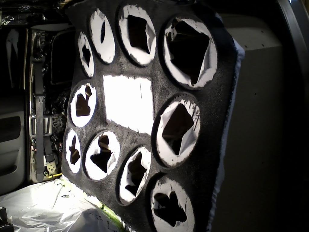

    Where I left it off for the night. Next step is to clean up the edges then mount the subs and wire up the one amp I have off the stock electrical and test it out. I want to make sure that the box plays the way I want it to before I go to the trouble of making everything look good and adding the batteries, alt, and second amp.
