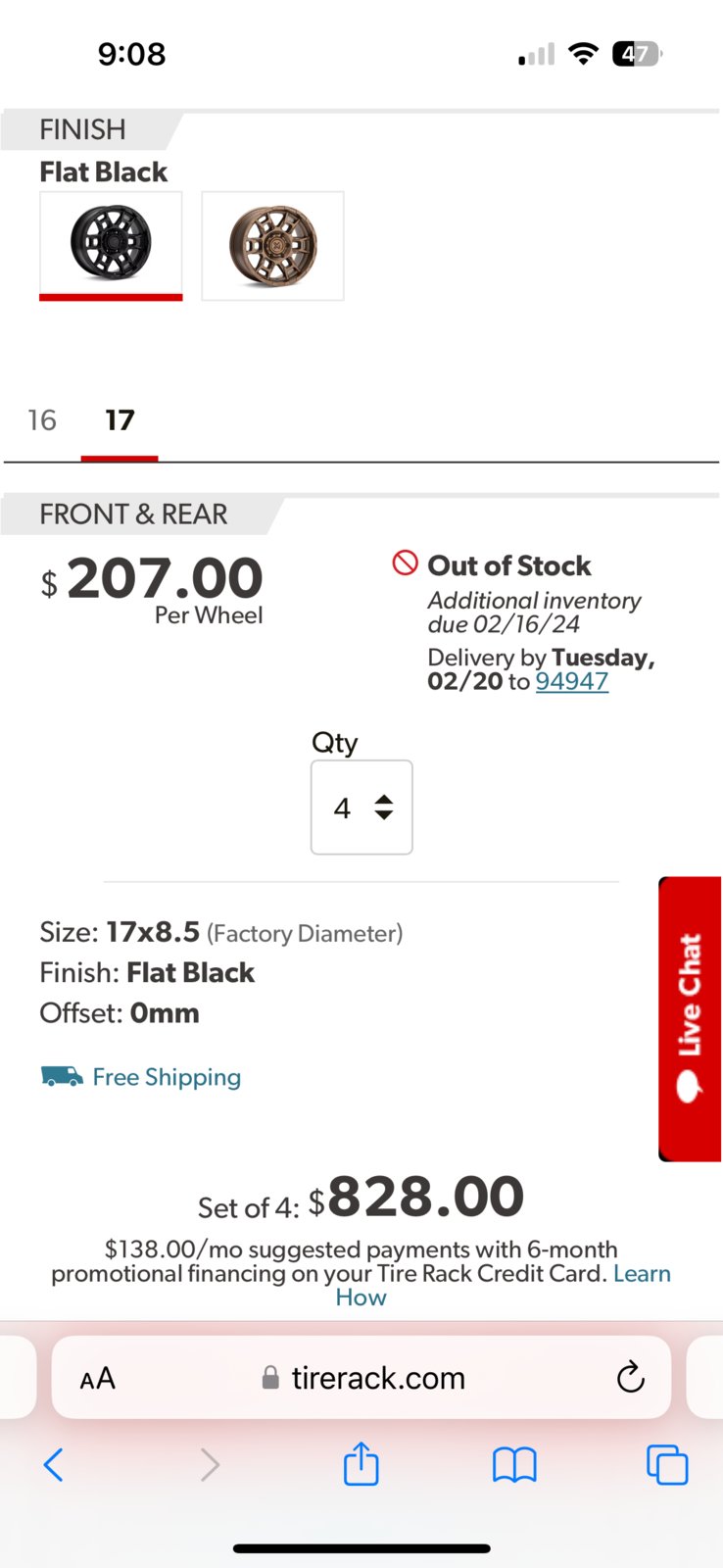

    Interesting. On America’s Tire website and TireRack 0 offset is an option

    I am using stock 16's...keeping the tire, but did find "X2268030106BF1" which is the 0 offset. I do like the poke though of the -10....just wanted to know if it will effect anything.
