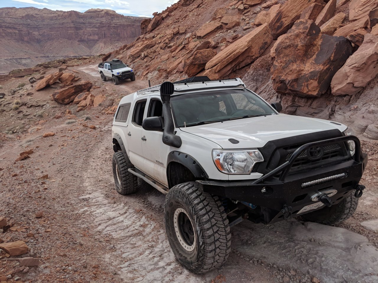

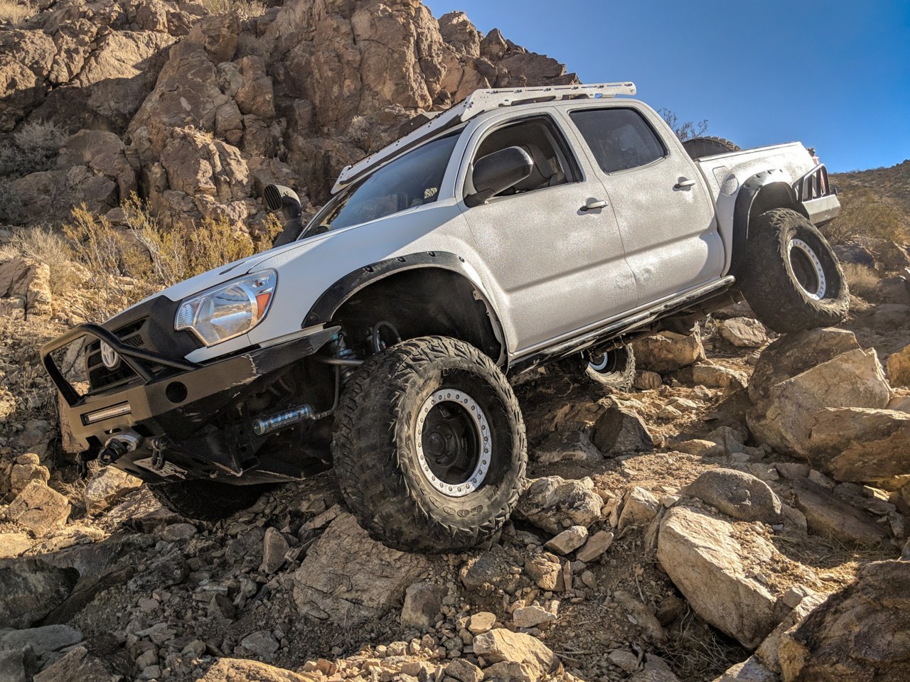

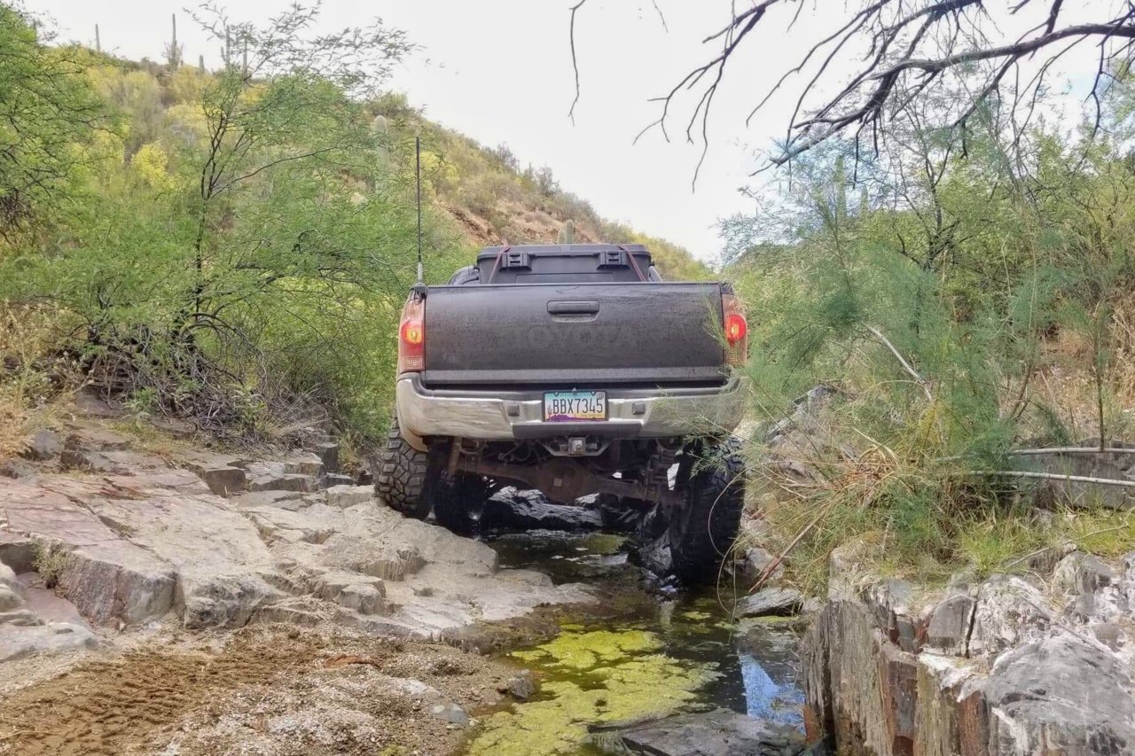

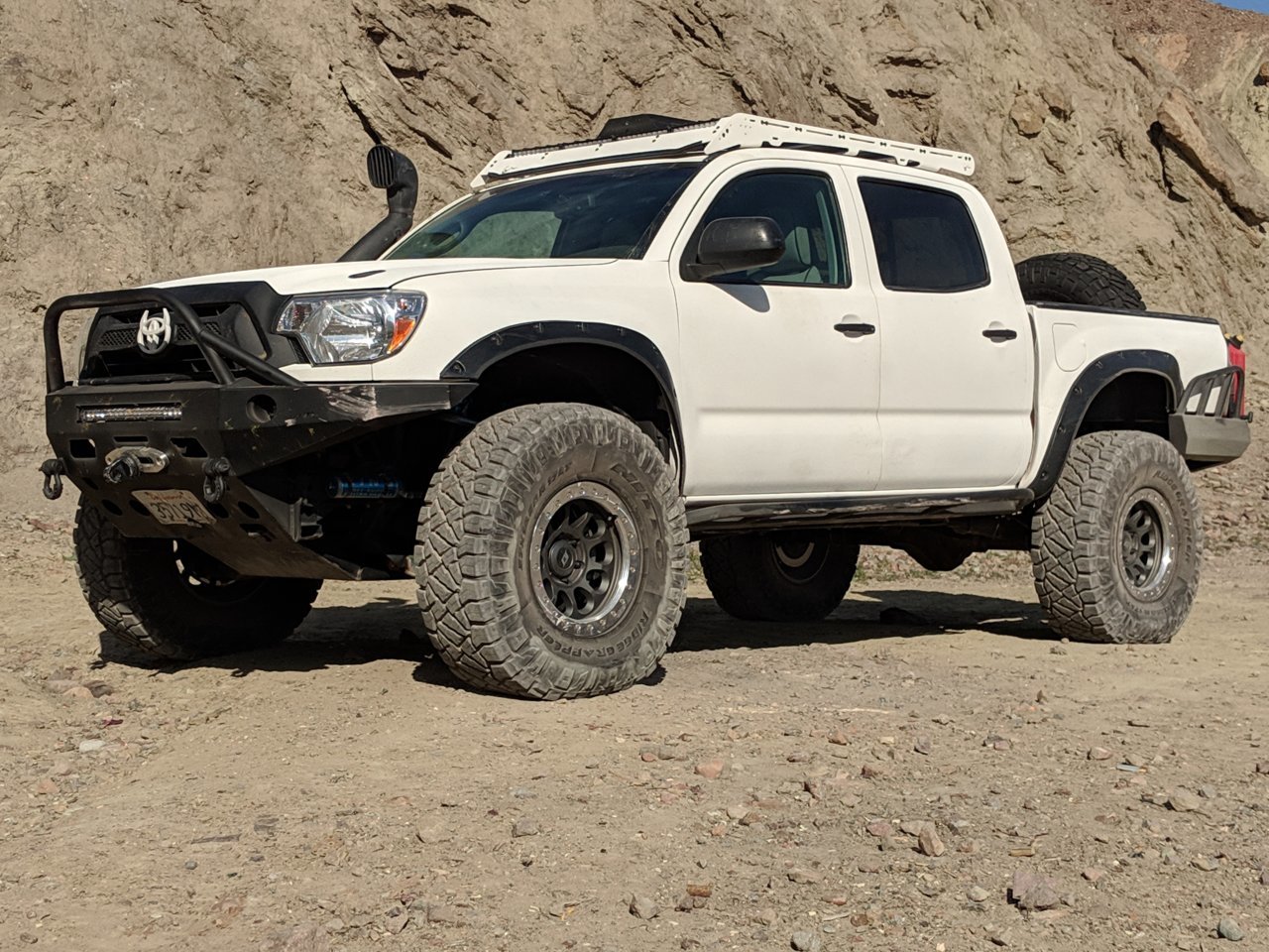

    It sucks not knowing who to trust since there's so many bullshitters in shops and on the internet. Good on you for following through with what I recommended and calling Deaver. You got the same response that I read someone else got. I wish I could remember where it was to reference it but can't for the life of me remember.
    Also I know it can be time consuming to check the folks who are giving you advice. You've actually gotten advice from several guys who have been around for a long time and have a damn good idea what they are talking about. @glorifiedwelder does suspension installs as a side hustle and @desertjunkie760, is starting to do it too. When @glorifiedwelder was giving you advice I don't think he knew you had a heavy ass truck, I'd bet my pay check he would have told you SUA isn't a good option for heavy ass trucks. I can't speak for some of the others but they all sound like they have a clue too. Myself, I've done a lot of research on here over the years, have dumped gag inducing amount of money in my truck and do the work myself installing and fixing broken shit, when it comes to "does everything, sucks at everything trucks" I've got a bit of experience.
    I wish when I was starting out with truck mods someone would have told me to follow folks who do what I intend on doing and see how they set up their trucks and live in the same geographic region. I specifically mention geographic region since different areas have different areas to offroad nearby and often folks trucks will reflect that. Also to pay attention to how hard they are on their trucks, how often they use them, and if they installed the parts themselves. There are a lot of clowns on Instagram that try to put on a good show, but in reality they paid someone to put on their parts, use their trucks 2 times a year, and have no idea how any of their parts work, and don't know how to fix shit if they break something. If you want to make good choices you'll have to figure out who the fakers and wannabes are and not put any stock in what they say. I had to figure this out on my own, sometimes looking like an asshat along the way.
    IMG_20190323_162107.jpg LRM_EXPORT_366232244683649_20181217_125328204.jpg IMG_20180917_175121.jpg IMG_20180402_142431.jpg

    No doubt. I think what really led me to believe it's possible is several factors. first of all was a conversation with Total Chaos owner. Guy has a fairly heavy set up with go fast running SUA and when they say it's possible I was like hm... ok well these guys know their stuff obviously. I will be calling the owner tomorrow and asking point blank how much wait and what sort of leaf pack he has there and how it's doing. Secondly I almost bought a truck that has a pretty similar stuff I was shooting for with give or take 200 lbs difference maybe I even test drove it and it seemed just fine, obviously I didn't have a chance to drive it off road or really push but there weren't anything that jumped at me saying this is wrong set up, here is a link: https://www.tacomaworld.com/threads/at-overland-habitat.543964/
    before he sold the habitat (exact same thing I have)
    Thirdly the shop that I'm working with knows I have a heavy-ish set up, again not sure if 1k lbs on the rear is classified as heavy but I assume it is. And when we were talking about different options it sounded like once again SUA was the way to go...
    All that said I was like g this seems like it actually can work lol :fingerscrossed: truth be told somewhere I'm still hoping that it still might but if Deaver says 500 lbs is all you get than hell I might be reshaping those packs every 500 miles :annoyed:
    You know I don't mind working on my own stuff and fixing things here and there but at some point I figured some things should be left out to the "experts" you want to trust people especially when you're spending a ton of money :spending:and saying this is what I have make the best out of it. Its pretty sad that you have to literally question decisions and doubt someone expertise. If I was on the other end Id be annoyed and fee disrespected if someone did it to me and questioned my expert opinion. Id probably just tell them to go somewhere else. At the same time if they wanted something out of me that I simply know is not achievable I would flat out tell that to their face.
    I am just a bit ocd sometimes:DI do like to really take care of my equipment and not abuse it. I'd use it but never push it to its limit, frankly after almost rolling my jeep off the cliff hanger I'm not sure if I want to push my equipment anymore. I also believe in having more than one may need be it the suspension armor/recovery etc rather than constantly braking something or having something that is somewhat reliable and will get you home. I did talk to glorified welder almost booked a job with him but it didn't work out he was too busy at the time and seemed like he wasn't all that interested in the job or the $. I'm pretty sure i've explained what my set up was and I believe he even sent me a photo of a job he did for a buddy of his with a camper and spring under conversion though but it's been a while so don't quote me on that at this point there are just way too many opinions in the pot:stirthepot:
    btw nice photos! I think my rock crawling days are behind me though. Looks like moab or Utah area? Also that road with sun set and aspenlooks like sierras or rockies ?
