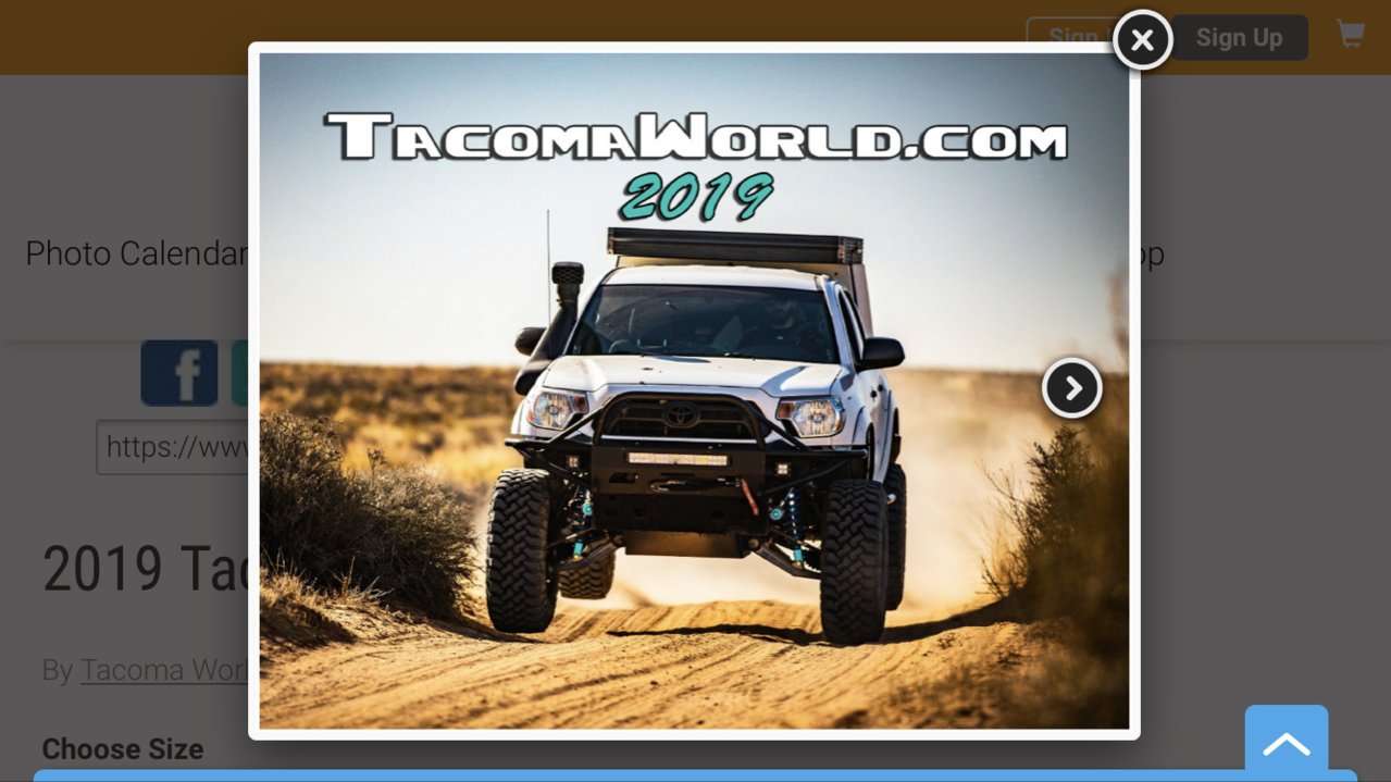

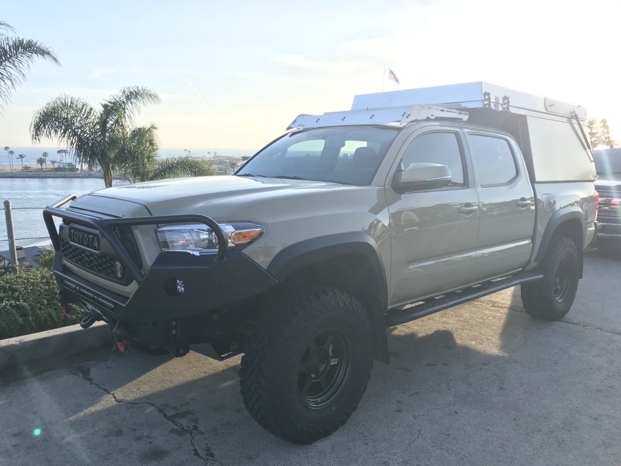

    Doesn’t look like you got any weight in it. What leaf pack did you go with ? I have a heavy girl. AF0FD847-8E11-40C5-AE36-2262CA00230F.jpg

    Nice proper.

    Someone needs to tell him he is too heavy :D
    This is inspiring hope ... well maybe just a little :anonymous:C39233A2-DBE1-4207-88E9-375CFCF62675.jpg

    Are you familiar with his build? He's not SUA. Anyone know Jims TW handle? I know he is here but it's not his social media tag.

    I’m not was hoping to find him/ see wha sort of built he has. He is LT in the front looks like ?

    TC +2" in the front and custom Alcan in the rear. His build is here, not sure what his handle here is.

    As already stated Jim Bob is SOA, not SUA. You cannot find him because he deleted his account on here. I think his build is on his own personal website now. AFAIK he doesn't drive like that all the time, jumping it was was for some action photos. If you do a lot of "high speed" desert driving your truck will start to fall apart, ask me how I know.

    Jim’s weight was also a lot lower than yours in this pic. His truck is heavier with the new camper. His truck definitely lacks rear suspension, but i’ll be helping him start improving on that in two weeks. It does currently have Allan springs, but the goal is to eventually run a set of custom u402 deaver springs.
    The other thing to keep in mind is, you’re looking at a still photo. You’re not in the cab to feel the landing. Go follow trophy burro on Instagram, he’ll show you that you can do this with any vehicle.

    He hasn't gone with a relocation in the rear yet has he? Last I say his truck I think it was still OE mounted shocks in the rear.
