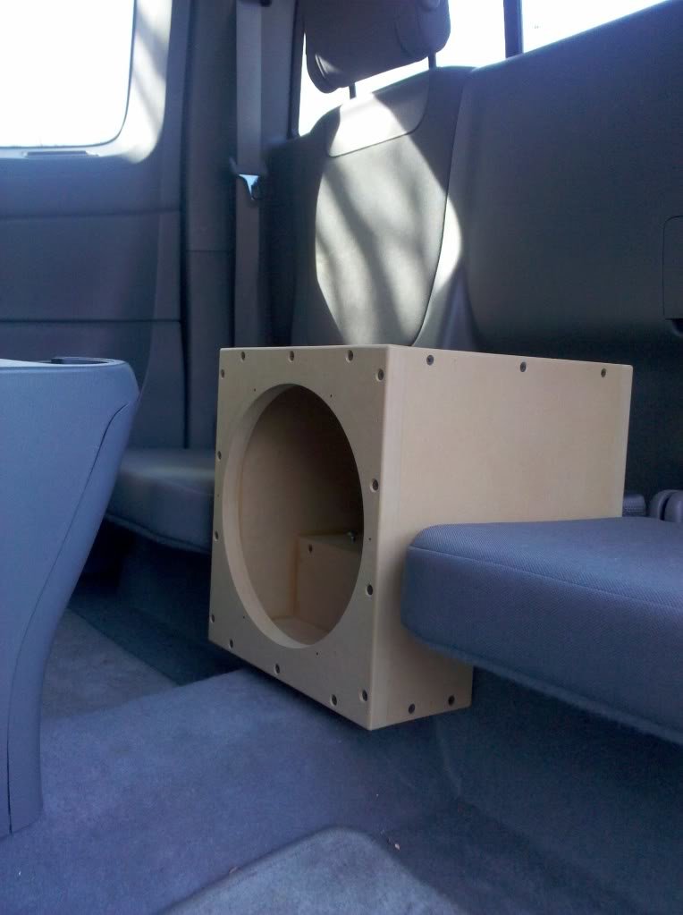

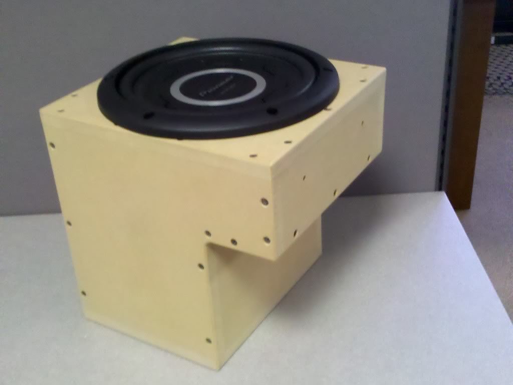

    This started out as a thank you note to Mr. Marv but as I wrote it, I realized I should share it with others. I've mostly completed an audio upgrade in my Taco. I wanted good sound. I did not want to rattle windows and wake sleeping babies on my street. I didn't want to cut or modify any original equipment or truck panels irreversibly. I think I got what I was looking for and am very happy! Pics shown below are of the sub enclosure since that was the most difficult piece of the puzzle, in my opinion. It replaces the rear console on 2010 and up Taco Access Cabs as a direct bolt-in replacement. So here is my slightly edited email to Mr. Marv...

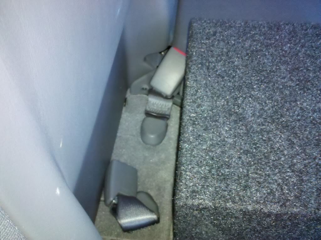

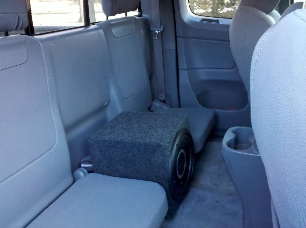

    The correct sub enclosure makes all this work. Literally, I've been messing around for about three months trying to decide on the right configuration. One set of speakers? Two sets, no sub? Two sets and a sub? One set and sub? What amp to power it with? What fits? And the sub enclosure had to meet a strict set of criteria: NO PERMANENT MODS to the original interior (no cutting, etc.), SMALL, and COULD NOT INTERFERE WITH REAR AREA SEAT USAGE AND SEATBELTS. Mission Accomplished thanks to Mr. Marv and his recommendation for a 10" shallow mount sub.

    Pioneer Shallow Mount 10" sub was $105 on eBay. Model TS-SW2501S4.
    Custom Sub Enclosure built by Mr. Marv for $150 plus shipping. For anyone who doesn't know, he's a cabinet maker with a severe audio interest. His stuff is second to none.
    Wiring, etc. is extra but the above costs represent the big ticket purchases. I carpeted the box myself. All I can say is it is passable but if I ever had to do a second one, it will be a much better job. All new wiring was run - the stock wire harness plugs remain intact and now unused. Easy to put back original equipment if I ever want to sell the truck.
    Anyway, I'm tickled enough with the setup to pass it along. The sub enclosure takes up less space than the original console did!!! Now, lemme see if I can upload a couple of pix.

    Looks good.I like those alpine pda amps.Small with lots of clean power.Whats the volume of the box?

    0.45 cu. ft. Small but that's the published optimum air space volume for this sub. It has some sort of double diaphragm that eliminates the traditional spider mechanism in the sub. I can't tell you if it hits as hard as a traditional 10" sub since this is my first subwoofer. I can tell you that, for me, it puts out plenty. The truck mirrors (rear and side views) vibrate when the volume is up. Probably in part from the mid bass speakers but plenty from the sub itself. I can tell because I can fade the head units completely to the rear channel (there are no rear speakers) so all you hear is the sub.

    PS - a quick update on the system... I couldn't be happier. This shallow mount sub, the amp, and the speakers all just rock. Plain and simple. Plenty of deep bass and a great, clean sound. It is a really great solution if you don't want to sacrifice any space in your access cab, don't want to permanently modify anything, and want the best bang for your buck. We may disagree on speaker choice, but the amp and sub combo really shine. No regrets.
