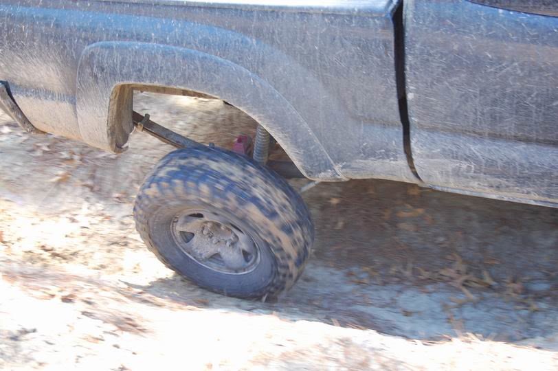

    You need new bumpstops with that shock because not only is the shock longer collapsed but the adapter to run them also adds length but on the other end you get miles of droop.
    Note the custom bumps. You can either go timbrens or chose whatever other one you want and weld it on there. You will need new brake lines as well. I'm not sure if a 1.5" aal will give you enough up travel. The truck pictured has about 3" till the bumps touch but they give a ton more than the rock hard stock ones. He's running a 3" all pro pack.
