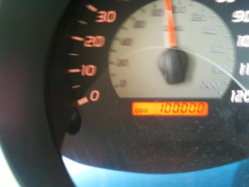

    My '09 DCLB TRD Sport pyrite mica Prerunner just turned 100K today and I couldn't be happier with it. Changed the serpentine belt and plugs at 90K. Change oil with high mileage oil every 5K. Kept up with all regular maint except radiator and diff fluid change; not sure I really need this. I don't tow (yet), and it is my daily driver. See my sig for mods. Anything to look out for?

    100,000 that's great, when you make 200,000 get back to us.
    That will be something to crow agout.
    The last truck I owned had over 200,000.
    These trucks are more than capable of going over 200,000

    100K is 'Just Broken In'.
    Call us back around 250 ;)

    100k miles is nothin!!!!
