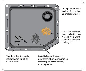

    The first method is called a drain and refill. This is an accepted method if done regularly, usually every 20-40K. Then between 100-150K, replace or clean the ATF filter. The next two procedures flush the transmission, removing up to 95% of the old ATF. The general recommended mileage for a flush is 70-90K, and replace the filter at the 2nd flush. But, you can certainly replace the filter at the first flush, especially if the old ATF comes out dark, or you notice metal shavings in the fluid - see charts below.
    The OEM method (from my 2007 manual) is to inspect the ATF every 30K miles, or replace the ATF at 30K if the truck falls under "Special Operating Conditions", aka severe duty usage, such as towing, off-roading, etc... Toyota does not provide a procedure for inspecting the ATF, or replacing the filter, but if you want your tranny to last, replace the ATF regularly, either drain/refill or flush.

    Dropping the pan on the first change allows the pan magnets to be cleaned and inspected as well as changing or cleaning the filter/screen. This is good to do on the first change since the most wear happens early in the life of the transmission.
