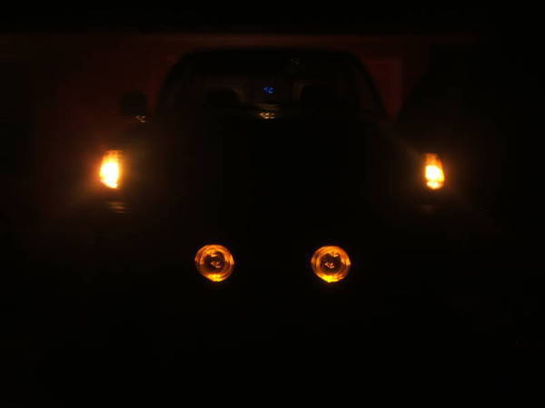

    Parking lights and "halo" rings on:

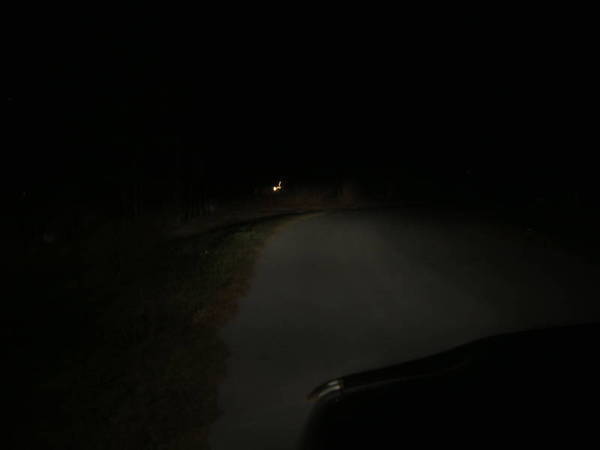

    Shot down the road with just high beams (SilverStar Ultras):

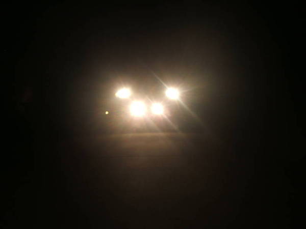

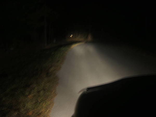

    Same road with high beams and off road lamps lit (the reflections way out are windows on a house about 200 yards down the road):
    And finally a shot of the front with high beams and off road lamps lit:
    Pictures really don't do them justice, but you can get an idea how bright these are.
