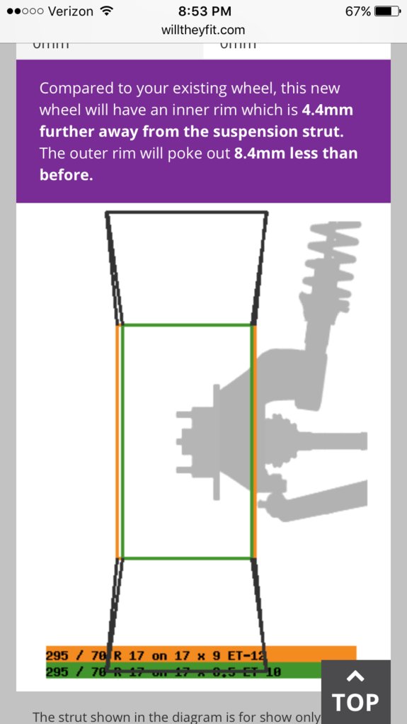

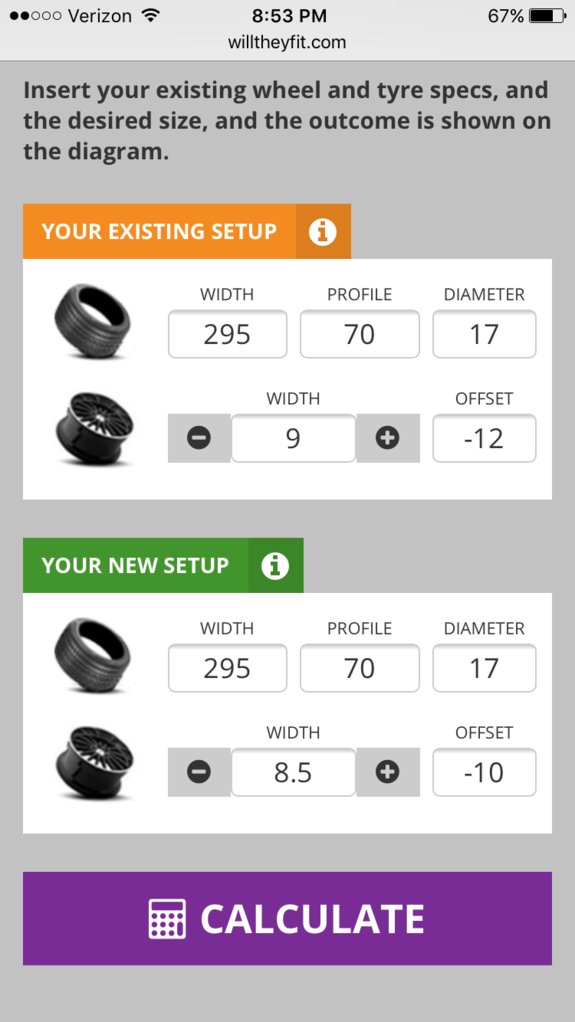

    so if I got the SCS Stealth 6's 17x8.5 4.30"BS -10mm and put my current 295/70r17 tires on, would I have issues?
    (I have CMC and inner liners trimmed)
    (current wheel is 17x9 -12mm, no rub)

    Looks like you'll be just fine.

    Ive even looking for something exactly like that program, thank you!
    Looks like I can pull the trigger on some wheels
