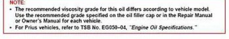

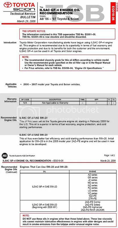

    2006 from the TSB.

    Ok, so use the oil in the repair manual or filler cap, no?

    I’ve never seen that TSB. But I can confirm that my 1GR had run on 5w-20, 5w-30 and 10w-30
    I don’t live where it gets extremely cold.
    I kind of go by, I would rather have some of the wrong type, that none of the right type.
    I’m not Mechanic, but in my experience, I’ve seen more damage done by lack of lubrication and maintenance, then the wrong oil type.
    I don’t have an opinion of what one “should” use. I typically recommend what ever the manual or oil cap says, if I have to go give an opinion.
