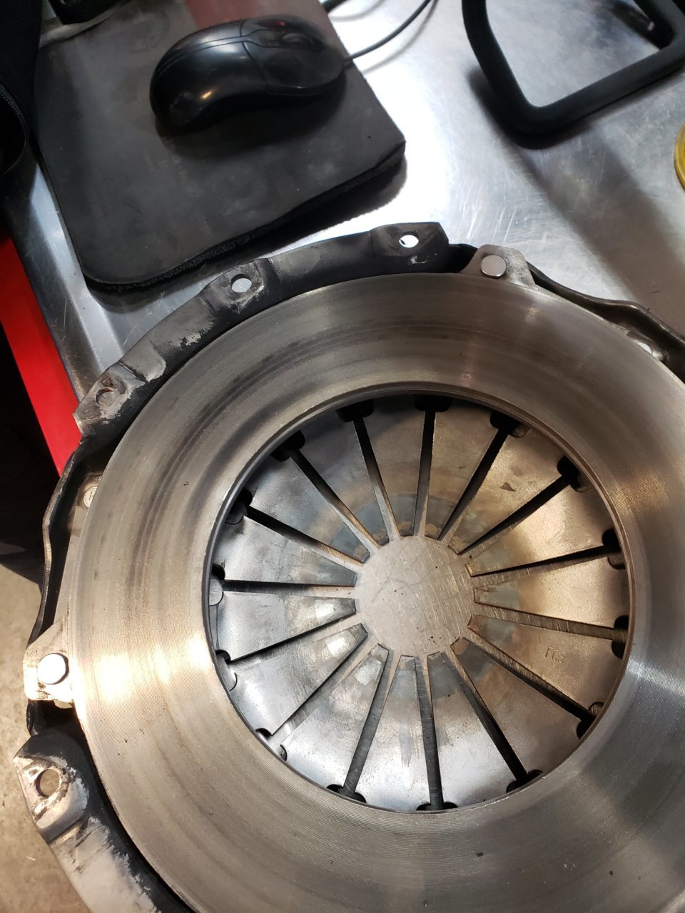

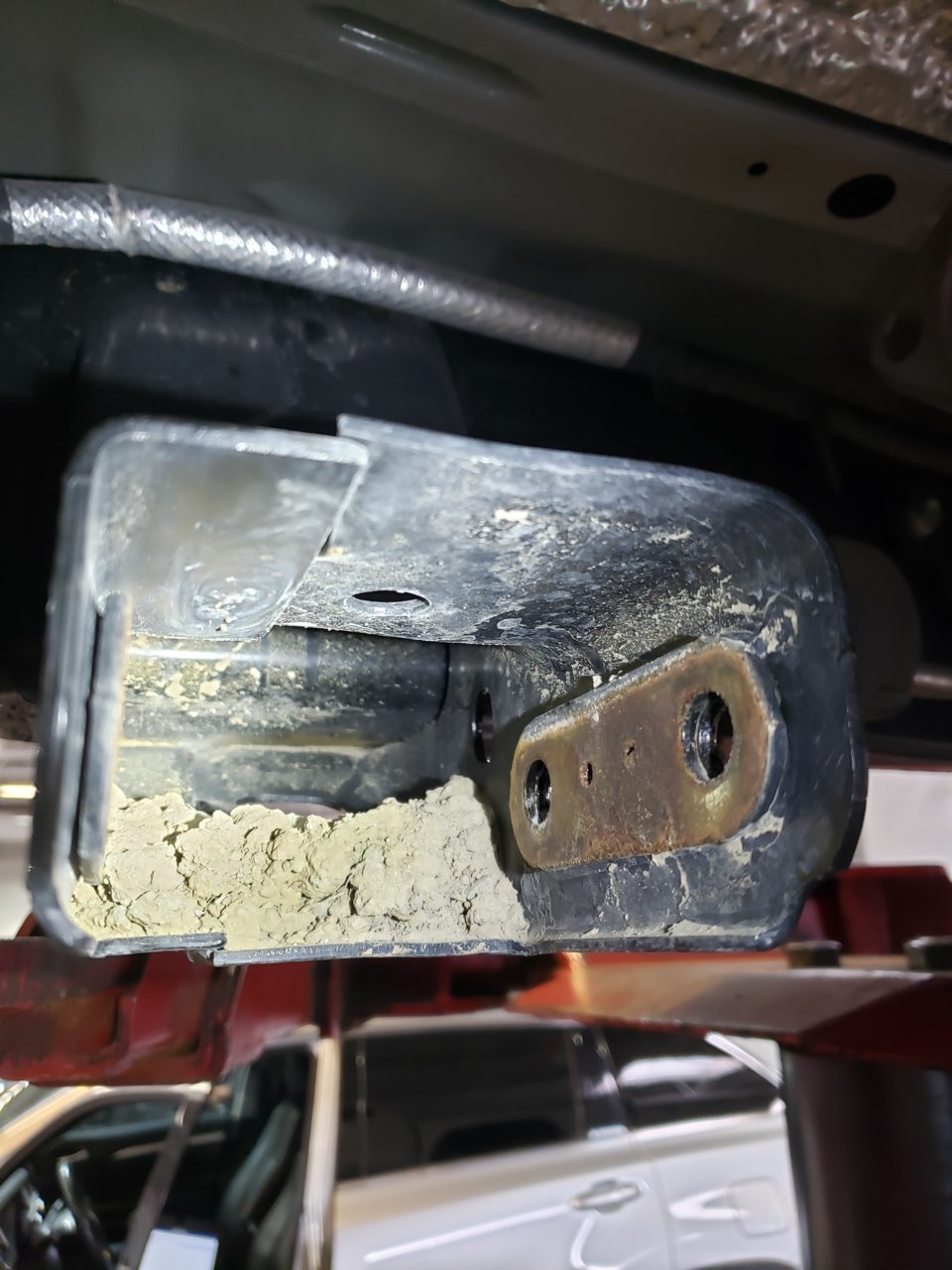

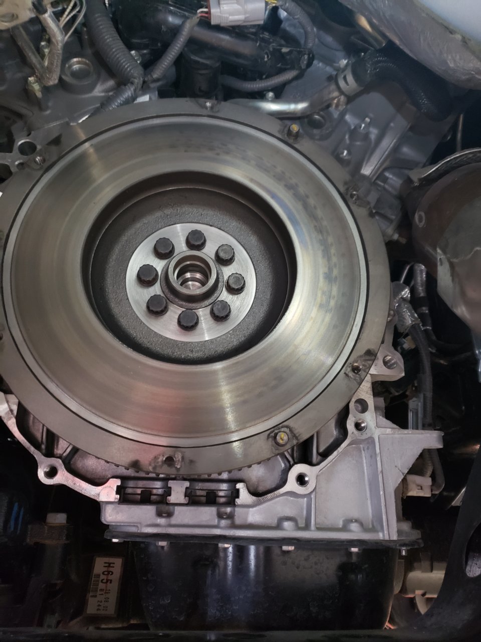

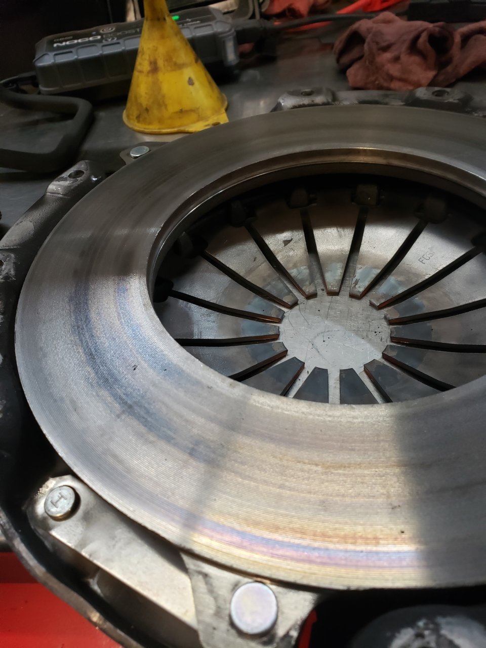

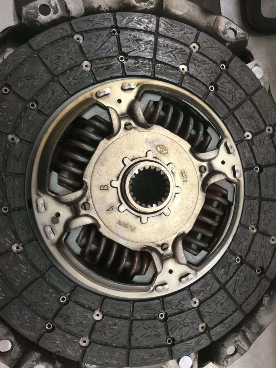

    The pictures the dealer sent me. With my factual story. One night on my way home in the clutch pedal i felt it pop/crunch nothing bad happened after. The next day or soon after I developed a loud vibration sound in the pedal. After two squeaky clutch service TSB nothing fixed it. The last time it lasted a day then suddenly became worse. The clutch was completely loose and started to stick to the floor and slip significantly.
    Toyota corporate set me up with a truck rental and said the truck would be completely covered under warranty. Then I get a call saying I had to agree to 1600 clutch job if they could see hot spots. Well I was forced into it.
    Today the guy called saying well it has 4inches of "mud" under it so we think you had it stuck and that caused the issue.... he tried to say the mud did it but I quickly called bs on that. I became super annoyed that my integrity was being questioned. I knew this would happen and I even told Toyota it would. Me vs everyone. I was told the parts would be sent out and looked at to decide how they failed... nope the dealer pulled it apart and said you do it.
    I guess a TRD off road isn't made to go off road, or if you own land and use it for simple work you void a warranty. The dirt that he called mud is from dirt piles in my back yard.
    Picture of my tractor moving the dirt around. I was teaching him how to run the machine.
  14. Nov 11, 2020 at 3:32 AM

    92ehatch Well-Known Member
    Jun 9, 2019
    #295818
    841
    Kinley
    Hendersonville NC
    2019 Cavalry Blue DC TRD OR 6MT
    That clutch looks ok to me.
    I see heat where the throw out bearing touches the pressure plate springs.
    sivill[QUOTED] likes this.

    Thay seems all normal to me.
    Maybe the dirt got in there and wore some grooved in shit? But I don't see it..

    My only crappy advice is:
    -- How stuck could you have been and not have dirt / mud caked everywhere and still 'damage' the clutch? Looking at their pics, the underside looks pretty pristine other than some dirt in that crossmember.
    -- Also note that if you 'were' high centered, there is incredibly little abuse that you can do to a clutch. It is more likely to do something on firm ground (pavement) or bogged (no evidence of that).

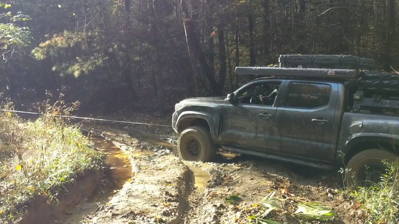

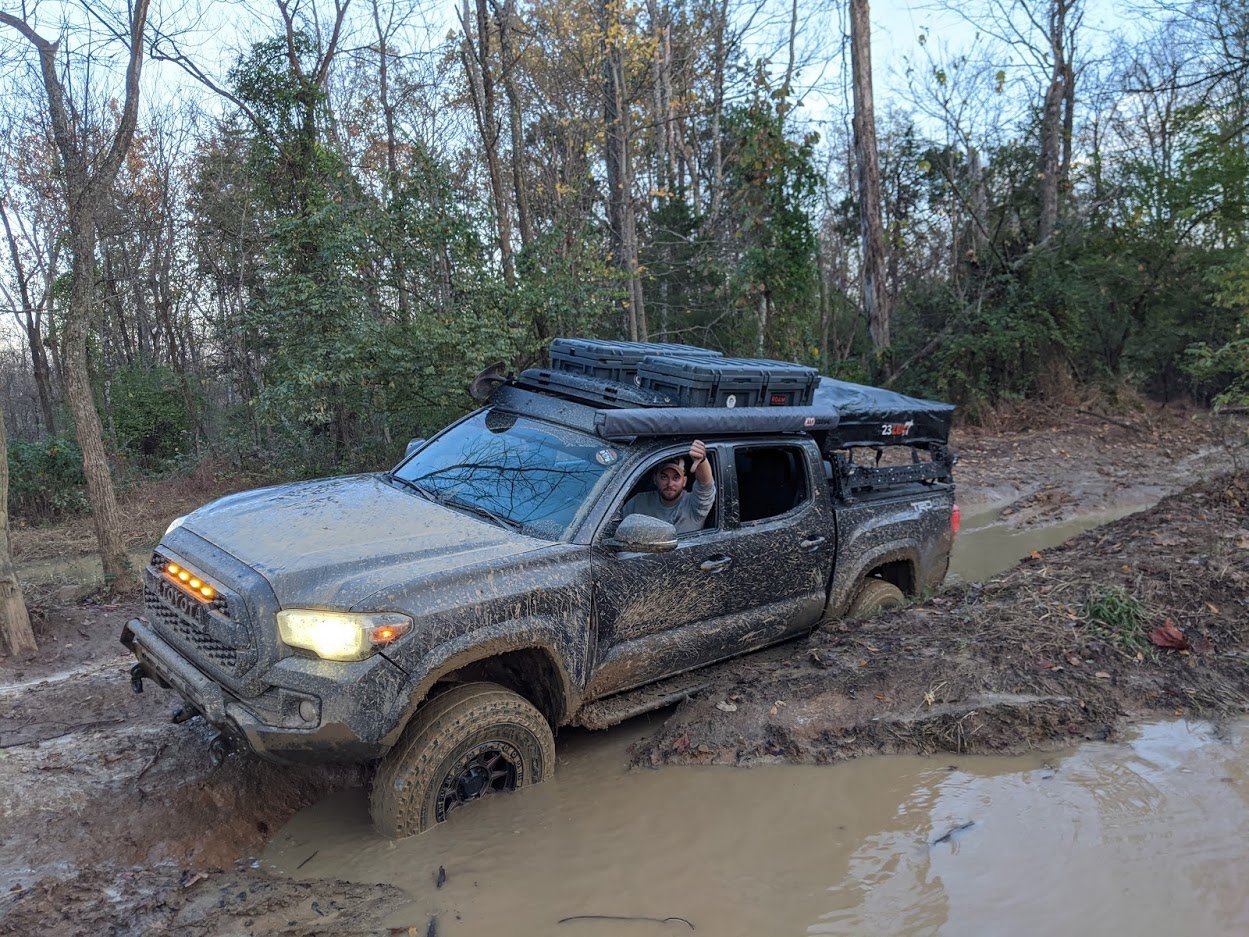

    I high center myself on/in mudall the time, but i'm also using RCI full skids.
    Proof:
    inDMriHHDoq7fzCJ6ZMBSSbfsR5b3qeZlIJPzPN__cfb8598b6bc69571ceecbeeff0b9a7bb98e623ed.jpg
    H98_MdiDpirlFQmZWiwlWJpxhbqVMVgnPZBnRIML_d1d153fd950b0a5d25b4c86fdbb8f6920bedb60f.jpg
    I'm terrified to get mud into my clutch assembly though that hole covered by the little black plastic cover. i can't find a picture.. but it's on the drivers side on the outside of the clutch assembly under the truck. If that little thing falls out and i get mud in there, i'd be hosed.

    tonered bartheloni
    Sep 25, 2017
    #231055
    31,195
    tony
    Lynnwood, WA
    That is what I am saying about @sivill 's pics. If he was high centered in dirt, no issue since you have zero torque going to the wheels. If he was bogged, there would be mud in places that could not be cleaned.
    All dry clutches have vent openings. You don't want to seal them. Moisture and heat need a path out or you will have other problems.
