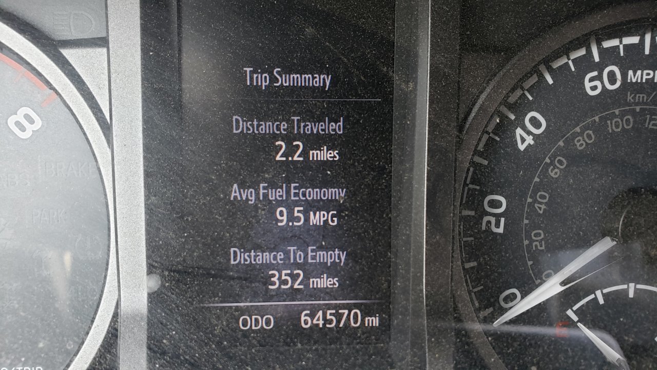

    So I took a short trip today to run errands and tracked my trip meter. Normal traffic situations, one 45 MPH stretch and the usual city driving got me the following. Now I am lifted and on E rated 33's, but the point stands. Only in town and 11.5 MPG is certainly possible with no highway driving, even with a stock truck. Especially in a Major metro area. Air temp was 43º and tire psi was 39.

  10. Feb 28, 2022 at 1:26 PM
