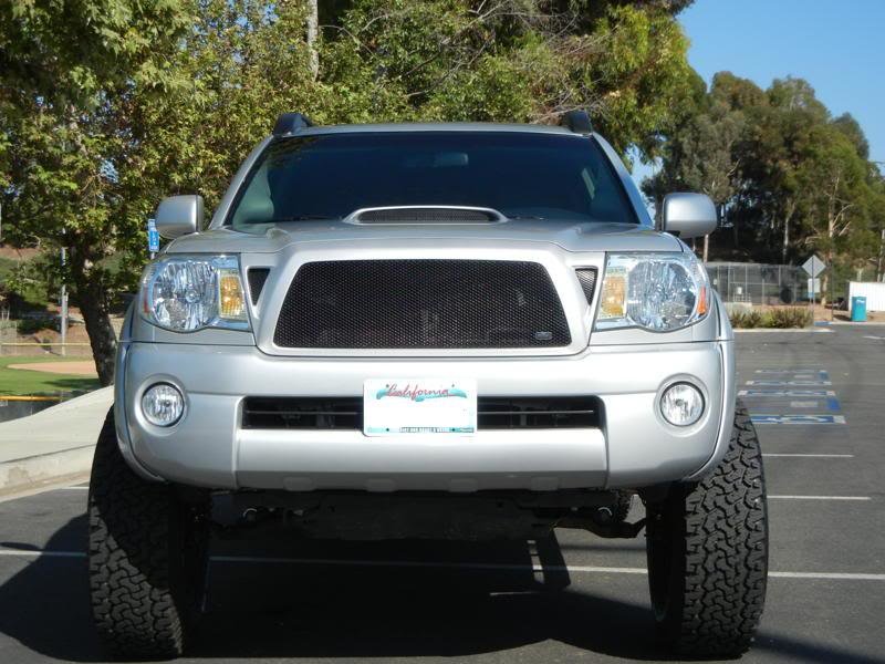

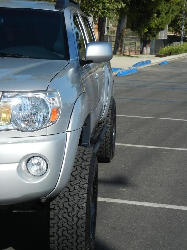

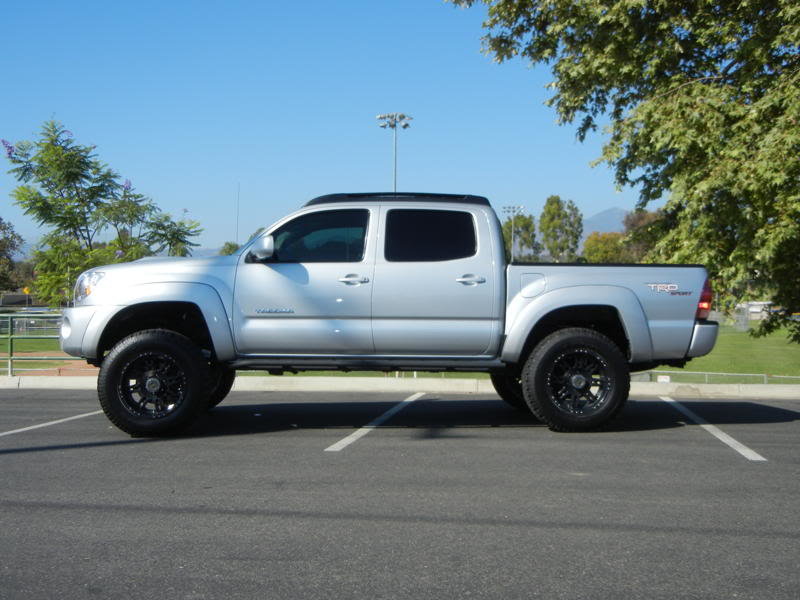

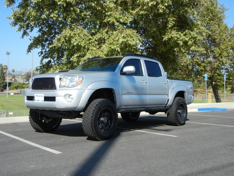

    Here's mine now finished with Camburg spindles, 5100s all around (front @ .85), Deaver Leafs in the rear, and 285/65/18 BFG KOs.
    Side view where you can kind of tell the front is wider than the rear. You can see the rears are even with my sliders, the front is wider than sliders.

    Looks great bud, what grill is that? Are your tires quite? And did you have to do any grinding on the spindles to make them fit?

    Also, what kind of sliders are they?

    The grill is from Grillcraft.
    The BFG KO tires are pretty darn quiet for being as aggressive as they are. The mud terrains look really cool, but they wear quick and are loud.
    Camburg did the install, so I don't know if they had to grind on the spindles.
    The sliders are from Demello. I really like them. Their clean looking and fend off door dings.

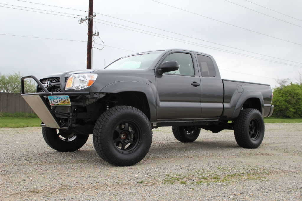

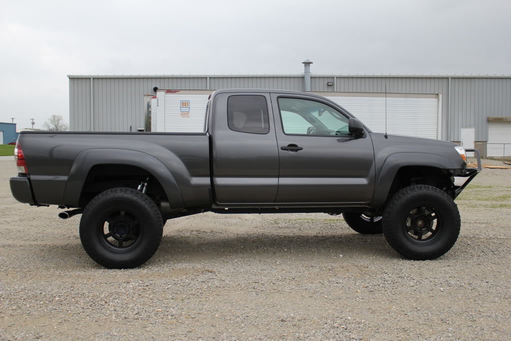

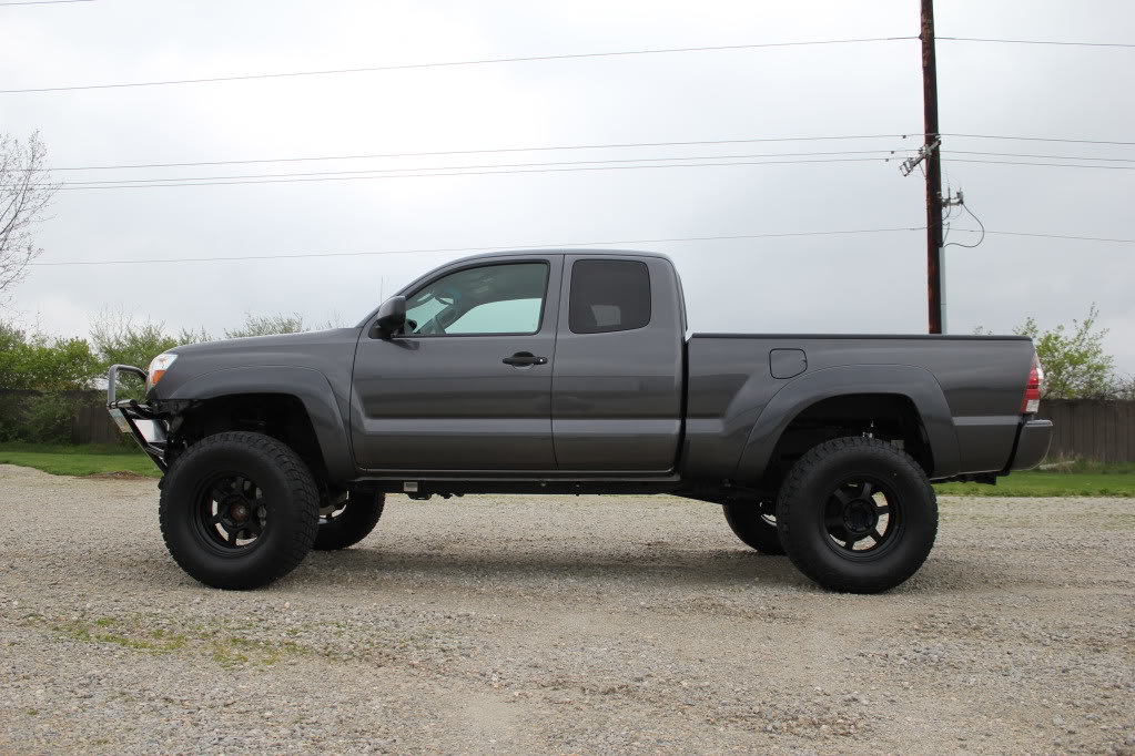

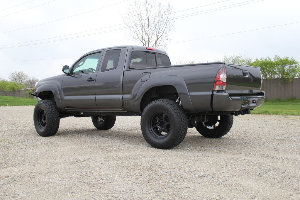

    Well, Let me start off by saying I know this thread is old but I thought it would be a cool idea to post up what I ended up doing since not to many people re-update these kinds of threads after they get their projects done!
    What I ended up with:
    -Camburg Spindles
    -Extended lines (front and rear)
    -Bilstien front shocks set at .85
    -All Pro Expo Pack
    -Rear Fox Shox
    -Timbren rear bump stops
    -Konig Countersteer X
    -295-70-17 Nitto Terra Grapplers
    -Rear Spidertrax 1.25 spacers
    I did the whole install by myself on my garage floor. Everything went pretty smooth, every snag I hit was expected since I had spoke with other members prior to installing. Overall I am super happy with everything (ride, look, look from other people (LOL)). I do have some vibs to work out, but then should be solid after that. Just plan to install a demello rear tube bumper and front fog lights then I'm done with the truck. Thanks for all your help guys!
    Photos for those of you who have this same setup planned for their truck
