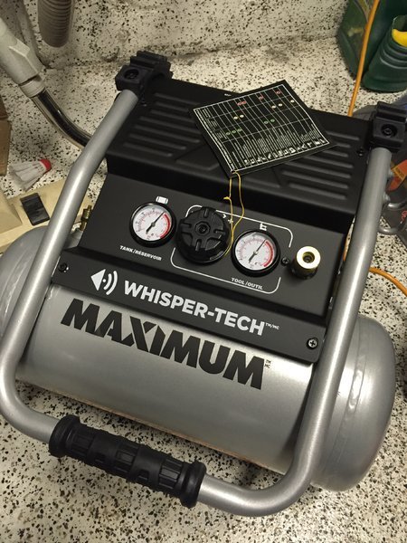

    image.jpg I have a 4gal Maximum air compressor that I would like to throw in the bed when I go wheeling. Question is can the bed outlet safely run this compressor in terms of wattage, amps and the stock wire gauge used for that outlet. Here are the specs on the compressor
