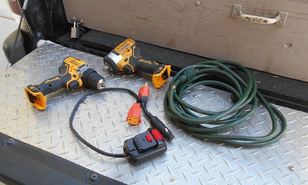

    I made this gadget to run some 12v battery powered tools off of truck power. The direct DC power cord beats an inverter for running similar tools off 120v AC. I even made the adapter to use common 120v extension cords.
    I rigged it to use the common 12/14 ga. cords "backwards" so tools couldn't be zapped by some dummy plugging a tool into real 120v power. I also keep close control of the 12v plug that adapts the male 120v plug. This isn't for everyone - requires someone thinking about what they are doing and doing it safely.
    My truck also has the factory inverter, and things like my 120v AC impact or a 1/2 chuck drill won't run off the 400w max delivery - but these 12v tools are happy. I use the AC for LED lighting strings.

    So you’re running 12 volt power tools off your truck via extension cord? Why not just buy a few more batteries and go cordless? That heavy cord has to be a pain to work with.

    "Why not just buy a few more batteries and go cordless?"
    In my life experience - the impact would have to have a "heavy cord" (air hose with compressor and receiver) or an expensive Dewalt battery and charger (of limited life and use). This set-up runs nice off the truck battery - puts lug nuts off and on with ease. Relatively inexpensive.

    Interesting option. Where did you get the ‘donor’ battery for your adapter? I was considering something similar, but with SAE 12v connectors.

    I had tried an el cheapo chinese "will fit" battery for the Dewalts and it died. Sacrificed for an adapter, gutted and rewired inside. Fitted with a 3 prong socket on a short lead. The male 12v plug is a Blue Sea item with a 10 amp fuse wired to a male 3 prong.
    The other project I've been eyeing - direct truck battery power for operating a Dewalt tool battery charger. Found myself charging tool batteries with the trucks AC inverter running a charger - and kept thinking this is flipping ridiculous. An EE friend told me I needed to be using something like a solar battery management device - set to stay above the low discharge threshold of the lithium battery pack (and just using the 13.5v off the truck as the feed).
