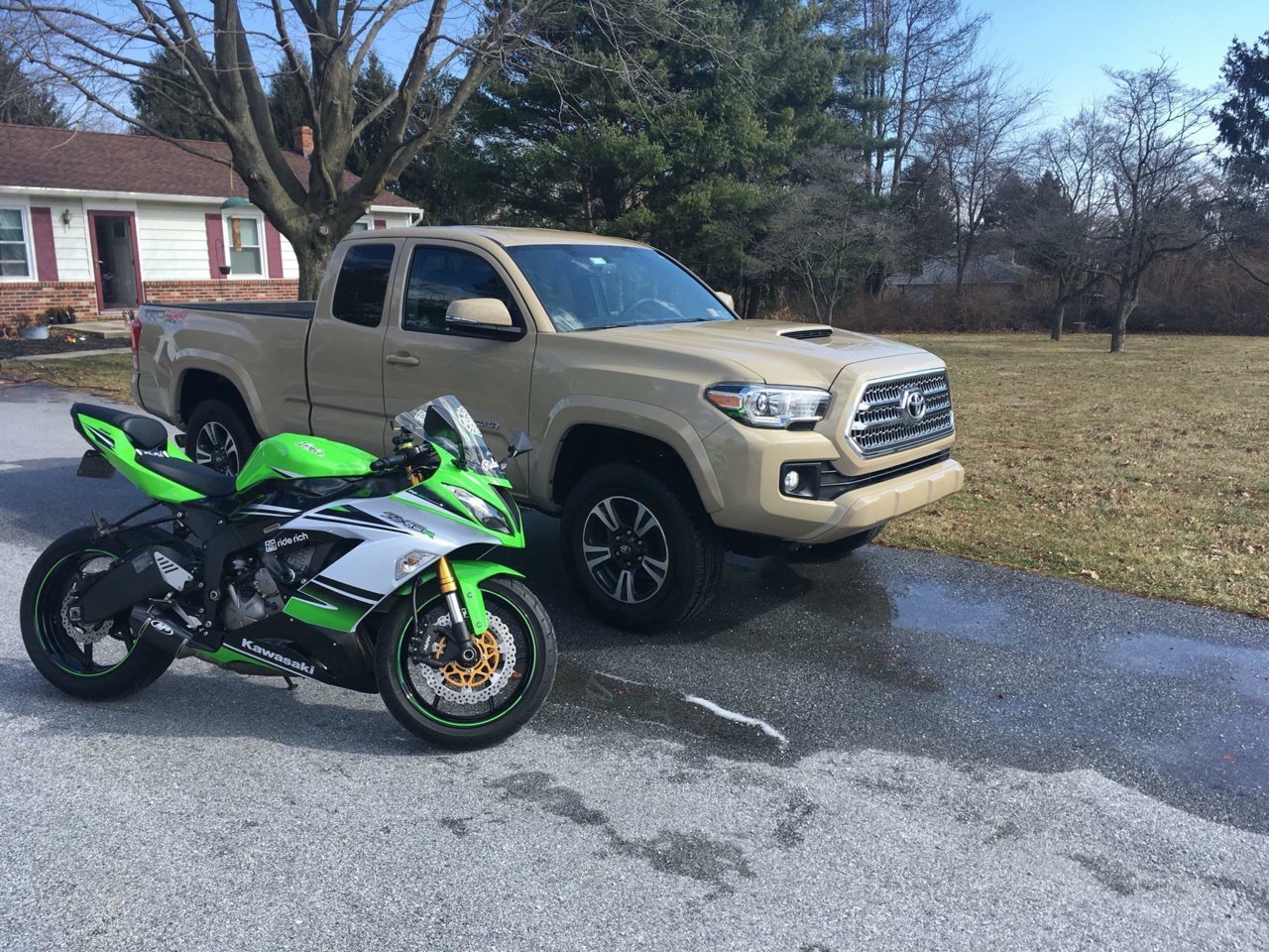

    Hey all i drive a 2017 Tacoma TRD Sport. I want to do new tires on my factory wheels I'm looking at the BF Goodrich All Terrain T/A KO2 (https://www.bfgoodrichtires.com/tire/bf-goodrich/all-terrain-t-a-ko2)
    I was wondering what tire i have to go with. I know i can go 265 70 R17 but at the end it has the numbers 112S or 121S I just wanted to know what that meant? Which one will fit on my truck? Thanks in advance! 29598380_1709878025714582_30051382842894_02e4d0918df1855460a2f8426c0a6ab4bdcbec0b.jpg

    The 112 and 121 are the respective load ratings of the tires. 112 is a C load range tire and 121 is E load range. This can also be interpreted as how many plies the tire has. More plies equals a stronger, more durable tire that can handle more weight (towing), but it also amounts to a much heavier tire that rides considerably rougher. Especially on lightweight trucks like ours. The D and E range tires are really meant for the bigger trucks. I personally have C load range tires (112) and would recommend them if you are at all concerned with ride comfort and unsprung weight.

    Get the 112 .
    E rated 121 load is major overkill for our trucks.

    Why won’t they make a C load 275.... the C load 285 is a lot lighter than the 275...
    Yes go C load range 265, less power loss and better mileage than the E rated tire. Unless you either tow a lot or Offroad enough to need the heavier tire. 112/109S C RWL

    Okay thanks i'll go with the 112!
