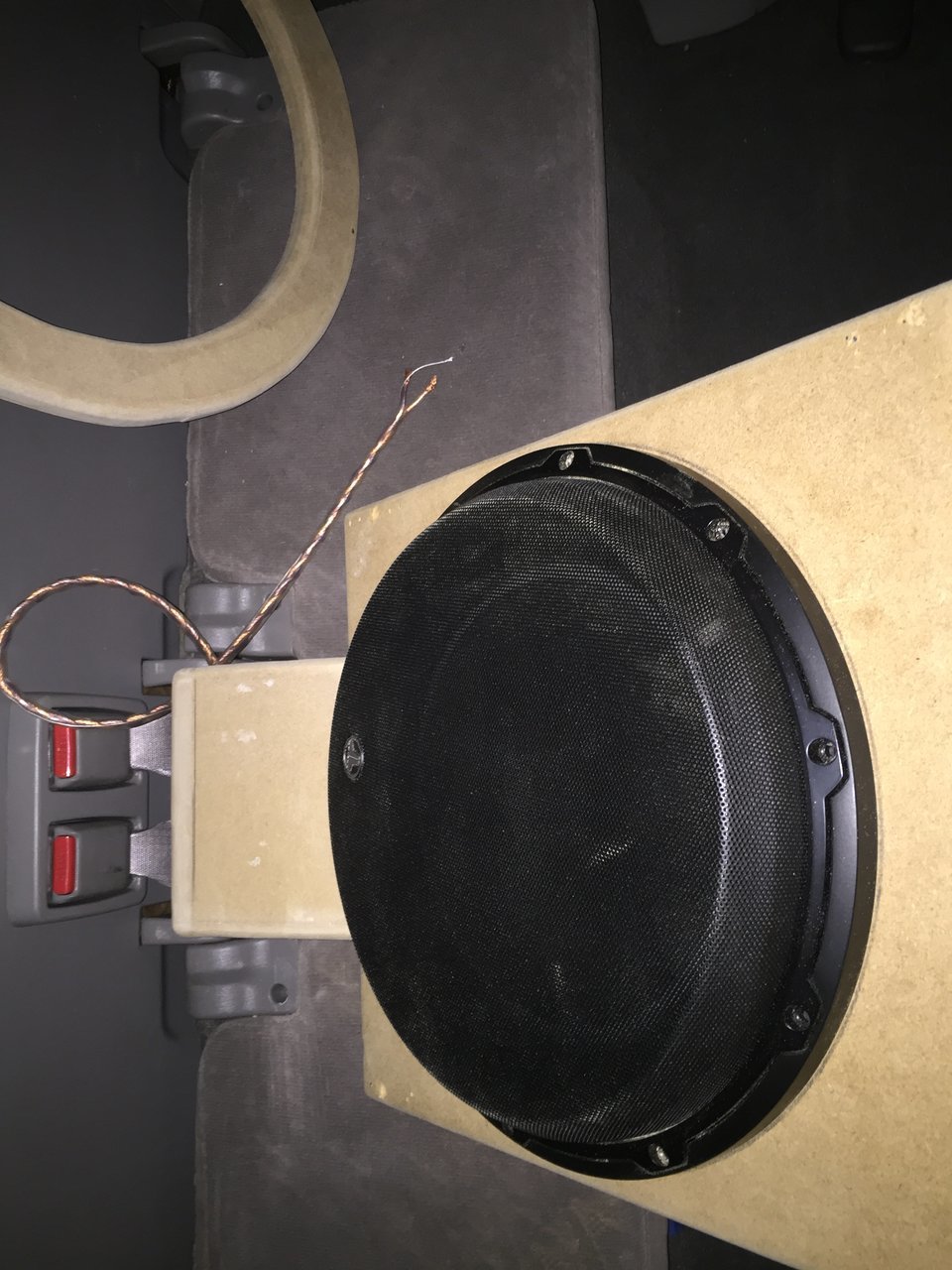

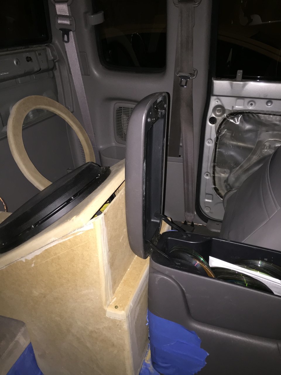

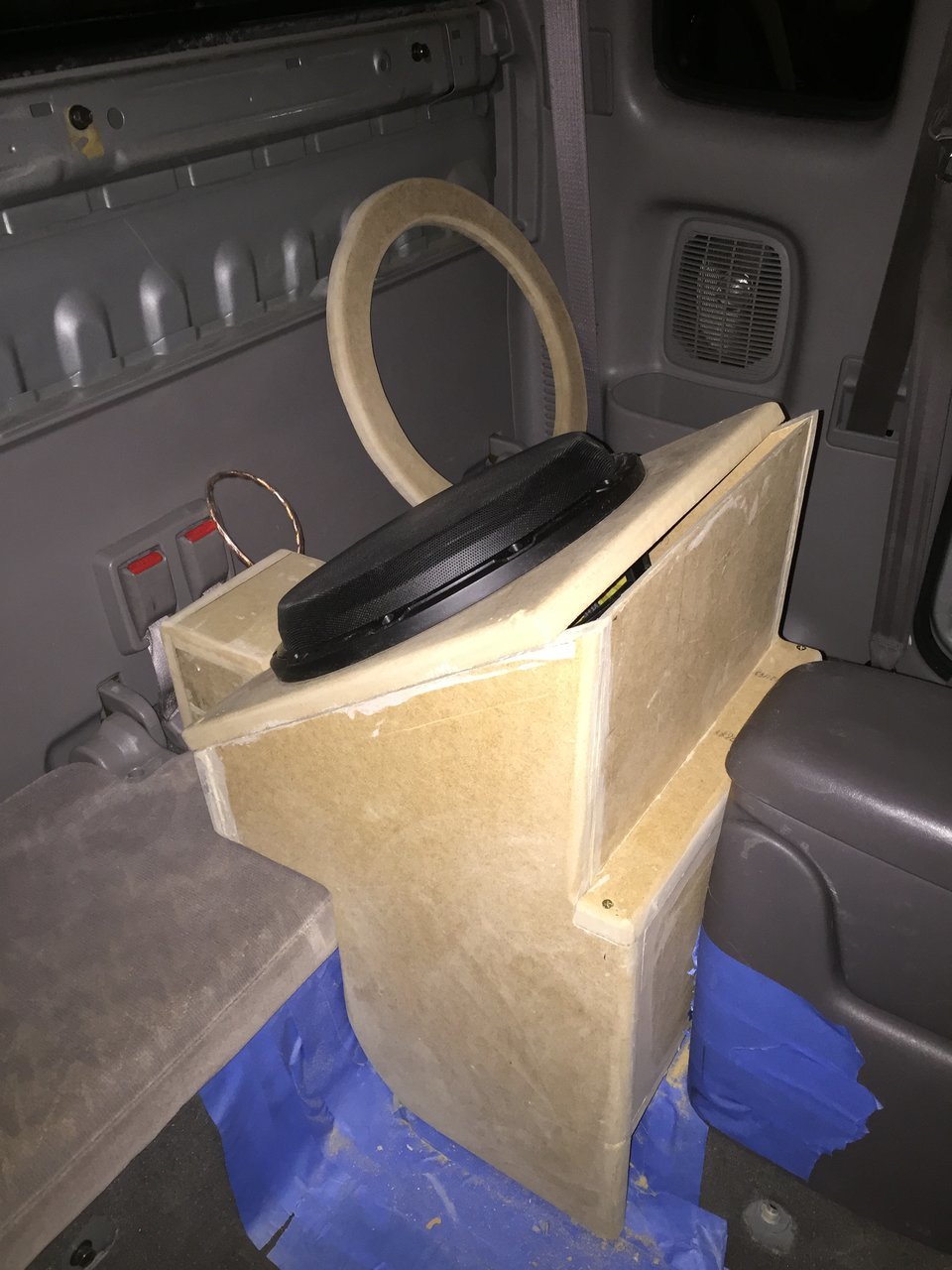

    I am still in the process of completing, but I thought I would share.
    While you lose some abilities with this design, keep in mind that this is a 12” Subwoofer (1 cubic ft internal)
    The same could be done with a 10” an you would not lose as many functions as I did.
    Lost functions:
    Hidden console compartment
    Access to storage under jumpseats.
    More pics to follow after carpet

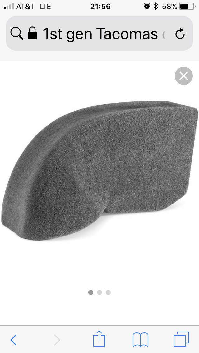

    Yeah, if I could do it over again I would go with the 10 inch sub. However I am not sure how impressed I am with JL audio’s stealth box. I got the inspiration for this box from YouTube . https://youtu.be/nDkfuTixdpY However after taking on the project I realized he used a 10 inch sub, not a 12 inch like mine.
    I will post more pics when it is done, It may sway your mind . The Stealth box will require some fiberglass. This Is what made me change my mind and go with this one.
    If you are going with fiberglass you may want to consider the one above

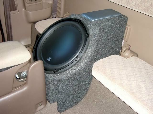

    My old setup. JL Audio 12W3V3 in a sealed box built by Justin Leathers of Just-Install in Chico, CA. He borrowed my truck for a few weekends to build a few boxes and gave me one for free for using my truck. Don't ask me for measurements as I don't have them. Same guy that built 1999 Tacoma box video posted above built mine:

    Super clean looks factory!

    Very nice! Thanks for sharing!
    Hoping mine looks as presentable after carpet. The little arm rest to a nice touch as well.
    Two questions:
    Were the seatbelts still functional?
    What’s up with that bolt on the back of the console? Is that a modification?
    Not sure this would work for my W6, but I’m definitely going to check the specs on the W3 to see.

    Were the seatbelts still functional? Yes you can still pop the rear seat belt from the holder behind the sub.
    What’s up with that bolt on the back of the console? Is that a modification? The arm rest touched the cone on the woofer so brackets was made to push it forward. I lost a the rear cup holder because the arm rest was pushed forward. The box was the bare minimum specs for a 12W3 air space wise so we have to toss some poly fill in it. It sounded great for what it was. But coming from a slot ported 12W7 with 1000/1 Slash amp it just wasn't enough for me. So I have since switched to (2) 13.5TW5's with HD750/1 with HD600/4 running (4) 6.5" JL Audio ZR components with another set of XR tweeters (6 total in my cab).
