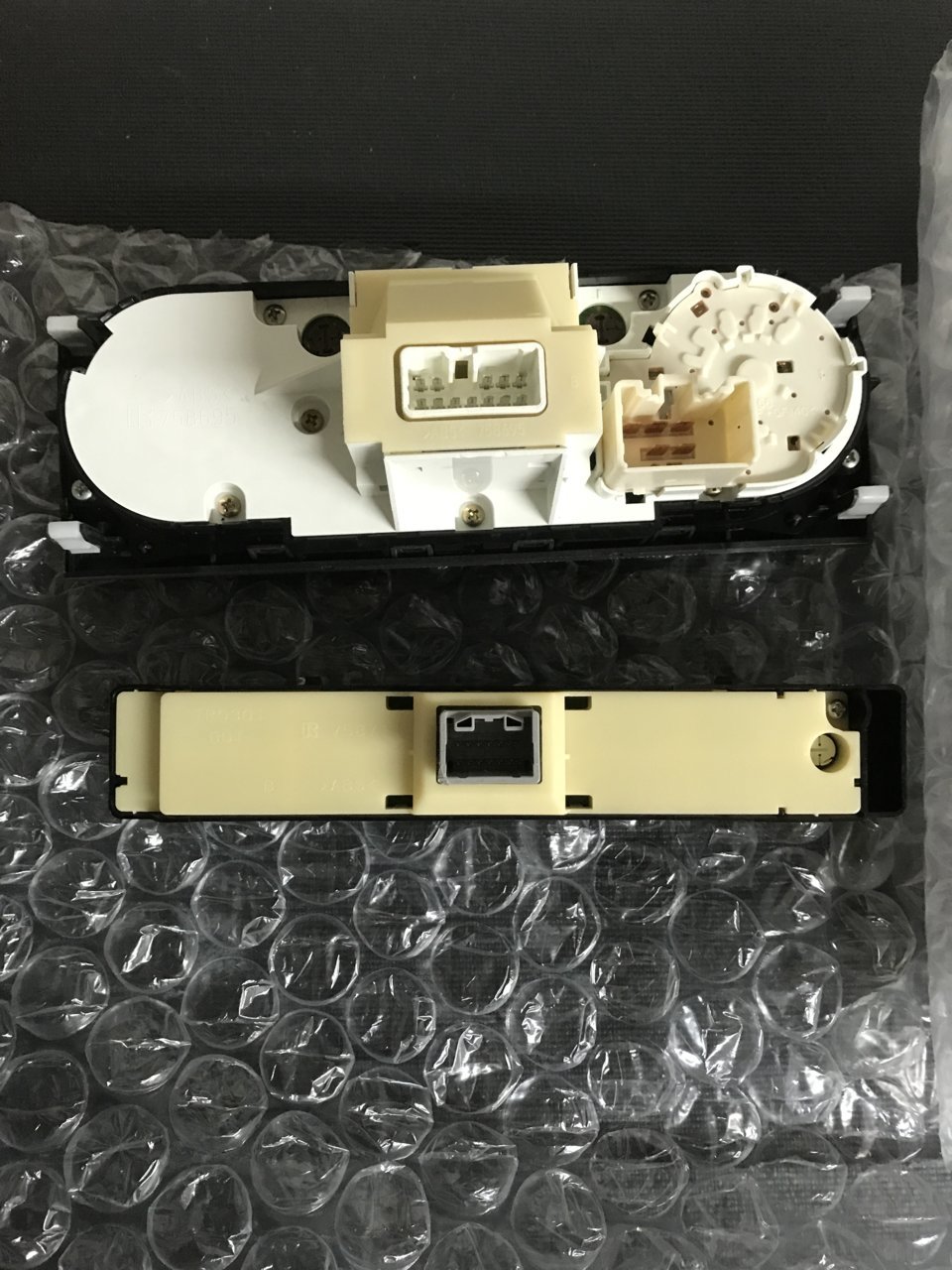

    Negative. With the harness its plug and play. The units from 05-11 have different plugs than the 12-15 on the back of the units.

    I got mine from @05Taco4x4. I had the issue of the ac not turning off. I had @Jerez move a wire to a different spot on the harness and works fine now. The 12-15 units have the white lights already in them. Check eBay you can get a unit for $75-85.
    Keep in mind the harness will be slightly different in a 05-07 than the 08-11.

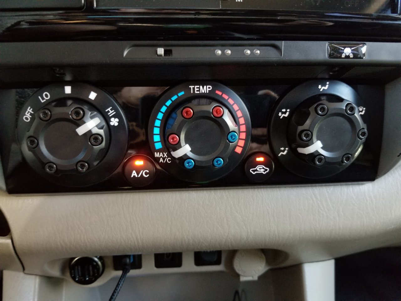

    Yep I know. I’m just curious if I can install my grey teuxture faceplate on the newer unit? I know it’s removable, and they’re on visually the same sizes. But I don’t want to swap everything else to black. Honestly just hate the orange LEDs lol. Swapped everything to white years ago

    Ok so the faceplates will swap but the screw holes are different. So you will have to use adhesive or 2way tape to accomplish that.

    It should pop on but like I said there are I think 4 little screws that secure it to the unit.

    You can see the screws next to the clips.

    Anyone have issues with the A/C button staying on even when heat is on. I tried pressing it off like I did before I made the swap but it stayed on. It only shuts off if the blower is turned off.

    Is your diverter selector knob set to defrost position? I can't remember if that lights up the AC light or just turns the AC on but leaves the light on the switch off.

    It is not. The A/C light is on regardless the position of the selector knob.

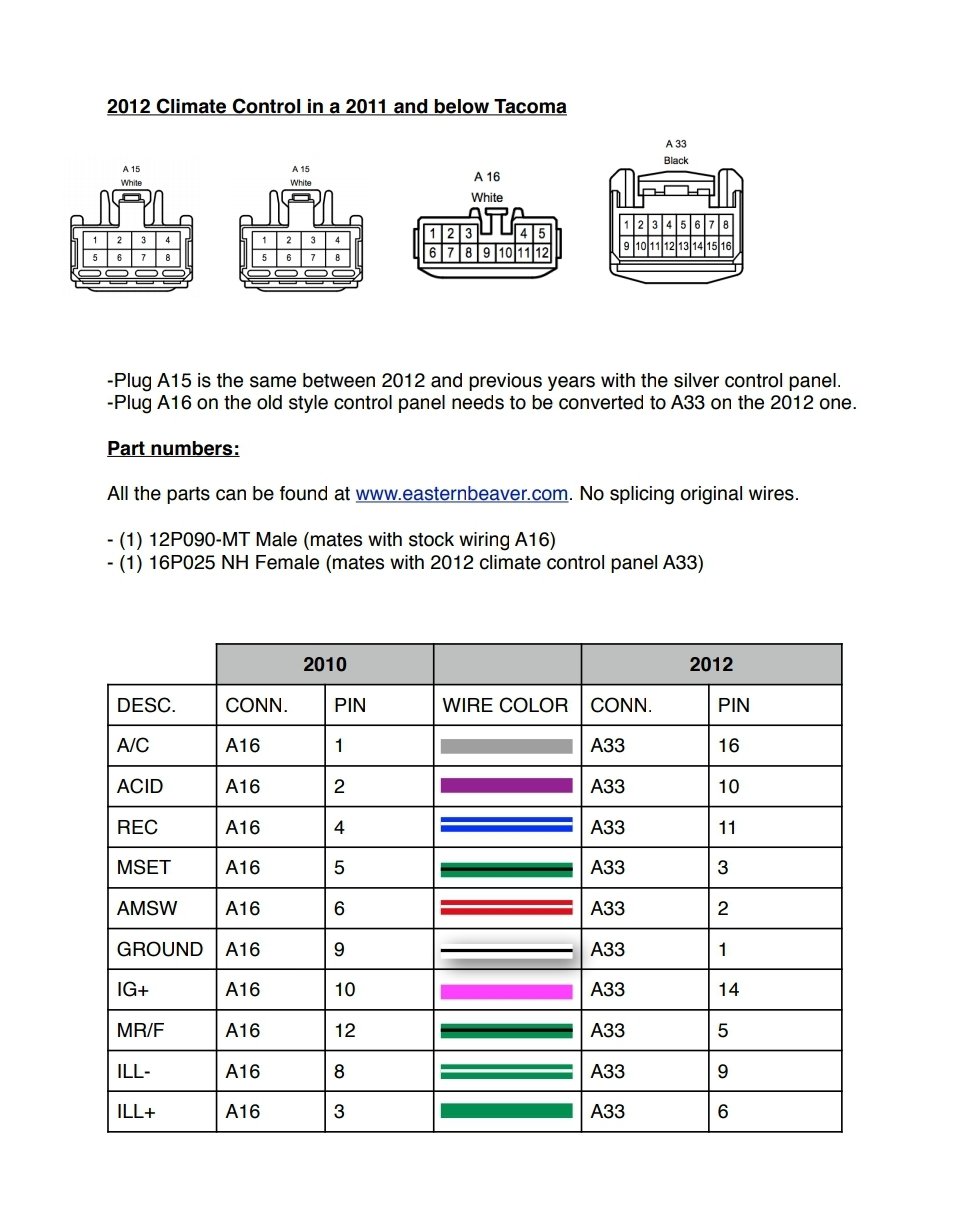

    I got a buddie wanting to switch his 11 to 12-15 controls! Anyone know where he can get a harness?

    You have to piece it together. The plugs can be found at https://www.easternbeaver.com/Screenshot_20200825-184941_Drive.jpg
    Way worth the trouble though :thumbsup:
