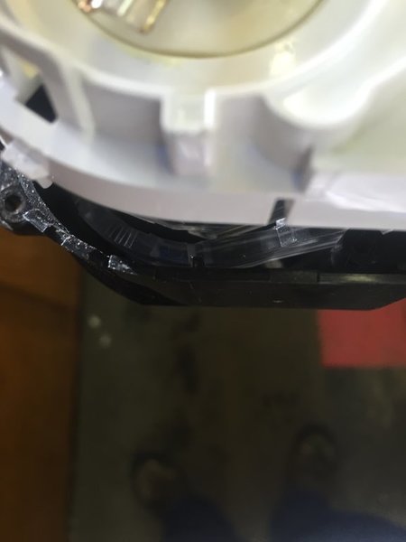

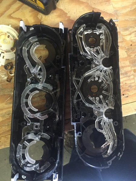

    I did this. See my above post. Almost everything is the same but the light tunnels in the 05-11 models are different than the 12-15 models. I made them work with some cutting, but then the LEDs don't line up right with the light tunnels. I ended up having to add in 5 Amber LEDs and wire them to the shifter light and place them carefully where the 12-15 LEDs would be. It can be done but it's a PIA.

    For the record, this doesn't work without cutting plastic. The light tunnels and lighting do not line up.

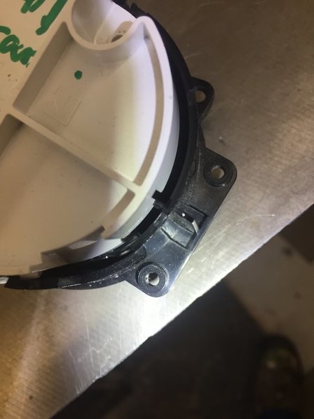

    And you are right. It's like toyota wanted to bring your hopes up looking at it and going ohhh this might work and then they just shift the little things over a 1/8 inch so it doesn't :bananadead:image.jpgimage.jpg image.jpg:frusty:
