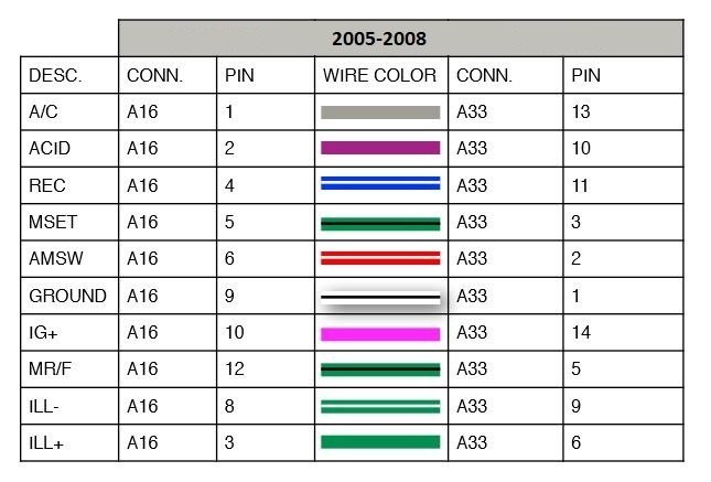

    You might have them backwards, the picture is as if you were looking at the plug its self and not the side that you would put the wires through.

    Man I wish it was that easy. All of my wires are nice and tight. And I recall, the one you're talking about is moving the wire that goes in 16 on the diagram to 13 on models 08 and before and I made sure to do that. I also confirmed the wire placements by looking at the circuit board where you can see the circuits running from the plug. I'm baffled at this point not sure what it could be. The ac and heater work fine it's just stuck on the foot/defrost vent and the fresh/recycled air button doesn't work properly

    I figured it out finally! I found a complete wiring diagram online and figured out I had two wires swapped. In your pdf that shows which wires go where, the MSET LG-B wire looks like the same color as the MR/F G-B wire. I just thought one looked a little darker on your pdf and I was wrong. So I swapped those two wires and VIOLA! In other words I had the G-B wire in the 3 slot and the LG-B wire in the 5 slot. I just had to do a simple swap. Something that was driving me nuts was so simple! HA!:bananadance: For what its worth thanks for your write up and trying to help me trouble shoot. I'm stoked on the new colors with the amber all gone! My next mission is trying to find what type of LED is used for the a/c and recycle air buttons so I can switch them from amber to blue!

    I’m confused on which wire I should put in for the mset or the mr/f one is lighter then the other

    Just wanted to says thanks Jake for the information you provided on this thread! I finally got my swap done last night and had the AC button issue. Swapped my wire from pin 16 to 13 and all is good!

    I'll be going from a 05 to 12-15, so I'll make sure to jump pin 1 to 13, vice 16.

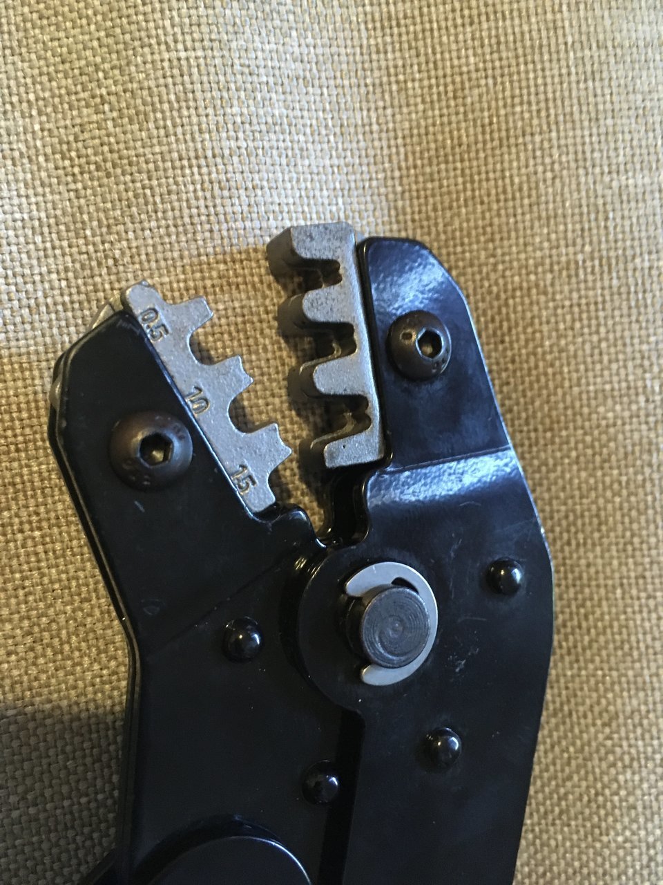

    This is the proper tool
