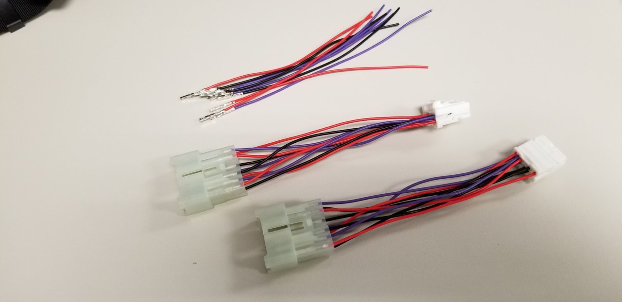

    Mine works great just the ac button light stays on is all. When I turn to heat still gets super hot

    Your pin 13/16 is backwards

    Same here! Recirc works but AC does not. Did you ever get this worked out?
    Note, I haven't done the polarity switch yet, just plugged everything in with the harness that @svonavja sold me.
    Not sure why the polarity switch is necessary to activate AC. Before I could turn it on with the temp set all the way to hot

    Just did the polarity switch, tested and confirmed with an Ohm Meter that I fully cut the old connection and also confirmed the newly soldered ones are good. Still no AC. @svonavja whats up with the harness you sold me? Can you please post or message me the diagram so I can confirm the pinout is correct??

    My problem is the ac light always stays on now even with heat
    Need to figure out the polarity switch for sure also

    I have a 07 so yours will be different from mine where I have the opposite problem.
    FYI, the AC doesn't automatically turn off just because you turn the dial to heat

    FIXED IT!!!
    For what it's worth I found the diagram online somewhere and the guy who made the harness had the one pin wrong. At least for my 07 truck. Switched the grey wire from pin 16 to pin 13 and now AC toggles on and off as it should.
    You might have to do the opposite.
    Can you take a picture of your connection and upload it here for me so I can try and help you?

    The attachment is what my harnesses are built on. All of this information was gathered from multiple sources and inputs. Hope this helps. Also switching pins is easy...attached a poor but simple instruction for anyone needing it. Thanks @
    hx989 for the information!!
