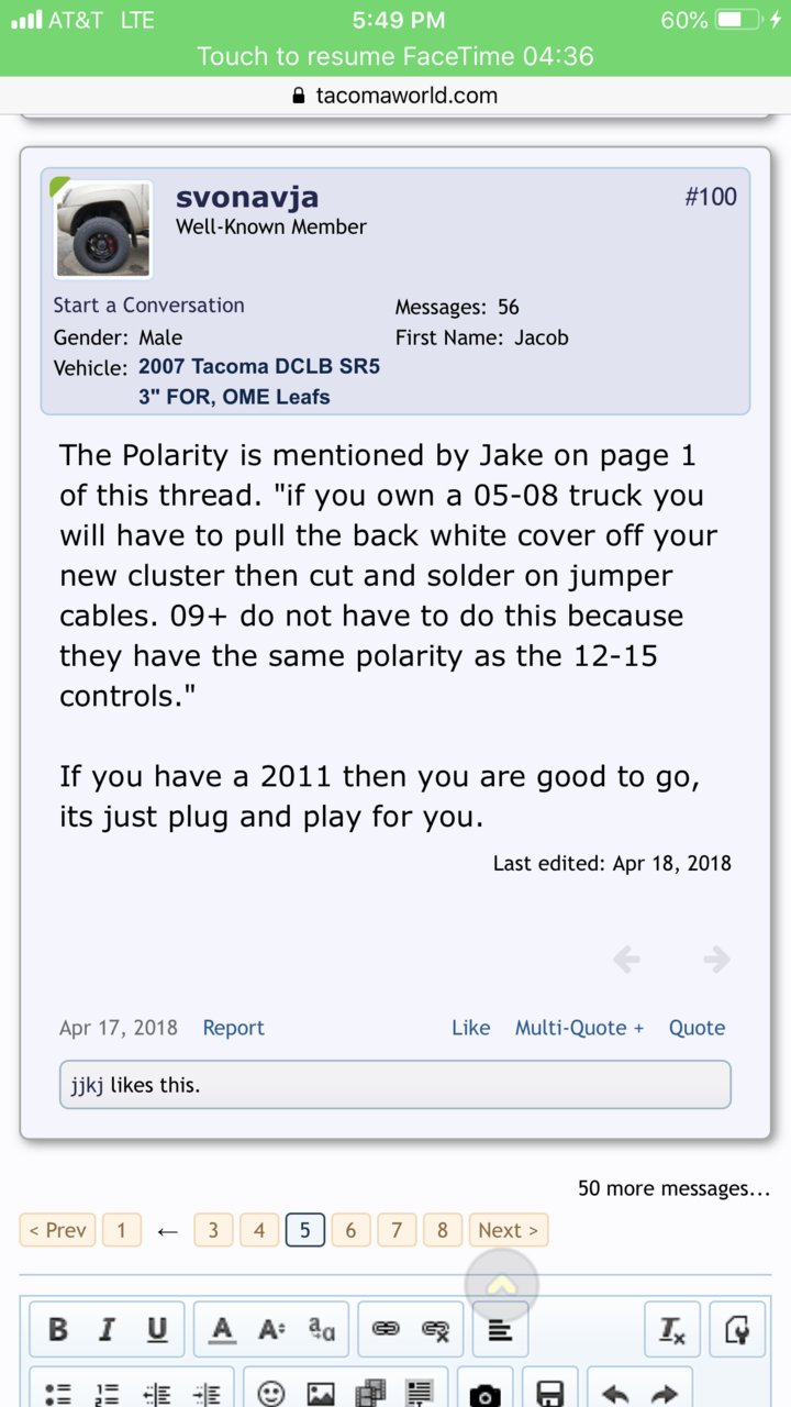

    so before i buy... is ANY modification needed for my 2010? first page said 05-08 needs to do that soldering but 09+ doesn’t. just want to know before i buy a climate control

    I don't think that information is correct, I think anyone who needs this harness will need toad the controls.

    based on what you said back last year you said it’s plug and play

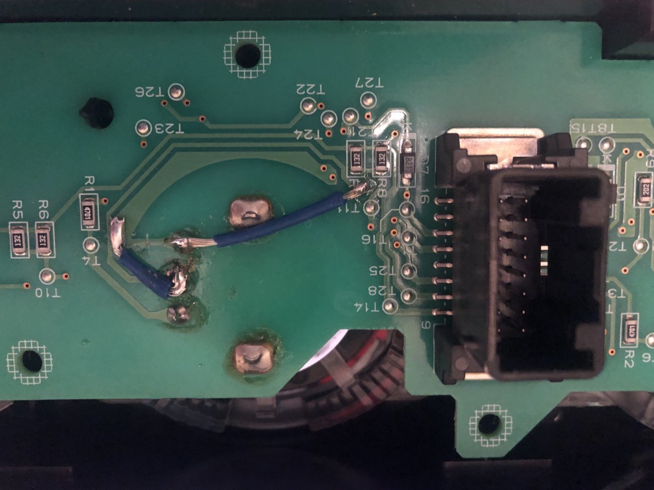

    Just wanted to add my experience to this thread. I retrofitted an '12 panel into my '07 Taco. I purchased a harness from Svonavja and I believe the whole pin 13 & 16 thing was fine the way he wired my harness and looks to me that the wire in question was in pin 13 on my harness. Any way, I modified the board according to the write up in the beginning of this thread. Used a exacto and put a deep fine cut on the board and soldered very thin gauge wire, used my voltmeter to verify solder points and everything reassembled no problem. All dials and buttons work. Only thing is when I set the temperature dial to "Max AC" the AC doesn't activate on its own. I have to manually turn on and off the AC. This doesn't bother me one bit as the AC is always running in my Taco (I prefer the dehumidified air). Other than that, I soldered the wires to the pin hole pass through connections on the board rather than sanding down a lead. Refer to these attached photo to get an idea of what I did. So happy to be rid of the amber lights. The only car that should have amber lights is a BMW.
