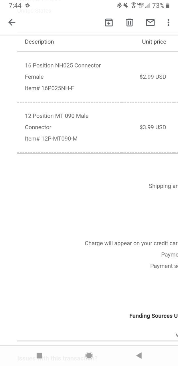

    @svonavja can you tell me which male connector i need to make the plug and play harness so i can always go back to stock if i need to. i know i need the female 16P025 NH plug but whats the male in the early models?
    svonavja likes this.
  4. Apr 29, 2019 at 4:45 PM
    #164
    svonavja
    svonavja Well-Known Member
    Jul 22, 2016
    #192593
    72
    Jacob
    2007 Tacoma DCLB SR5 3" FOR, OME Leafs
    Just purchased, Stock, Swiss Cap
    Here you go.
