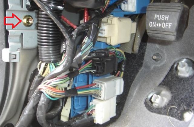

    How did you test the juice at the door wires from 1B?
  18. Jan 9, 2022 at 3:02 PM
    #38
    caribe makaira
    caribe makaira Well-Known Member
    Feb 13, 2011
    #51121
    11,782
    Caribbean, Puerto Rico
    05 PreRunner TRD Offroad AutoTrans
    Hood Struts, My version Fogs always ON, Map & Overhead Light Mod,
    Also, run a wire from the ground bolt you chose at the door to an interior bolt like this one:
    nudavinci64 likes this.

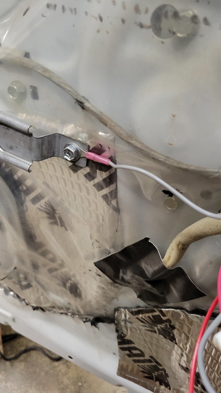

    The bolt you selected for ground has a plastic nut behind it, as in it makes no ground.
  20. Jan 9, 2022 at 3:59 PM
    #40
    20somethingwidataco
    20somethingwidataco [OP] Yes, my avatar is a real car.
    Nov 11, 2017
    #235681
    6,420
    Will
    Washington State
    2008 AC TRD SPORT M/T
    ACLB 6 SPEED: Suspension: Bilstein 6112s (3rd perch) (F) Taco Lean Spacer Bilstein 5160s (R) TSB Leaf Pack Wheelers Offroad 3 leaf progressive AAL Wheelers Superbump Front Duro Bump U bolt flip kit Duro Bump progressive bump stop 3rd gen TRD offroad sway bar Wheels and Tires: Summit Racing Wheel Dakars (Polished Silver) 285/70r/17 Goodyear Wrangler Duratrax (Load D) "Performance": AFE CAI with custom powdercoated white filter cover MagnaFlow Performance Series Exhaust URD Cam gears XTP Intake Manifold Spacer OTT Torque Tune Brakes: Stoptech Slotted Rotors Stoptech Sport Ultra Composite Brake Pads Wheelers offroad SS brakelines (Front) Interior: Kenwood DD headunit Oem Subaru Kicker Tweeters Alpine 6x9 (Front) & 6.5 (rear) (With Taco tunes speaker mounts) Alpine 500 watt amp Sound Deadening (Doors, Rear "wall", Roof) ODI Rouge Shift Knob Weather Tech Mats Painted/wrapped trim pieces Console Safe Console Vault Gridx Organizer Ram Phone Mount Meso Customs dual color map lights Meso Customs dual color dome light Wet Okole seat covers (Black) Wet Okole center console cover (Black) 1" Seat Raisers (Driver & Passenger) AJT Designs climate control and 4x4 knobs Back Up Camera Lighting: Retrofits (Mini H1's, RGB Halos, 5500k Bulbs)(Lenses wrapped in self healing PPF) Diode Dynamics SS3 Max SAE (Yellow) Diode Dynamics SS5 Pro (Yellow) Driving lights (ditch lights) Anytime fog mod Rigid Industries E series 32" Combo bar (spot/flood) Diode Dynamics XPR Reverse Lights Diode Dynamics XP80 turn signals LED brake, parking lights and license plate lights Armor: Apex All Pro sliders BPF steel skid plate Bigass Trailer Hitch Camping/Storage: Leer canopy LED interior lighting Sleeping platform (Storage underneath) Removable snowboard Yakima mounts Extra D rings in bed (6 total) Custom Powder coated white snow shovel with custom bedrail mounts Amazon special Traction Boards Hi Lift 48" Jack with custom Rail mounts to accommodate my sleeper set up Other: All pro Bed Stiffeners Relentless Fab tailgate panel TRD sport graphics (Turd Gen spec) Anti Sun glare hood scoop wrap (Satin Black) Custom FleeBay grille 4 Hella supertones ECGS needle bearing Many Patches BPF shackle mount (With smittybuilt shackle) Tinted windows (Front/Rear + Full canopy)(18%) Meso Customs gasshole AVS inchannel window visors Diff Breather Kit 2012-2015 Oem Turn signal/folding mirrors (w/ sequential signals) 2012-2015 Oem LED taillights Full Size (285/70r17) spare DIY Larger Engine Splash Guards DIY Vipercut TRD radiator cap
    Multimeter. Both wires had power to them *both power wires) but ya, no signal. I'll try and run a different ground next time so it is actually grounded properly and try it again.
